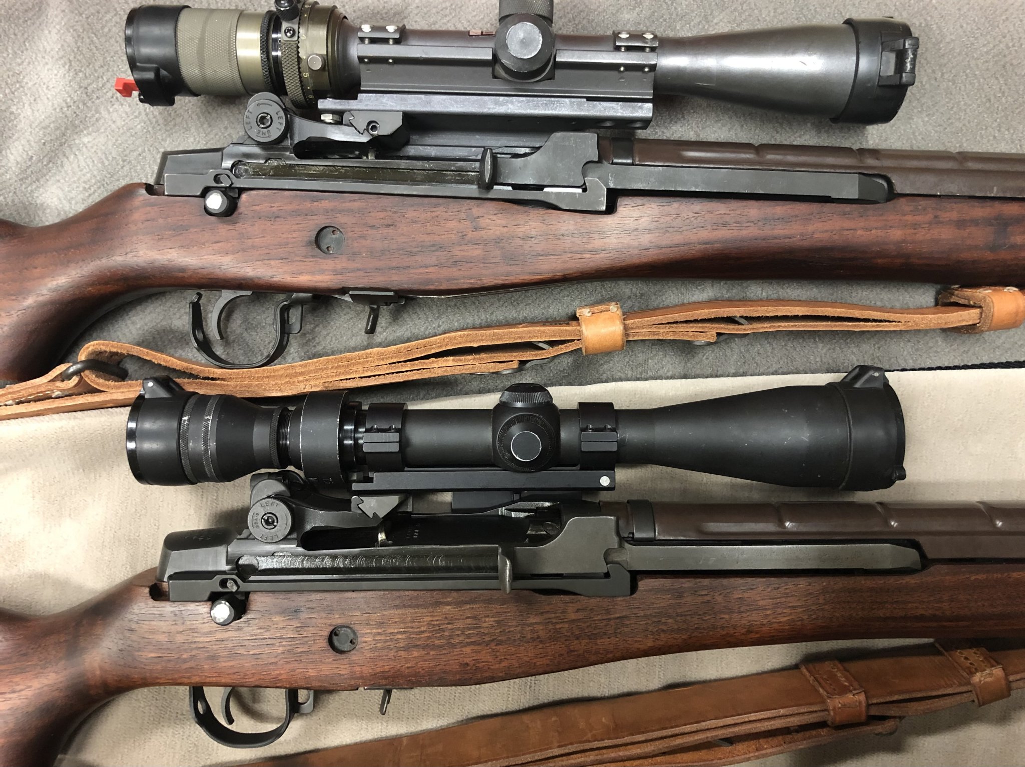

….Nice, congrats on getting that rifle. It looks nice. One nit pick in defense of the M21 service history, the Vietnam era scopes were called “AR-TELs” and were made in 1969. They lacked a separate adjustment for magnification and range, it was combined. The ART II scope fixed that issue with two independent rings that separately controlled magnification and range. The ART II also had a better scope mount that used two attachment points. The first 1275 ART II scopes were delivered to the U.S. Army in December 1980, and went into service in 1981. So ART II scopes are not Vietnam era scopes, as the US ended its involvement in Vietnam in 1975. Just a minor correction regarding the historical record.
Attached picture shows the 1980s era ART II at top - versus the 1969 era AR-TEL on bottom:
Thanks for the information and correction.
