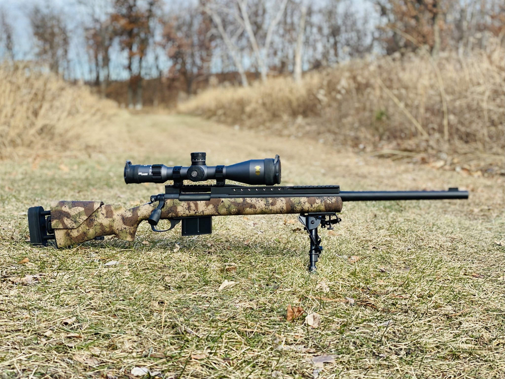

Debating from either 2006-2010 or possibly a late build to match when the rifle was built.

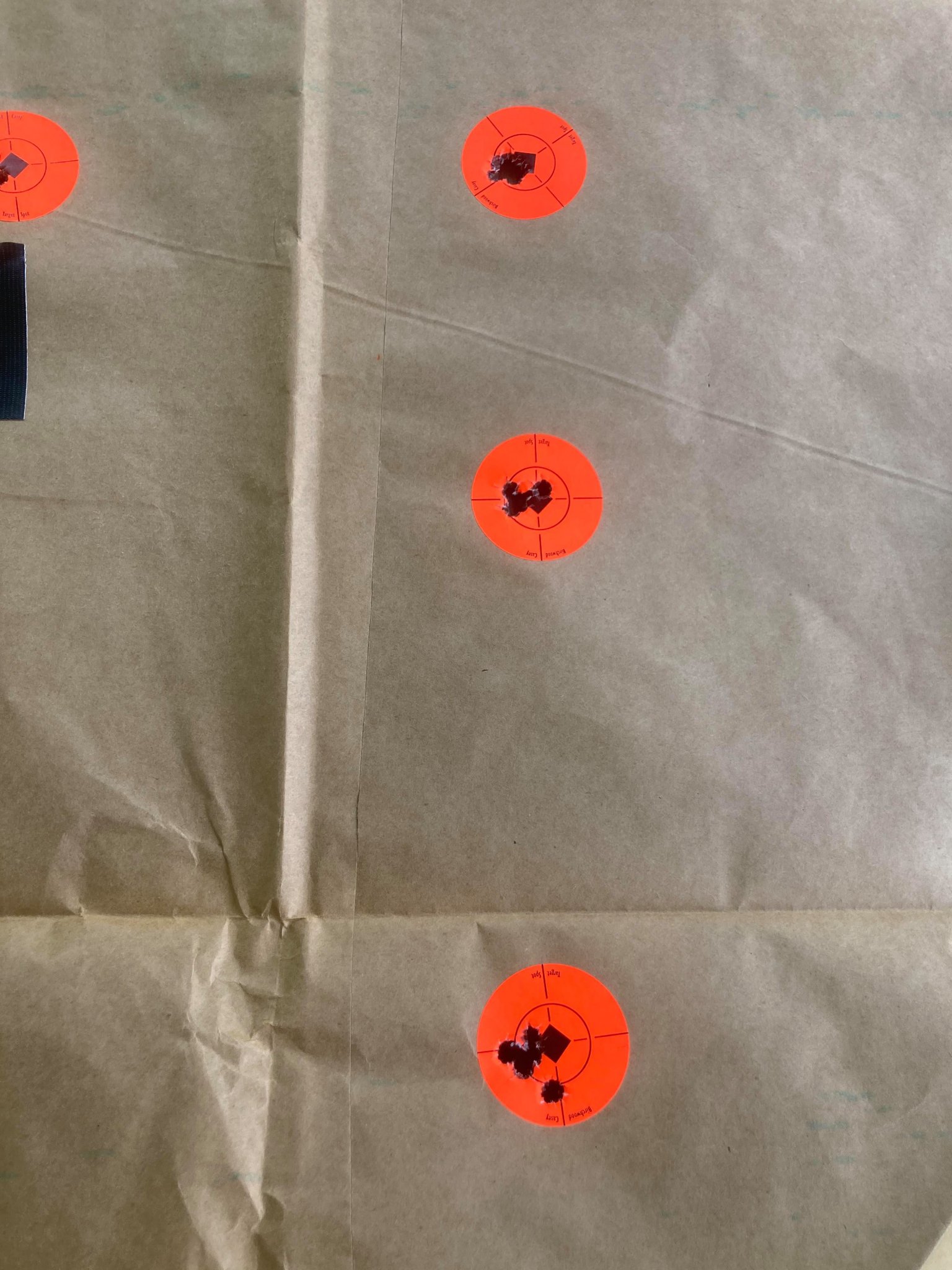

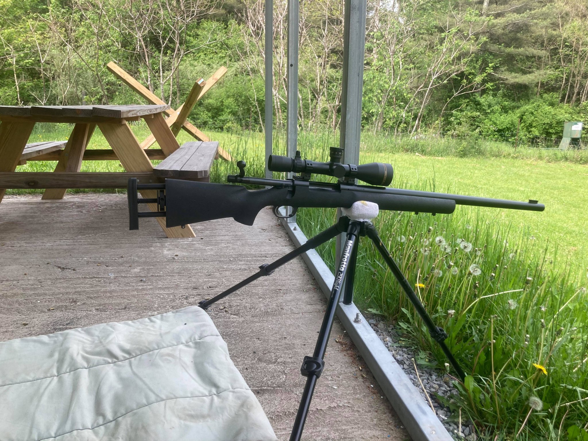

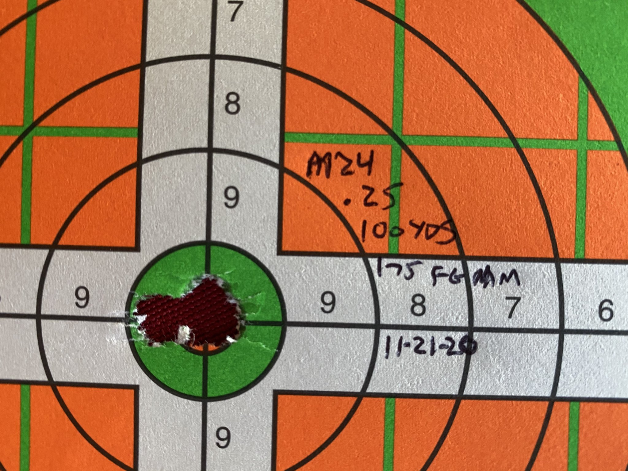

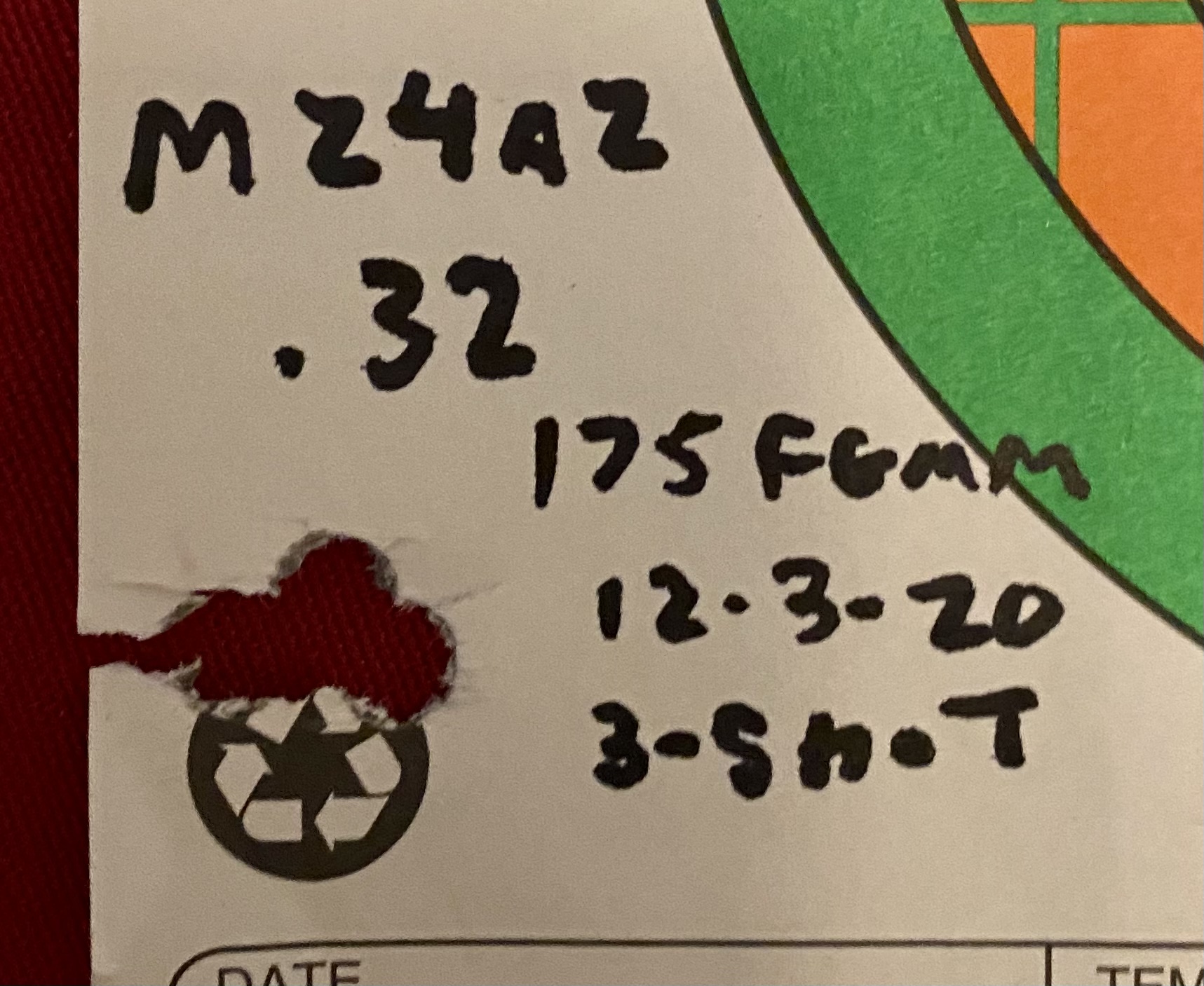

Took it out and tried it. Very impressed with the groups I was getting from the bench, shot steel afterwords.

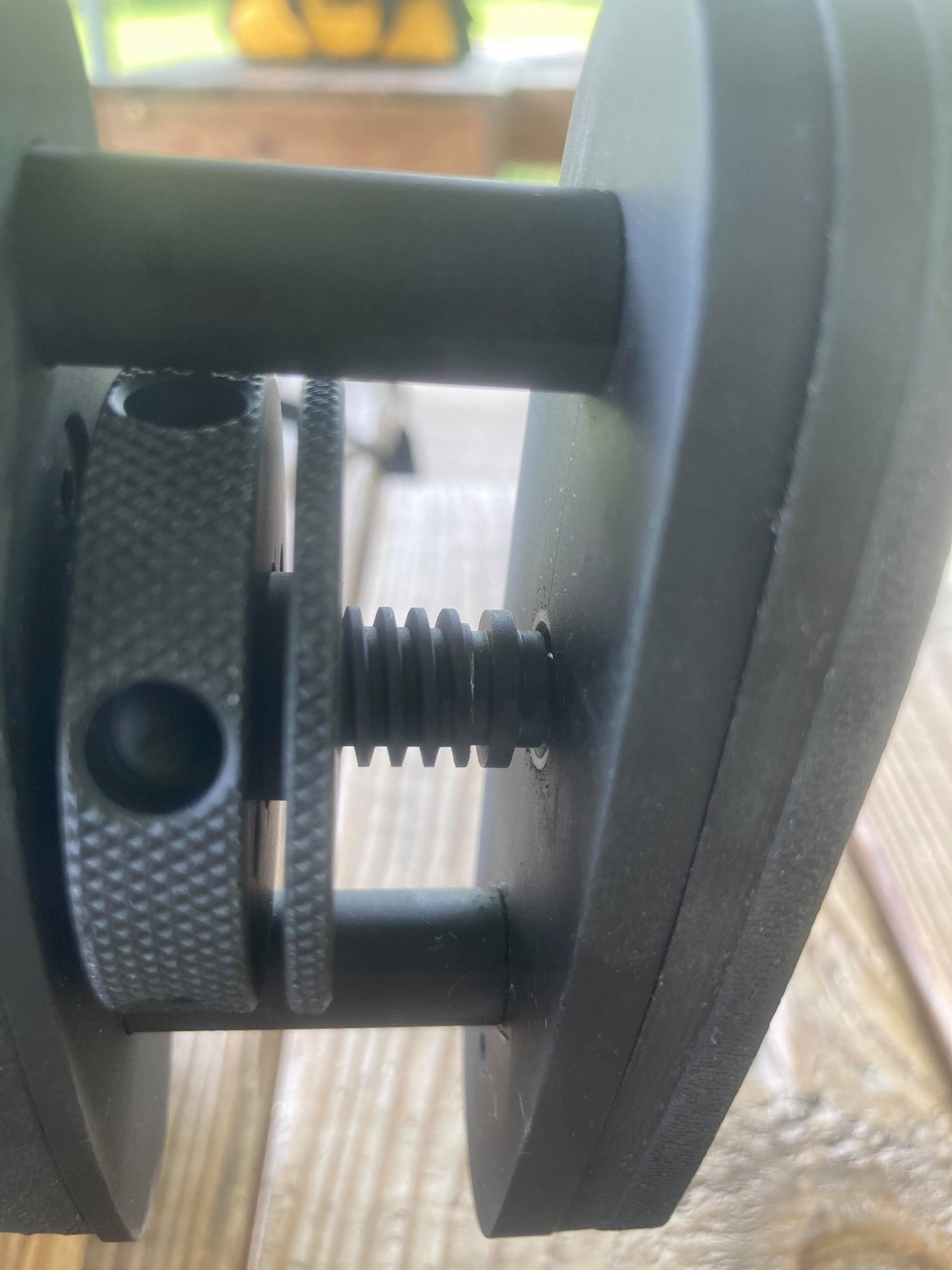

I noticed the buttpad adjustment system needs some work. I thought it was stripped, but I noticed that the screw with the wheels on it can freely turn. I just need to pull the pad off and tighten what ever holds it in place right?.

Last question for a while then to building... I am wanting to build the rifle in a late model 2006-2010. Are these components correct?
* Leupold Mk 4 steel rings medium height
* Harris swivel 9-13in bipod. Smooth legs/friction lock
* Leupold Mk4 3-10
* Leupold Mk 4 2 piece base (Currently owned)
*m1907 sling (Currently owned)

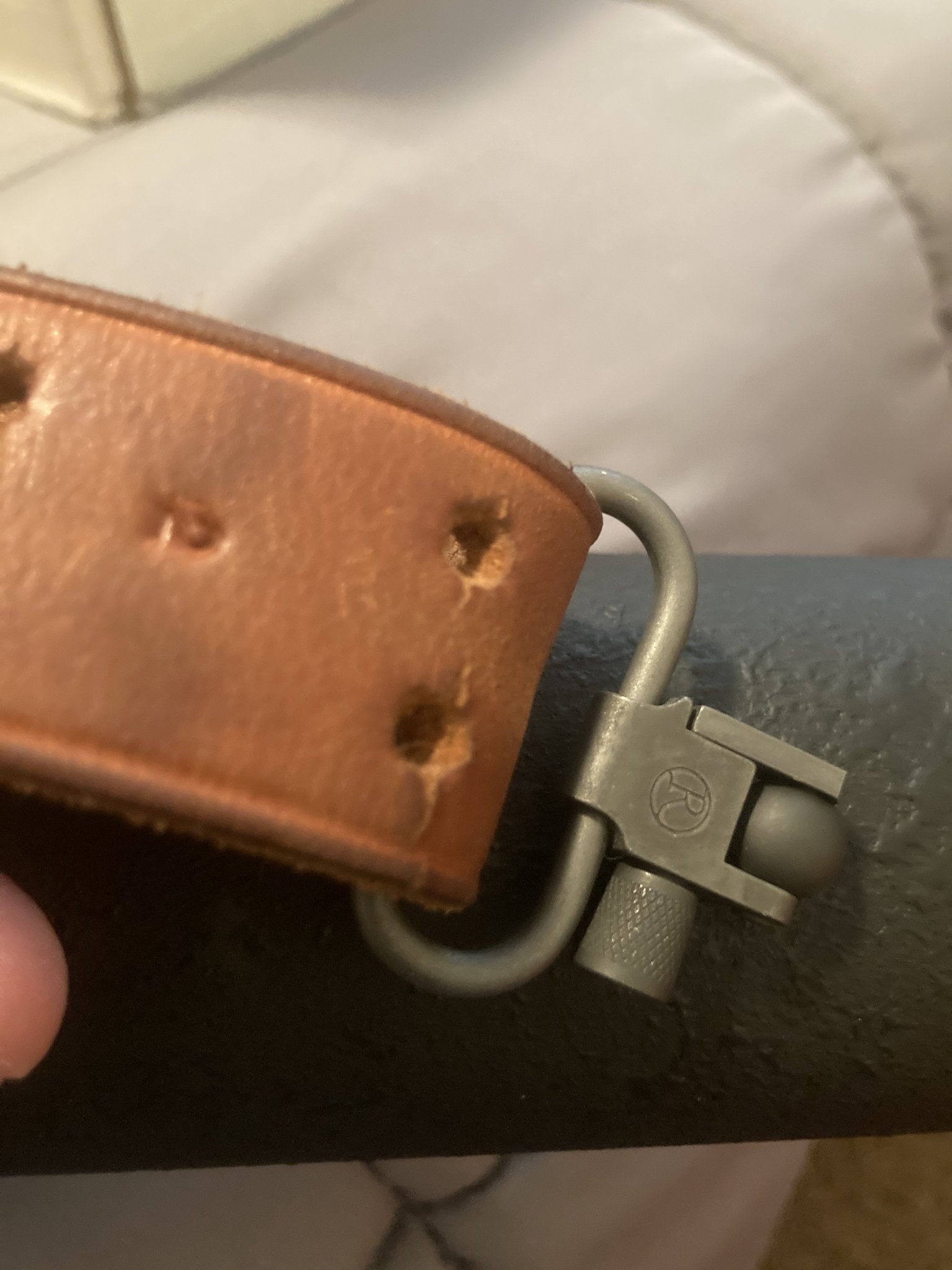

Also are these sling swivels correct?
Reactions: lockedandloaded
Oh, well that makes things a lot better lol, so its basically all correct as far as the rifle goes. So now to save up for a mark 4 and some rings. Probably kill the value but I think I will take it out for rifle season lol

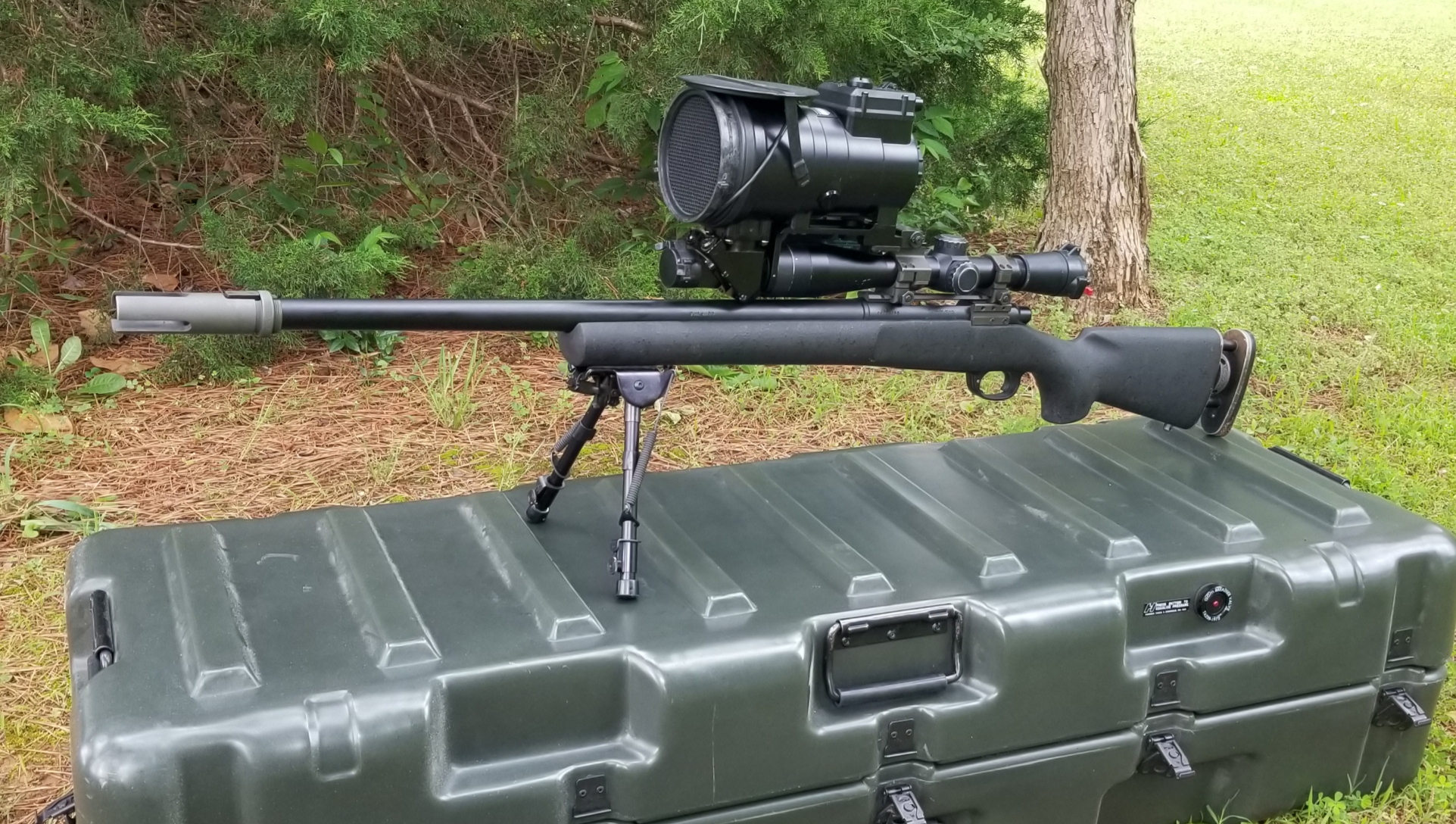

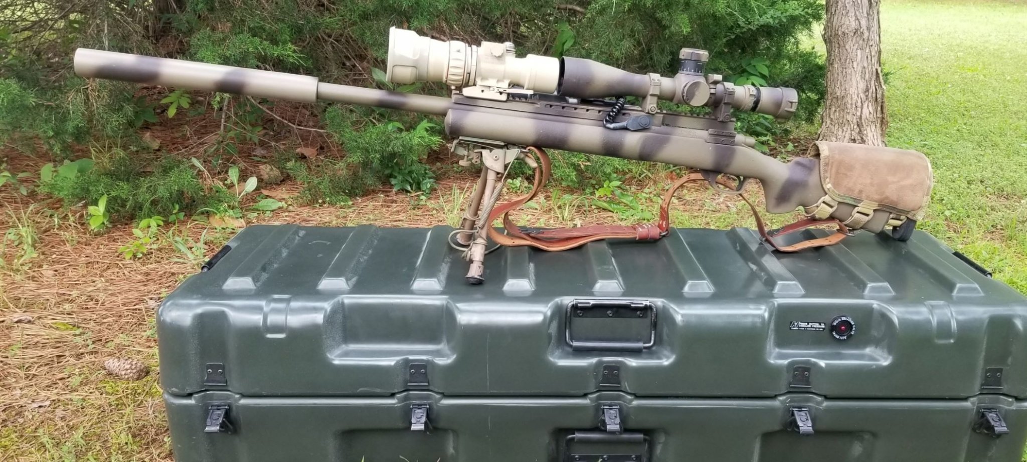

This is Smokey, my 1988 US marked M24, sporting its AN/PVS-9 Simrad KN203 FAB night scope and AN/PEQ-2 laser. Old tech by today's standards but I've consistently hit targets to 1050 meters on dark nights. The insert of the original TM from Remington is just there to make you salivate.

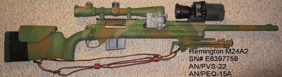

And this is my 2013 M24A2 sporting its AN/PVS-30 and IZLID 200P illuminator. Please don't berate me for leaving the magazine out of the pic. Sorry.
The next iteration of night vision for the M24 was the AN/PVS-10. It was designed to replace the day sight completely as it was a Day/Night scope. It mounted on the existing one piece scope mount. I never had any experience with it but I'm told it didn't bear up under scrutiny.
Other night vision used on the M24 were the AN/PVS-22, a pretty nice piece of kit. It was small and light and just as at home on a M4 as on the M24. This of course required the MERS or MARS rails as this was a true clip-on.

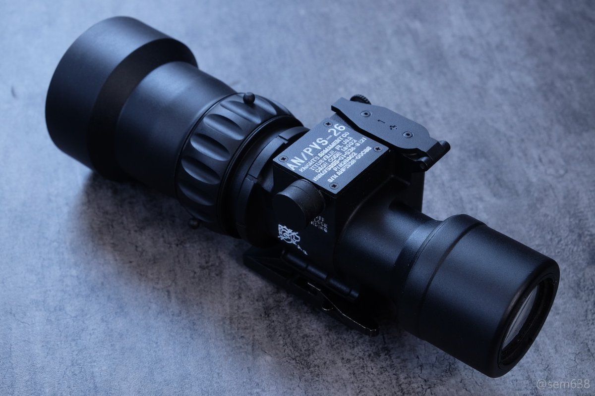

In very short succession the AN/PVS-26 came out very closely followed by the AN/PVS-30 shown earlier above.

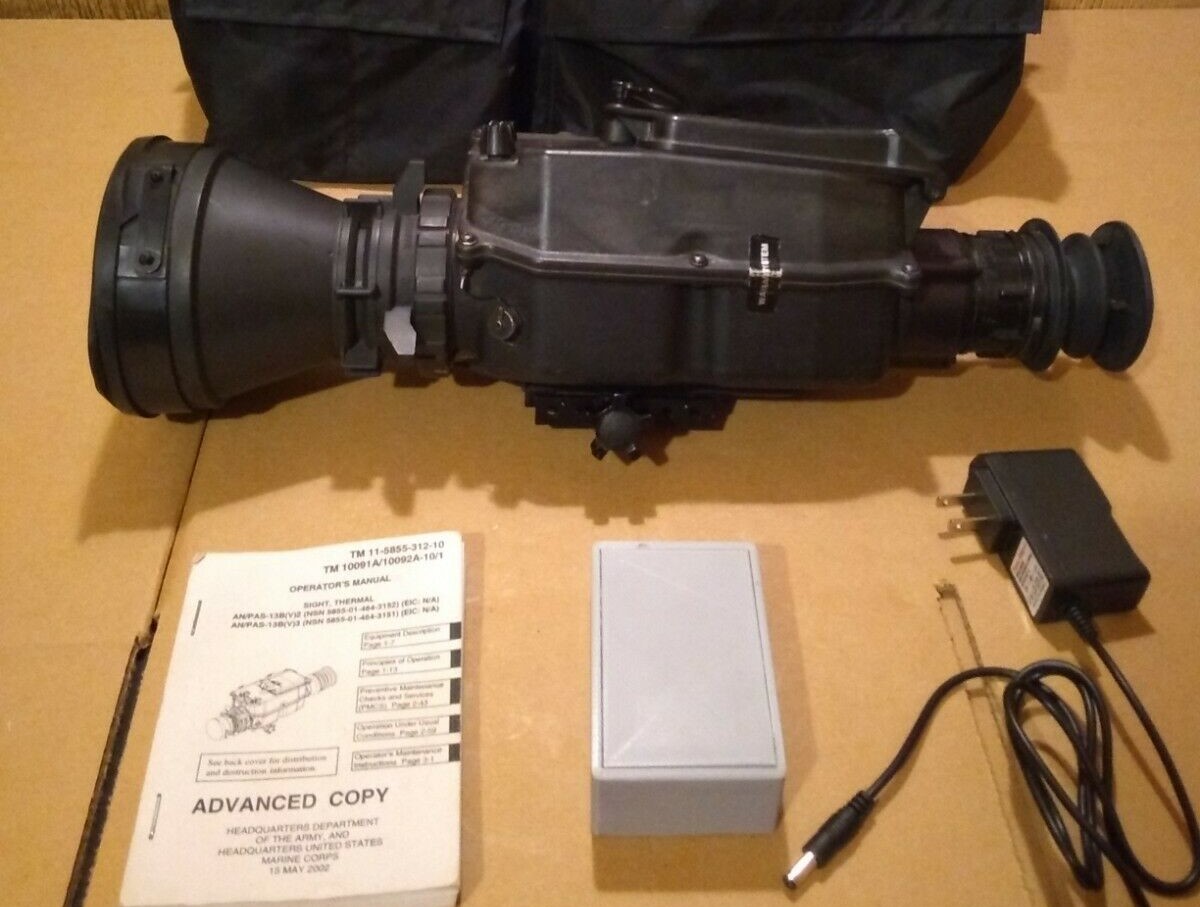

And the last one I know of is the AN/PAS 13 V3 Thermal scope which again I have no personal experience with.

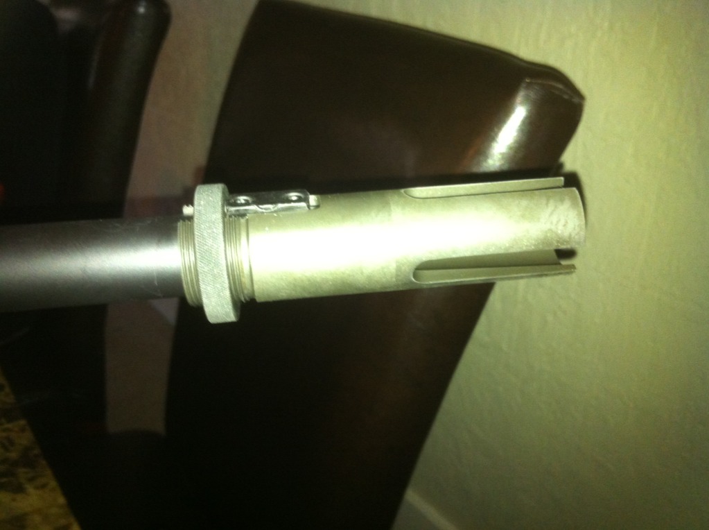

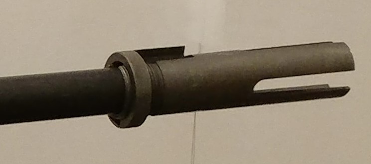

Associated with the night vision attachments was the blast deflector which was supposed to aid the shooter by reducing the flare caused by the muzzle blast. There were two versions made, one for the weapons with the Redfield type front sight bases,
and the later version for the OK Weber front sight base which is taller. [NOTE: this "Weber" version is on a Redfield front sight base]
This is the "Weber" version on a Weber front sight base [NOTE: the thicker locking ring]

  • The sling swivels shown in this thread are not what what is in the D kit, they are similar but none had the Remington R on them as they were sourced from another company

  • The PAS13 was a complete pile and very seldom used on anything let alone the M24 (at least the initial ones). It had a terrible red screen that precluded you from seeing anything.

  • The original flash hider for the M24 was developed to reduce visible flash and had nothing to do with night vision because at the time the only NVG option that was remotely available was the ANPVS-2 (starlight scope) which was not widely used or available. The flash hider came about for first light or last light firing or firing from inside of a building.
  • I am the one who got the second version of the flash hider made, Picatinny did not even know that the original flash hider would not work with the OK Weber sights.
I've only handled the first version. Are the bodies of the two versions the same, with the height of the locking ring the only difference?
I believe so, to be honest I have never held one either. During SHOT one year I had a meeting with Picatinny (SWS PM) and we were talking about the M24 and the FH came up. It was originally contracted by Picatinny and sourced from a small shop someplace. They originally made one for M24 that the Army had (2400 ish) and perhaps a few extras but not much. Another issue was that the FH was a secondary item meaning that it came through the supply system and was issued to everyone with an M24, however at least in SF it was not a controlled issue meaning that it was never a part of the weapon's Basis of Issue (BOI) so it was not inventoried with the weapon and it did not come with any instructions. Many who got them didn't know what they were for, I have to admit that I had seen them in our weapons locker and never realized that they were a FH for the M24 until I saw one on a rifle.
So anyway, as we were talking about the FH I said "you know the original FH will not fit on the current rifles because the new sights?" The PM looked at me kind of strangely and said something to the effect of "hell I never even thought about that"... I heard later that they were making a new one but never really looked into it, I moved onto other things and lost sight of it.
You're most likely correct that Picatinny contracted the flash hider but as I understood it, Rock Island made them or had them made or at the very least handled their issue. To answer the fitment question, the hider itself was the same size, the lock ring was the only part that was different.
It should also be noted that using the flash hider affected the harmonics in the barrel thus causing a POI shift up to 1 MOA. So, one either mounted it and left on all the time and zeroed it or you simply didn't use it at all. That same issue applied to the EMA and a possible 1 MOA POI shift so. . . . Use it or don't. Or learn to compensate for it every shot.
There is no doubt that Rock Island was involved in the production/issue of the FH.
As to the POI shift due to the attachment/removal of the FH, this has not been my experience at all, I have seen "perhaps" some slight variation but not enough to discount shooter error. I had a number of guys used them in training where they would take them off and reinstall them without issue. That said, I would always confirm/deny POI shift when attaching anything to especially the barrel. That said the M24 has a pretty rigid barrel and despite what many would tell you, they are not as sensitive as some would like to believe. I've wrapped the barrel and stock when camo'ing the gun, installed flash hiders, muzzle breaks, suppressors, etc. Some of it had an effect and some didn't.
The major issue I have had with it is that they grab everything when stalking due to the fork design, however they do a pretty good job at reducing flash, I was pretty impressed the first time I saw them used during one of our night shoots.

Wow. Thank you for passing on the knowledge. I carried M40A1/A3 for years. Loved the A1 more but the S&B scope on later A3 made the rifle more effective. I got an M24 a while back and fell in love with it. I shoot Federal 7.62 Mk316 Mod 0 AB39 Match through her. She shoots tighter then my M40’s did. I love the M40’s. Always be in my heart but the M24 is just amazing to me. Here she is when I first got her and now how she is set up. A few nice groups from both weapons. Shot from prone mostly.

Looks like an awesome rifle. Of course being an Army guy the M24 was the rifle we had (after the M21) but we also had some 40X rifles when I was overseas (very much like a M40 built by Crane but in a McMillan A2 stock). I have 2 M40's (the 1969 reproduction version that we did for the SSA one of which is a Chuck MaWhinny rifle). I've always wanted to build a M40A1 but just never got around to it and given that the Unertl optics are next to impossible to find I just never have.
All this said, I have shot a lot of M40A1's and a M40A3 a time or two, they are excellent weapons to be sure. I spent over 9 years on Okinawa and the USMC owned the ranges, so we would share the KD range with the SOTG snipers, of course there was always some good natured rivalry but I can say that the M40's did not "outshoot" the M24's despite what was said. We let them shoot our M24's and if you could get them to be honest, most of the time they would comment how surprised they were at how good the M24 is, especially when we pulled the gun apart and reassembled it and then shot to zero.
A Remington 700 in pretty much any form is hard to beat. Put a good barrel on it and headspace it a little tight and you are good. I have been looking for a Win 70 because I don't have but just haven't found something I want, but having shot quite a few rounds through them I'd say that I prefer the 700.

To tag along with eodsix's optics post, I definitely saw documentation that the PAS-19 was also an issue item back in the relevant timeframes, and the announcement and I thought some paperwork I have somewhere very much showed it on an M24. Certainly the image about it in the 1989 Janes is on an M24. Also called the Magnavox HHTI (hand held thermal imager though... not really hand held). Not a lot of info now, I believe though both were issued in smallish quantities, that was functionally a test and it lost to the PAS-13 series which was bought, in improved models, for years and in much larger quantities.
Anyway, I got one much more recently, though still years ago now. Put it on the PSS even — close enough to make me fell old school sniper! — It was... terrible. I am sure a miracle in the 1980s, but by the time I got it I had moved to uncooled thermals, so it was very hard to use, had weird power requirements, was hard to charge with gas (though it was just air) and so on so do not regret selling it at all, and I even profited a few bucks!
The one I had also came in a case with some interesting papers and stencils indicating it had been deployed to base security in Afghanistan as late as 2008 (IIRC). No proof it left the arms room, but maybe.
The only one of my photos I can find look cool still!
Pretty close to what it looked like through it under ideal conditions:
And through mine, under quite not ideal conditions (condensing humidity!)
Since these are unknown and not beloved, when they do pop up they aren't especially expensive.
If interested, ask and I'l see what I can find hidden on my computer, on paper, etc.

I don't think I ever saw one of those. We did have the PAS-13 which was a POS and we seldom used them.
