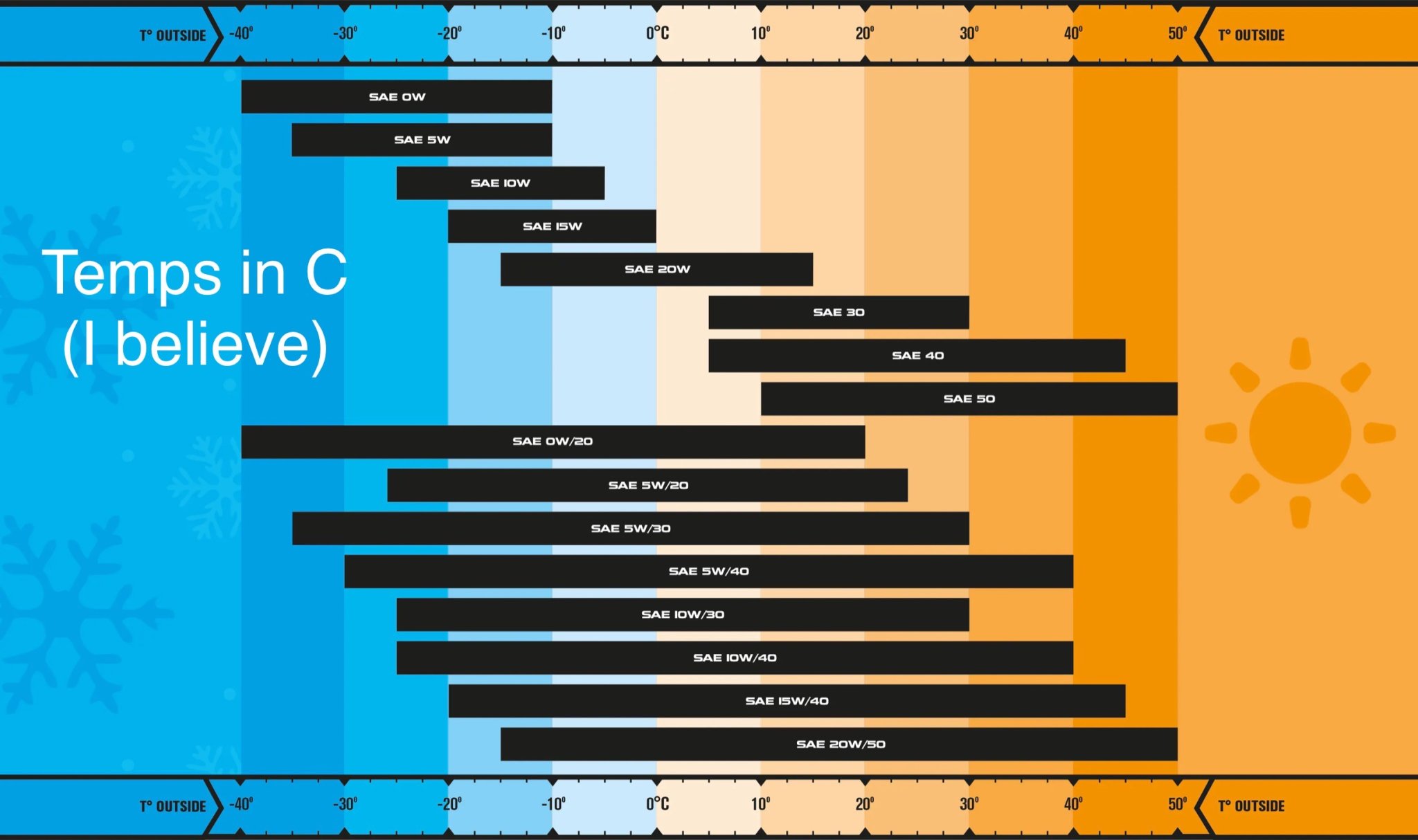

    Even Mobile One 5W-30 was thick, and that’s not even at -52°F like rope has been in. Coldest air temp I’ve been in is -40°F in gdamn Fargo ND.* Stuff just ceases to work at that temp.
    I know 5W-30 isn’t the thinnest cold-weather oil Mobile makes, but it’s darn close (see chart below) and you get the point. In serious cold, there’s a reason cold-weather cars/trucks use plug-in electric oil heaters all night to keep the oil fluid enough for the battery to be able to crank the engine!
    At those temps, I believe many diesel trucks are simply not shut off.
    0W or 0W-20 is for the coldest stuff. Got this generic chart somewhere, I forgot where.
    *With the 20mph wind at the time, the windchill was -92°F, since knocked back to only -78°F when they recalculated how wind chill was, uh, calculated a number of years ago. And no, wind does not affect oil or any inanimate objects.
