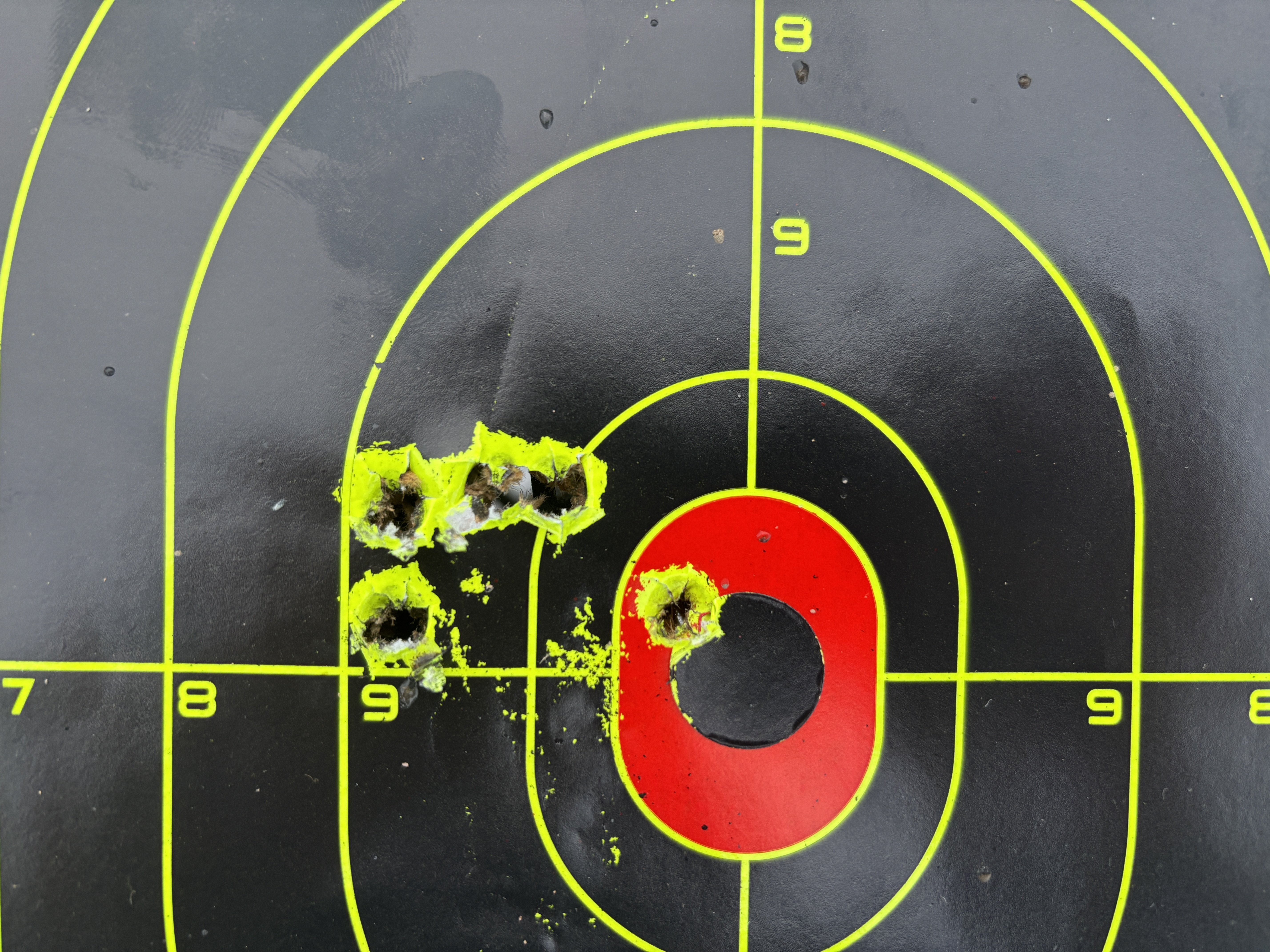

Ahh the return of the $530 rifle that needs a $300+ adjustable BCG and $150 buffer to try and get it to run properly. How has the accuracy been?
I would be curious how much percentage-wise that BCG is able to restrict gas compared to other methods though. Also I don't know how changing a BCG isn't dramatically "changing" the rifle since the BCG and barrel are without question the two most important components for a rifle's long term reliability.
5rds of M80 ball into 1.5” or so, pretty pleased with that. I broke a firing pin around 220rds in, and BCA sent over two more. My review is absolutely going to note that if you want to suppress one of these, you’ll probably have to make changes. The Bootleg and/or buffer are simply the least “invasive” ways to do so.
