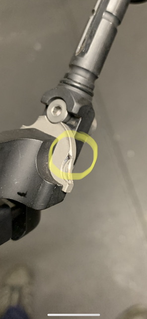

Anyone install these and have an issue where the leg won’t come down to 90* as advertised? Just got a set, installed them and no way the leg will deploy without having to push the button on the side like normal operation. No matter how much I pull, no dice. If someone has and I messed up, happy to be told so and what I did. But for the life of me, I can’t seem to see anything obvious. Have a message into the company and awaiting reply.

I thought that and honestly looked at them numerous times to make sure. According to the video, logo faces outwards and knowing that, there’s only one way to mount them having the proper orientation forward.

I’ve been chatting with them and we’re gonna try and rectify the issue. He’s not 100% sure on what’s going on. But very receptive and helpful so I’m sure we’ll get it sorted out.
Just a follow up…

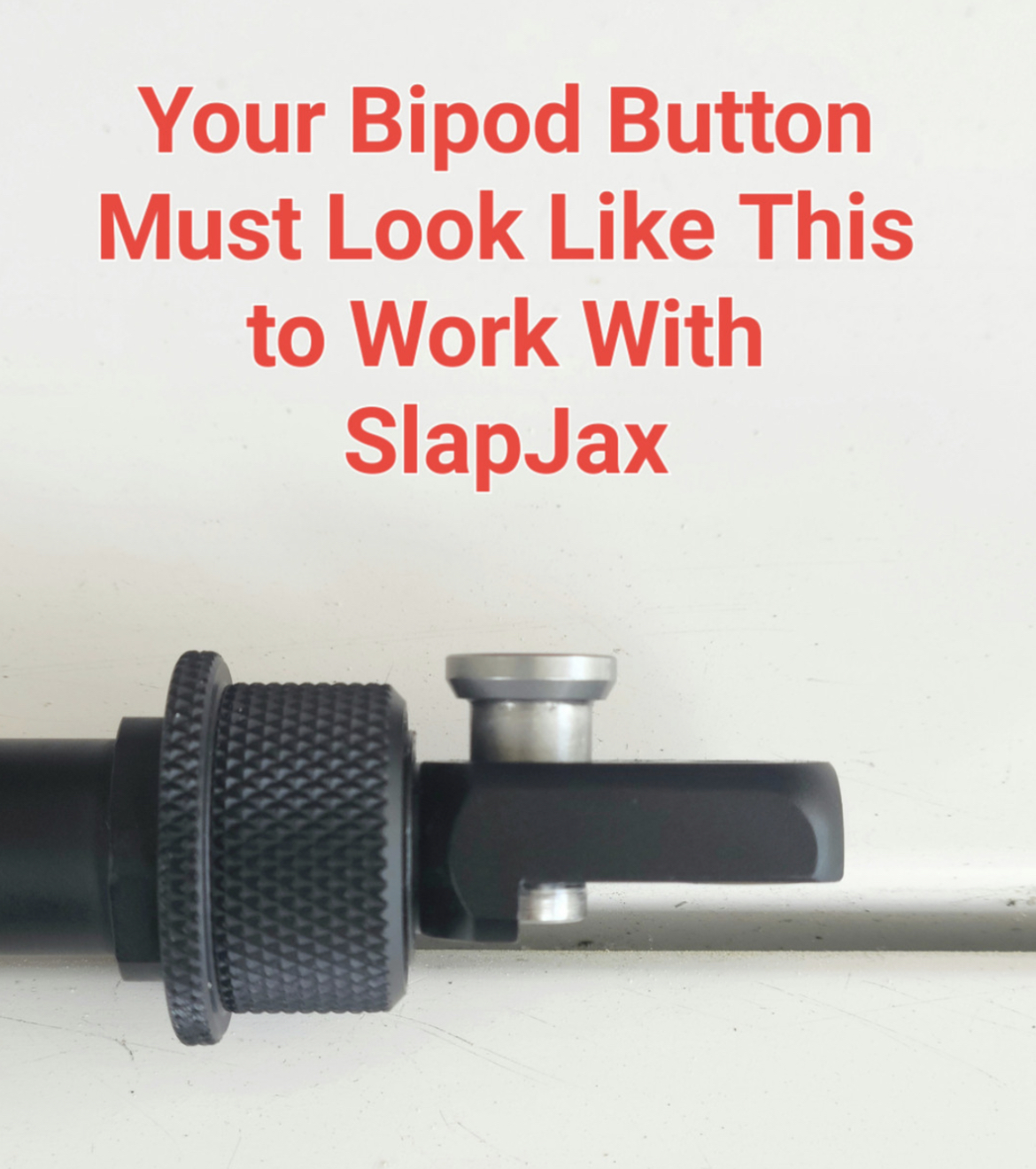

So apparently the older Cal bipods have hardware that make them incompatible with the slapjax. It’s specifically the buttons to deploy the legs. I have the older hardware which is why they weren’t working.
They were super cool to deal with, issued a refund and apologies. Im going to reach out to B&T about purchasing new hardware but I suspect they wouldn’t sell small parts.

Can someone post a picture comparison between "gen1" and "gen2" cal2 hardware ? Never heard of this previously.
Hopefully this helps. The button on the newer Gen hardware flares out where mine does not.

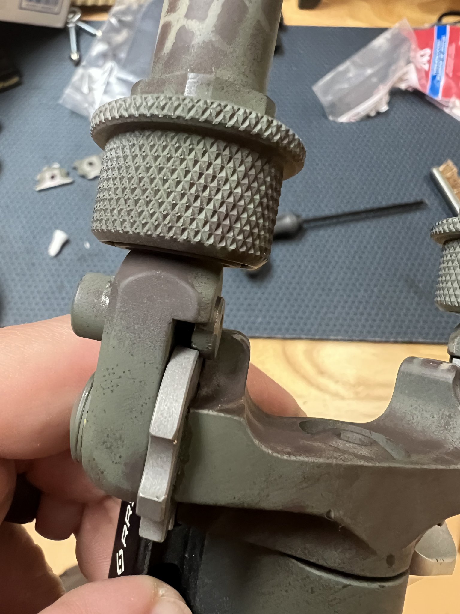

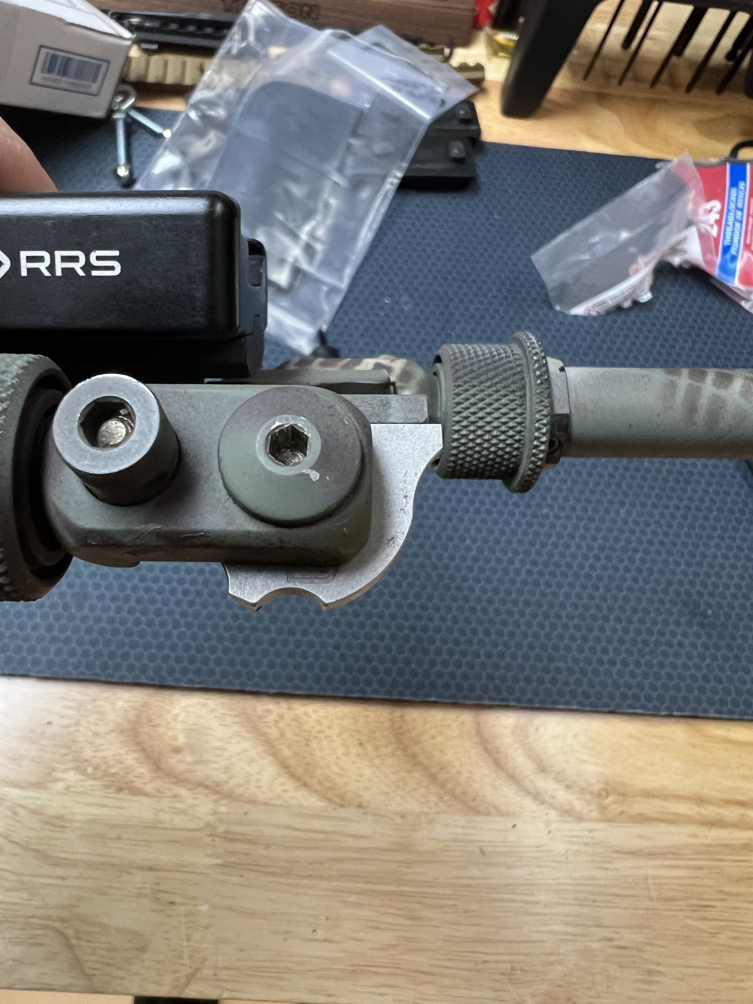

FYI... If you have the old button style CAL, these will still work. You just have to LIGHTLY hit the edge (of the Slappy Jacky...NOT the bipod) with a Dremel or file. Just installed a set on my older CAL and they work the exact same as the ones I put on my new gen CAL.

Can you show exactly where you hit it with a Dremel? I’d still like to use them if I can. I’m cool with breaking out my gUnSmiF skillz! 😂
Reactions: M8541Reaper
You just want to lightly knock down the edge (on the SJ) that holds the leg pin/button in place.
If you want to keep the same tension as factory, witness mark your legs prior to breaking the loctite and starting.

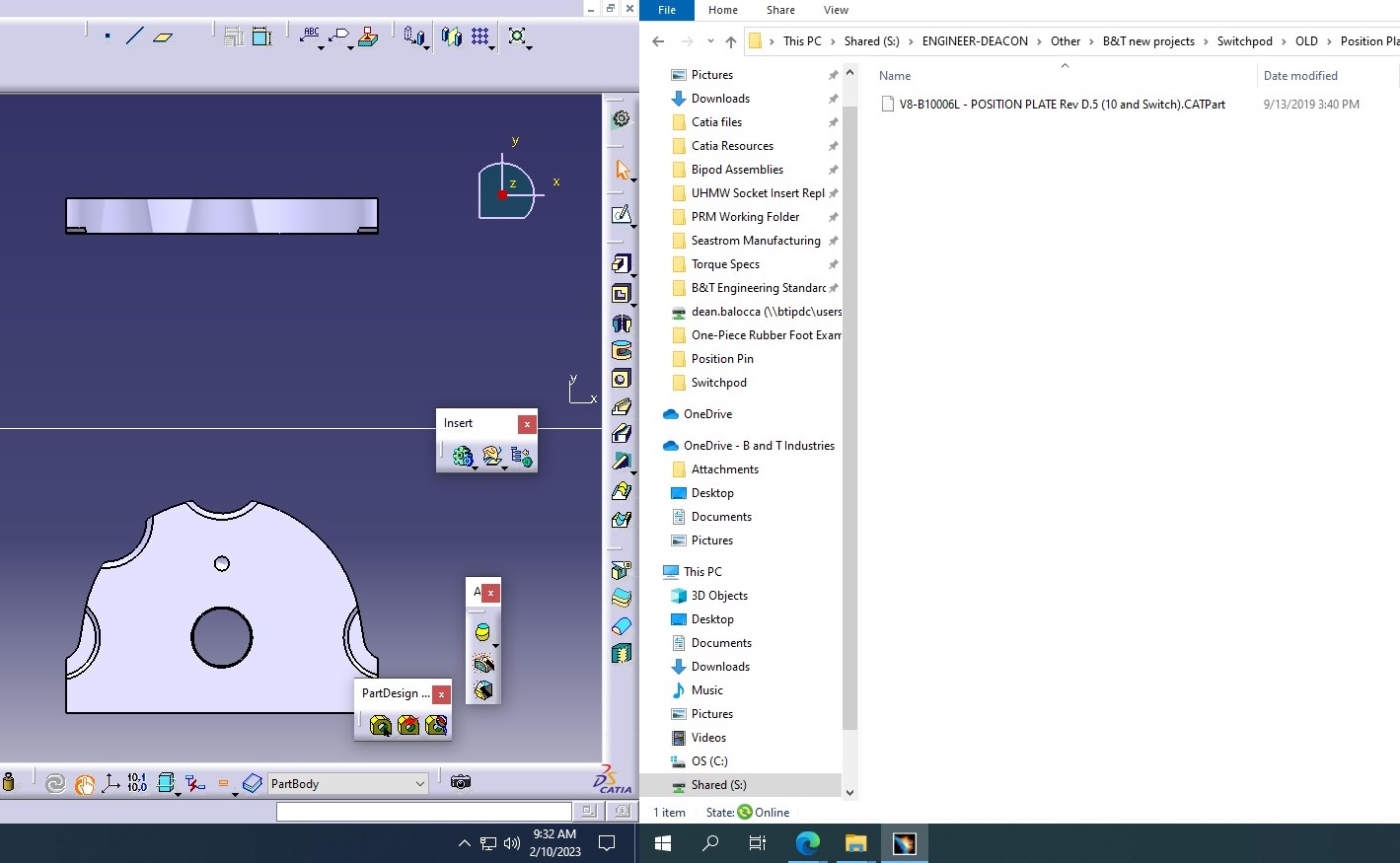

Sorry for slow reply. This plate design is nothing new to us at B&T, we designed it back in September of 2019 (see below) and got some prototypes made to prove the design. Furthermore, a Swedish company has also been making them for maybe as long as a year ago... https://fksport.se/sv/tillbehor/benstod-bipod/locking-plate-for-atlas-bipod Regardless, IF the maker of these had of asked me about doing this, I would have cautioned him of ALL the different geometry changes we have made over the YEARS that will have a negative impact on this plate. In fact, we are seeing the result of this above in some posts where they don’t fit/function. FYI, one size Position Plate will not fit all CAL bipods, or any Atlas bipod line, we have had many revisions on all our bipods.
Which begs the question why we are not making them! Pretty simple from my chair, since 2020 our business has been busy with what we currently offer. When we are pushing out delivery dates for dealers and asking employees to work at least 45 hours, is no time to add to that mix let alone we have no room for more inventory. We are resolving that with a larger facility we hope to be in within 18 months and then we will be able to accommodate many of the new products that are in a holding pattern to include another bipod for those that want faster functionality.
And remember, we did not patent our push button feet design as I knew others were working on feet for the Harris and wanted to give this feature to the industry. So, selfishness or exclusivity is not who we are, in fact several of our competitors offer the same feature. We are about doing what is right, which is why I tried to offer the idea for the Atlas to Mr. Harris himself as he was the bipod guy.
On the warranty, going from memory it has been probably the within the last six weeks that we saw two Leg Bolt failures, a rare occurrence as we maybe have had 10-20 since introducing the Atlas 15 years ago. So of course, we do our due diligence to try and find out the “why” checking the material, machining etc.. Of course the signs of the hex socket being stressed/deformed suggests an attempt was made to remove it, but the customer says otherwise…. Then we are made aware of these plates and the makers “…MAY void warranty” statement . Mystery solved and solution is in place.
To be clear, installing these WILL void your warranty with B&T, in fact we no longer warranty ANY Leg Bolt failures.
