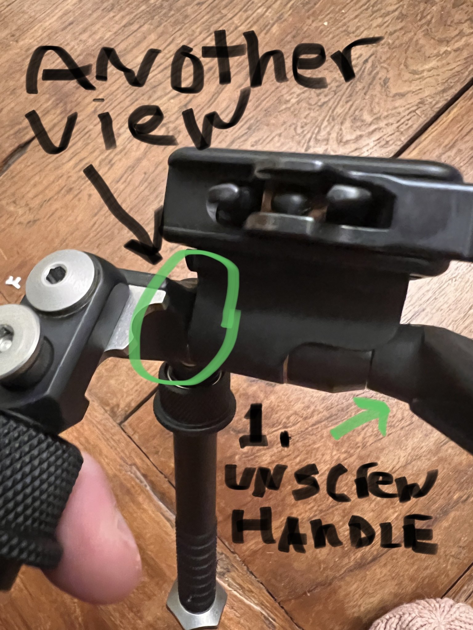

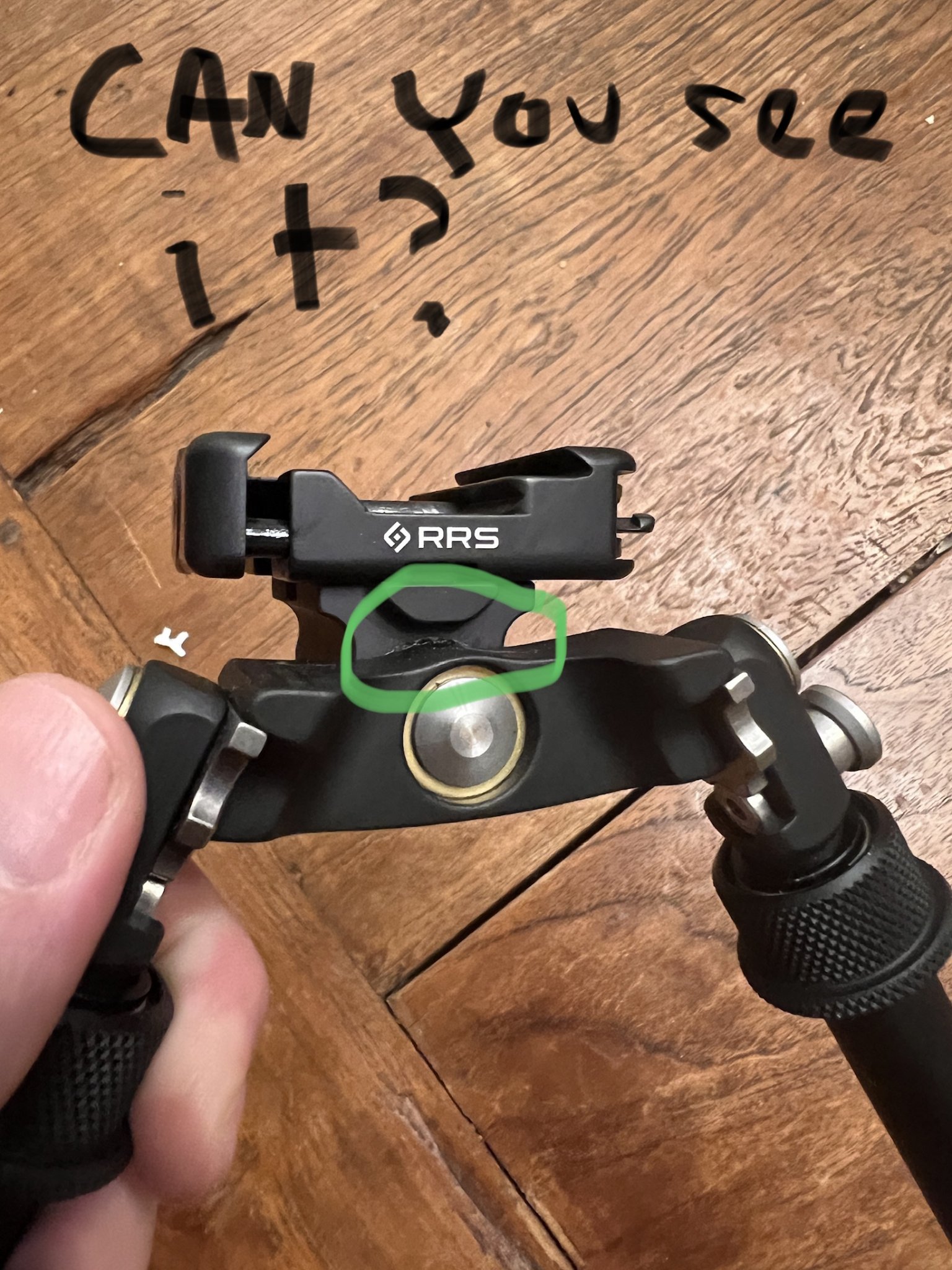

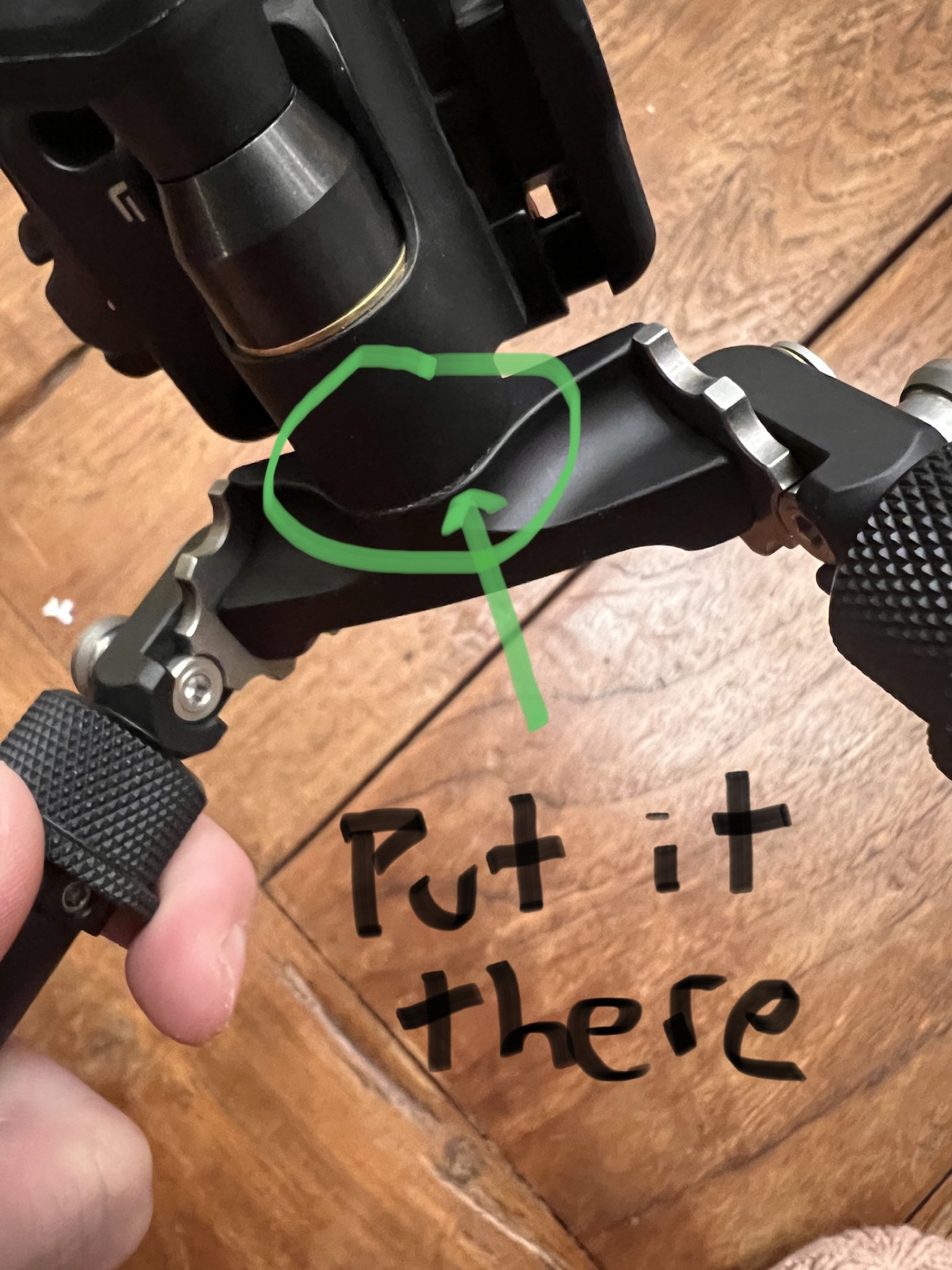

My solution to stiffen up Atlas bipod cant
