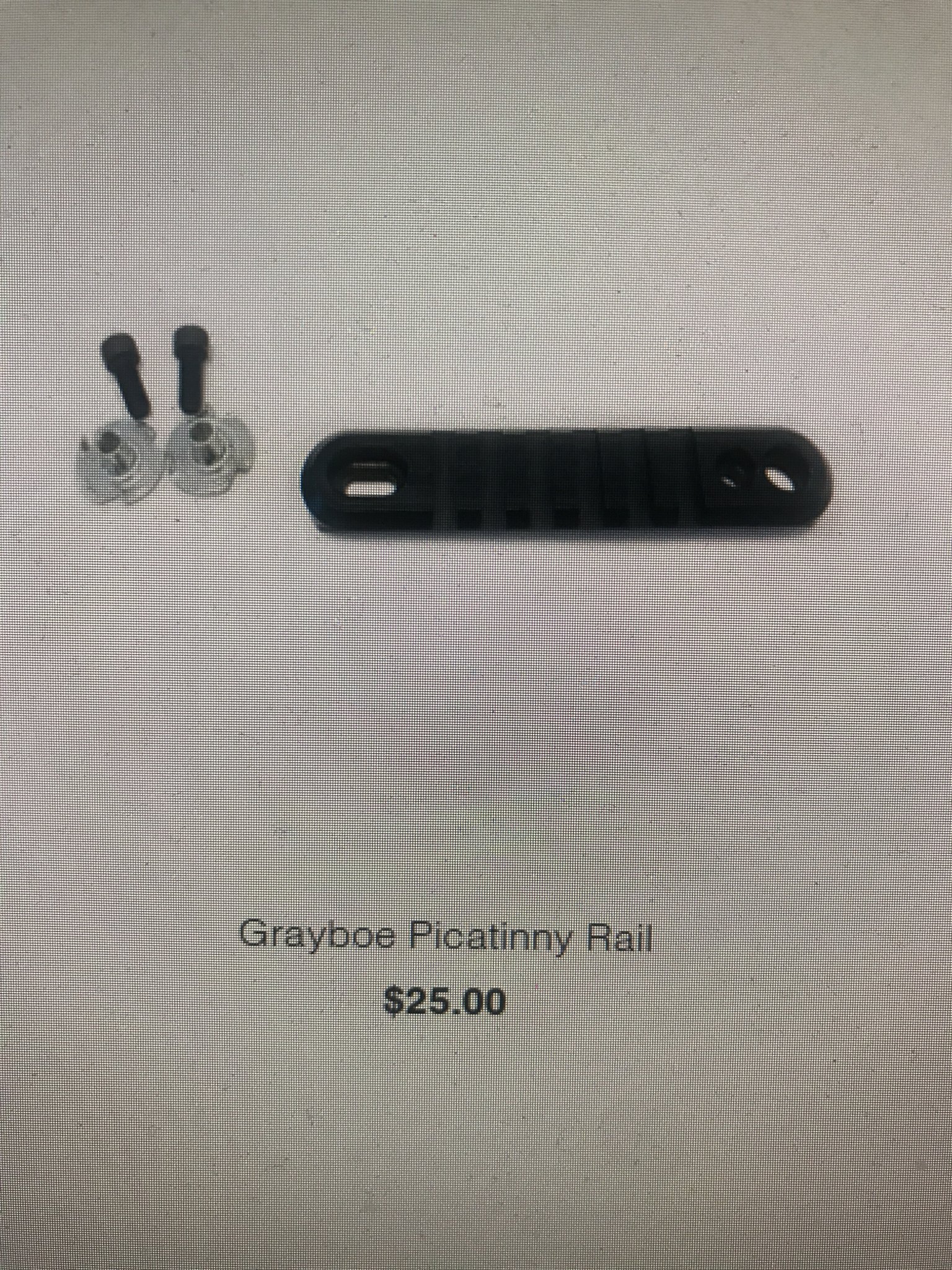

If you arent comfortable working on stuff, contact user @jducos
He is the Stock Doc and could do it for you.
Thousands have used his services.
No hate on the .308, I have two 700P rifles and my .308 uses a Harris bipod. The swivel stud limits your options but unless you are setup with a mill and know how to use it, best to send it off as suggested and have it done. As they do many of these, they may have ideas on mounting options that you might not have seen and can direct you to the best option in your application.
Drilling into those HS stocks can be PITA for the average guy. I drilled out the end of one of mine years ago and added a 5” mercury recoil suppressor. I got it done and the tube fit great but if I were to do this again, I would send it out and have it done. I am not sure what parts of the stock might be hollow up forward. Luckily, I had just enough material in the comb section to drill into as there is a lot of empty space in there. I filled in all the hollow areas in the rear of mine.

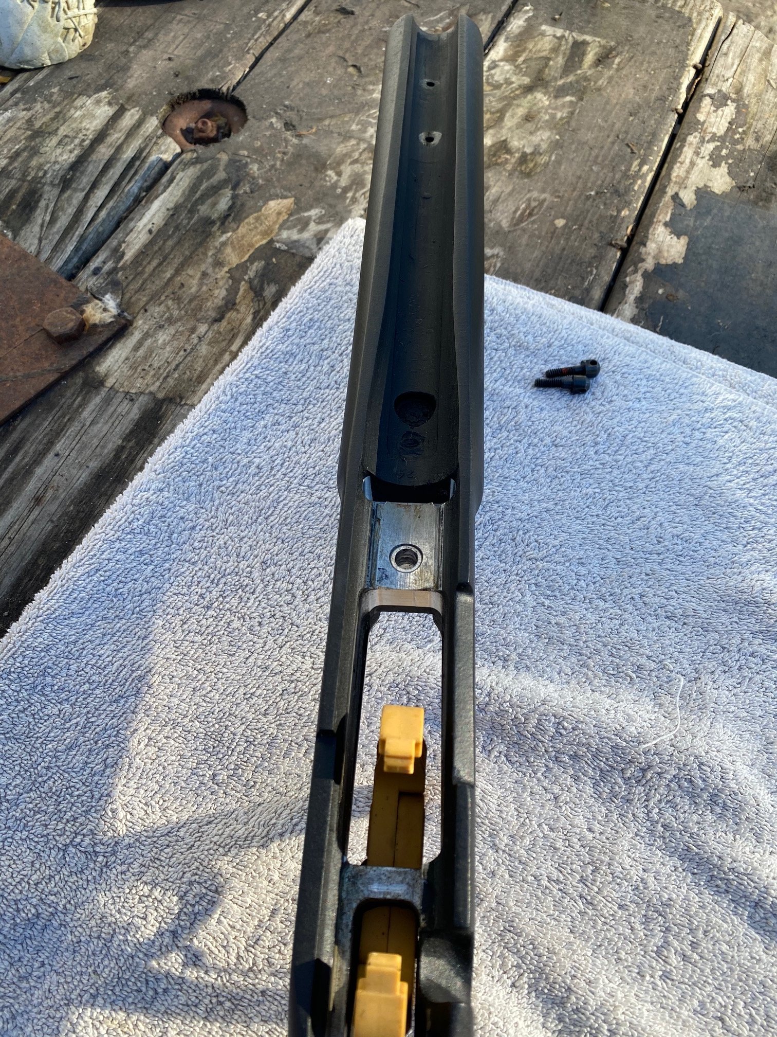

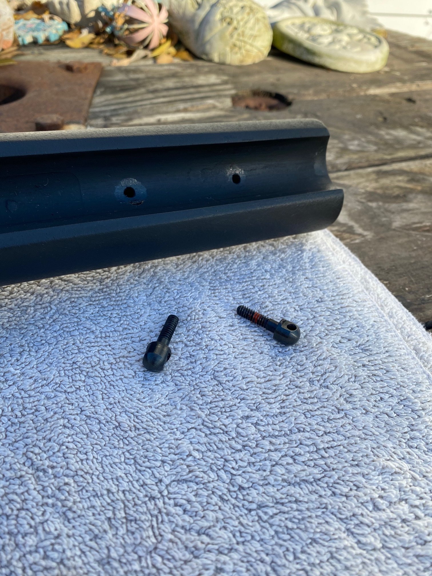

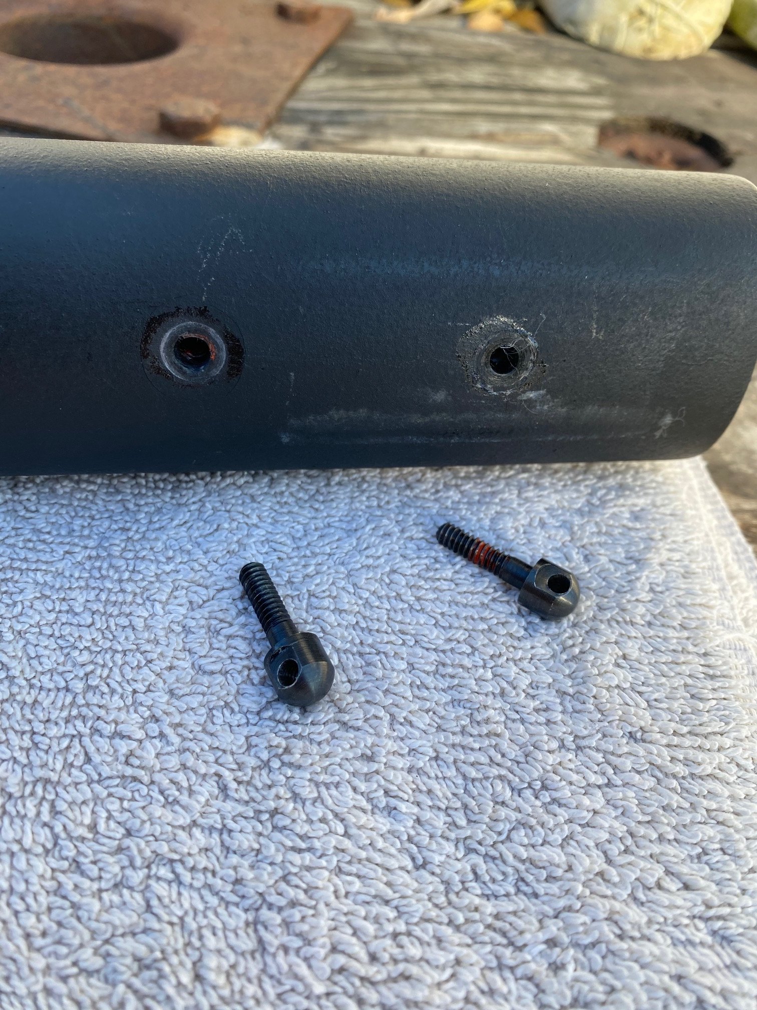

Post a pic of your stock.
Reactions: S12A
Many thanks members. I probably could have phrased my question more better.... :rolleyes: ...was trying to see if any others ran into this same issue of keeping a sling stud, and if so, what was used for the other fastener? It appears that it is a simple remedy.
It is a factory original 700P stock, except for the bottom metal for Alpha & Accurate mags. H&S if I am correct. The barrel is a Kreiger 1/11 with the install and blue printing done by Jon at Area 419. This was done back when he had a one man crew....himself. I really want to keep the capability of sling use-I was also concerned if the bipod (QR) attachment would take up all the rail space to preclude use of any fastener unless it is flush to the stock? Speaking of stocks....the rifle shoots quite well but are there other options out there for my action that I should consider? Great, another rabbit hole....o_O

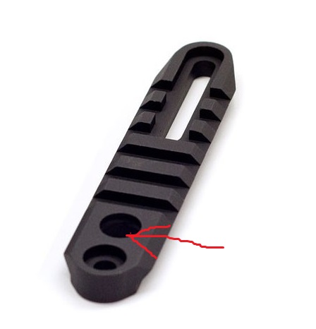

Seekins make a rail specifically for this spacing:
I though B&T did also but I must be mistaken.

Pretty sure those screws thread into the alloy block so you shouldn’t have any need to do any drilling etc. just get the appropriate length rail and screw into the existing threaded holes.
With either of Atlas' rails (either the BT15 or BT17) you should be able to use the QR (Atlas uses the ADM-170-S) AND still have access to the flush built into it for use with a QD sling swivel.
