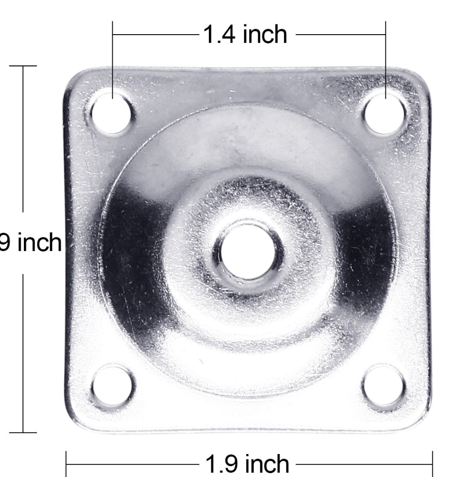

I have the stud mount and rail mount Atlas monopod. I initially thought that slight sideways wobble was due to my oem plastic stock. I still get that sideways wobble with my MDT and KRG Bravo chassis. I finally switched back to a rear bag.
But I’ve always thought about making the monopod more stable by replacing the rounded foot with something like this but I haven’t had any time to take this idea any further.
Is that piece pictured a Lowes/HD item? I'd be willing to try to take the bottom cap off one of my monopods and try to attach that. There should be enough clearance under the stock that it doesn't hit when folded.
