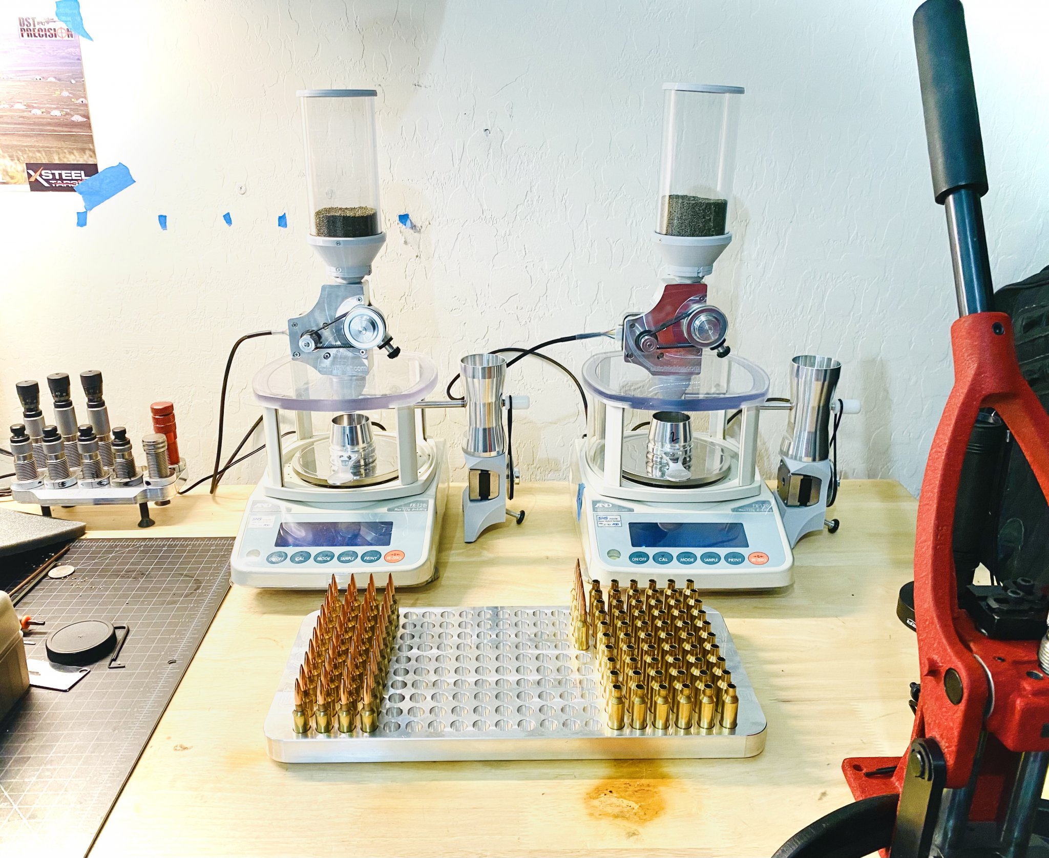

I love my Autotrickler v3 w/ FX 120 so much I ordered a 2nd to speed up my reloading time. The only way it could get better is having a 3rd autotrickler running at the same time.
85 grains H1000 give or take 0.02 grains. A real time save.

Love mine. To speed things up even more, get 2 area 419 powder cups and sand one down so they are the exact same weight and rotate cups out while you load a case. (Thanks to F-Class John on YouTube for that idea)
The Autotrickler V3 is worth the wait and the funds. I went from a 23 second throw on my Chargemaster to an 8 second throw on the V3. To some it might not seem like a big deal. Well, Load up 300 rounds in a sitting and do the math. It boils down to what is your time worth, accuracy of the throw, and consistency between each throw.
