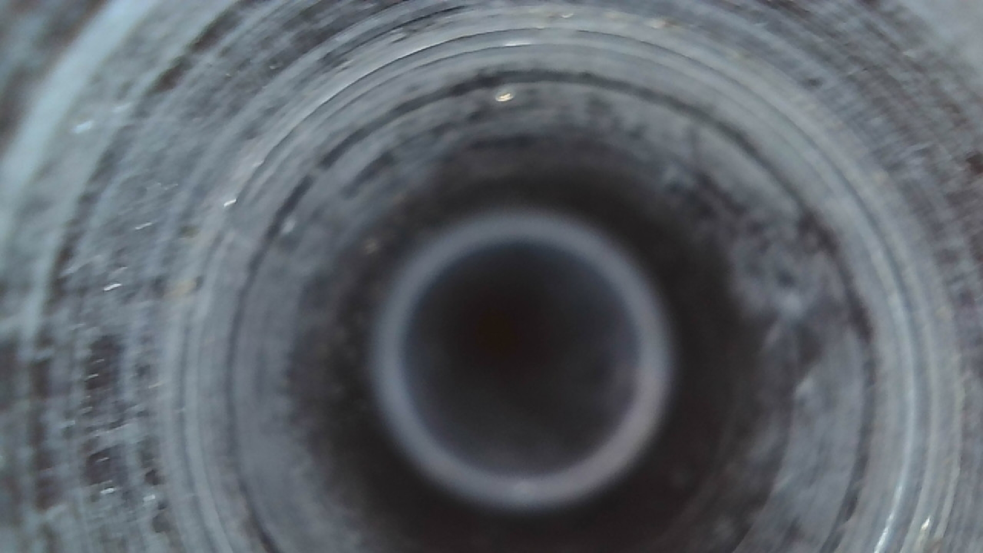

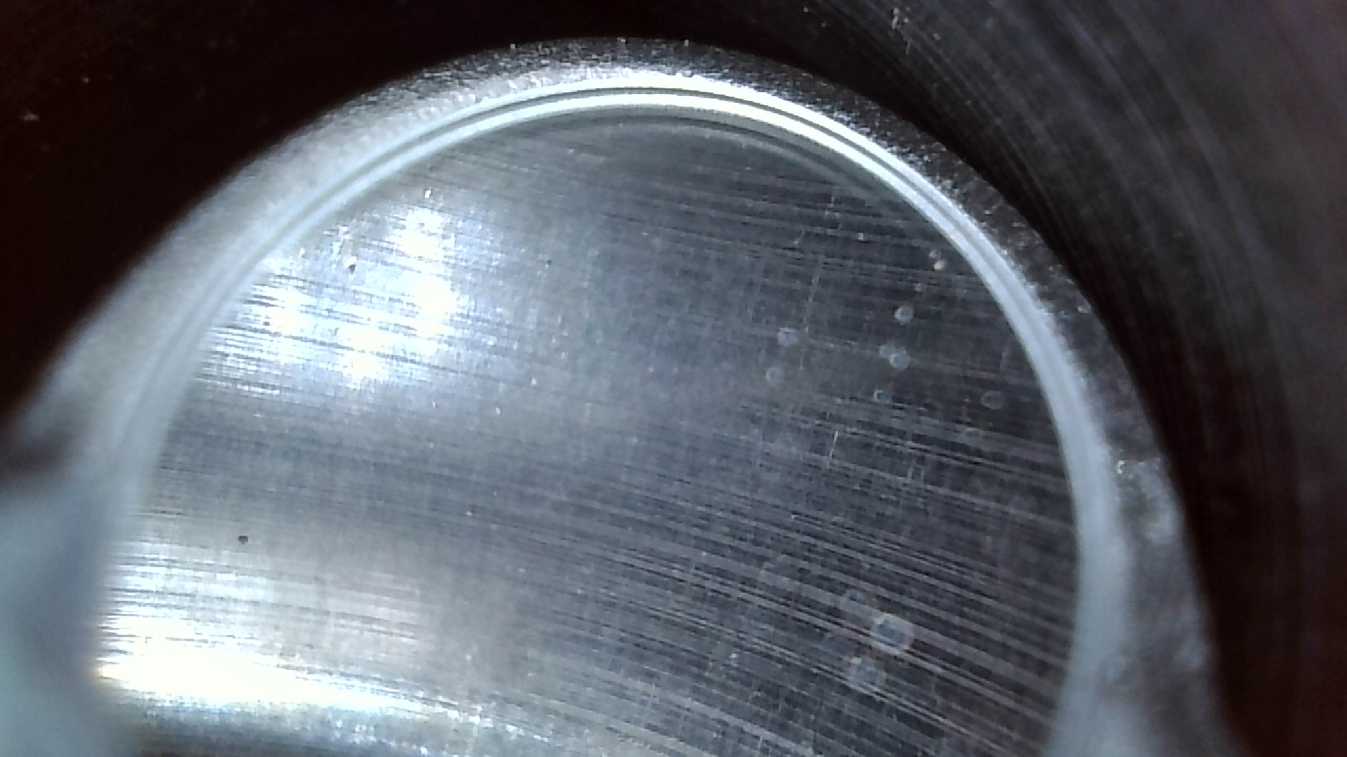

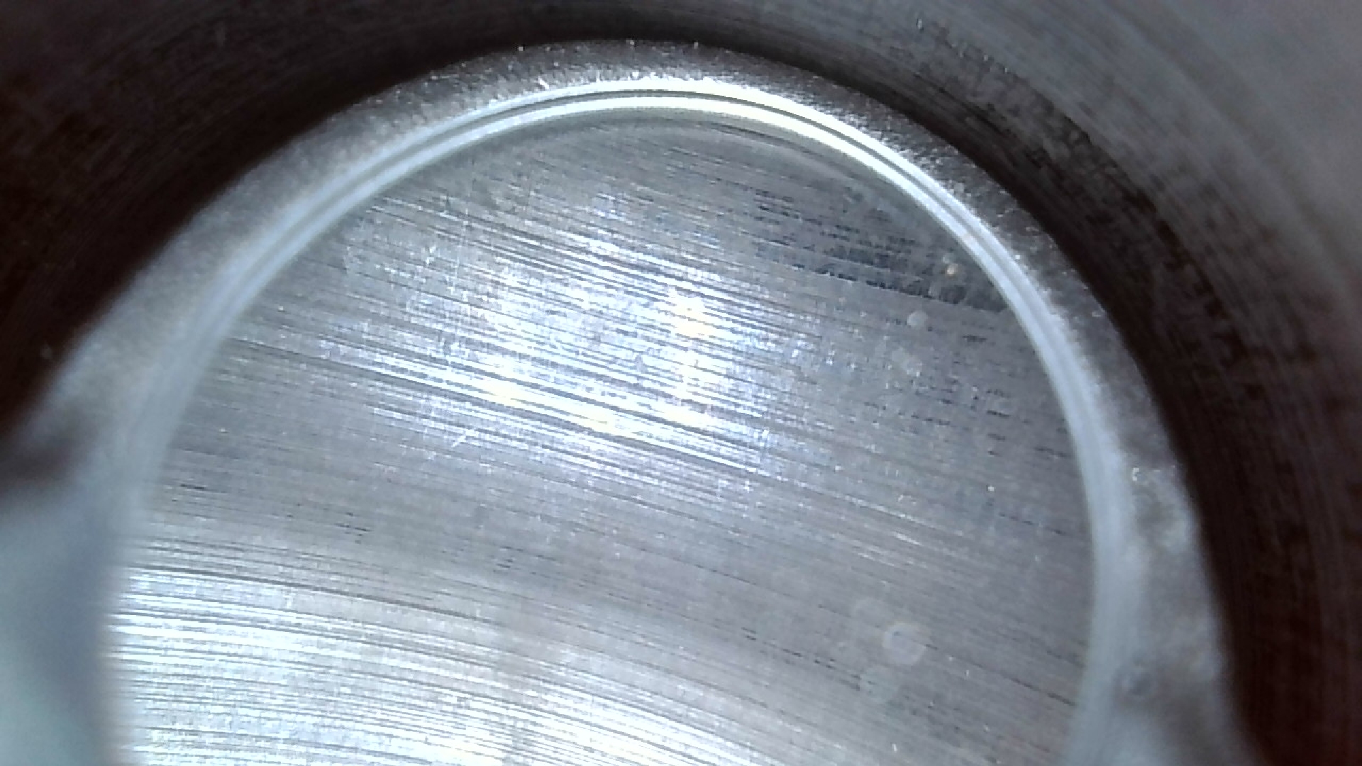

Yeah. As far as GLFA goes...the chamber in my 308 looks pretty rough. Im having a tough time with stuck cases and torn rims
Oof…those are chamber pics?
Did you install an AGB on yours yet?
I’m pouring the coals to my 300 Win Mag, but I’ve put an AGB on mine.
How big is the gas port on yours yet 308 barrel?
Thanks
Yeah, those are chamber pics...Nope, no agb yet. Have one on hand though. Ive been loading "regular bolt action" loads. Next im going to try the "service rifle" loads and see if that works.
