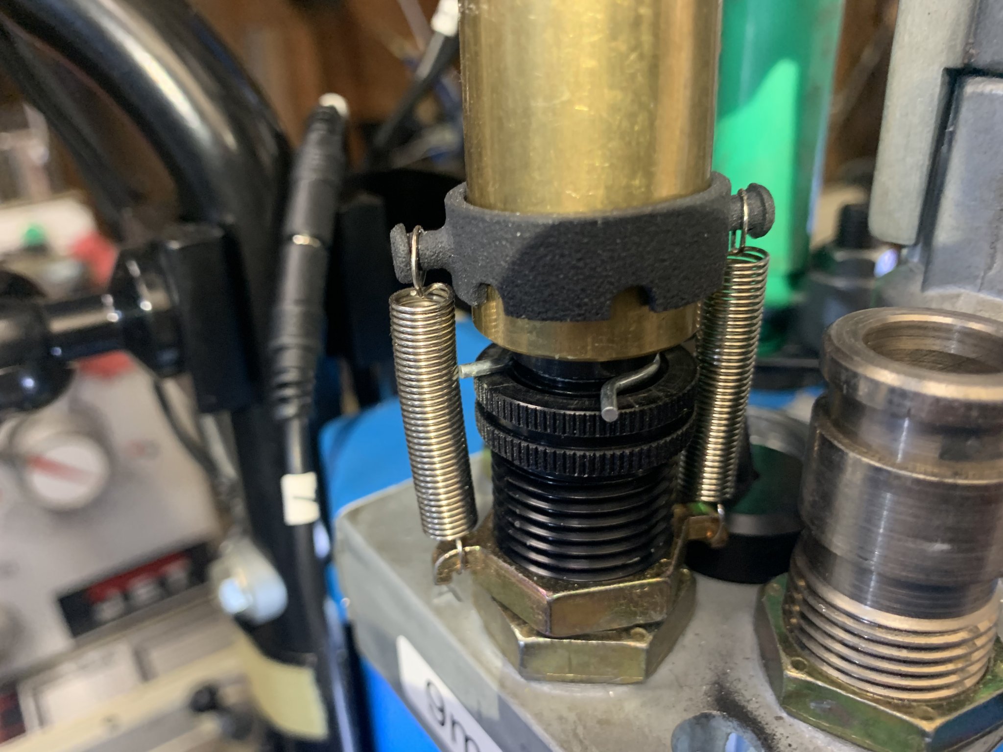

Top pic is of the DAA return spring set up. Works like a hot damn. They should include one with each Bulletfeeder. (I went back and re-read your statement. You're having a problem with the bullets not being heavy enough to trip the limit switch inside the feeder head to stop the collator portion from filling up the feed tube. You may have to bend the limit switch arm to get more contact with the bullets).

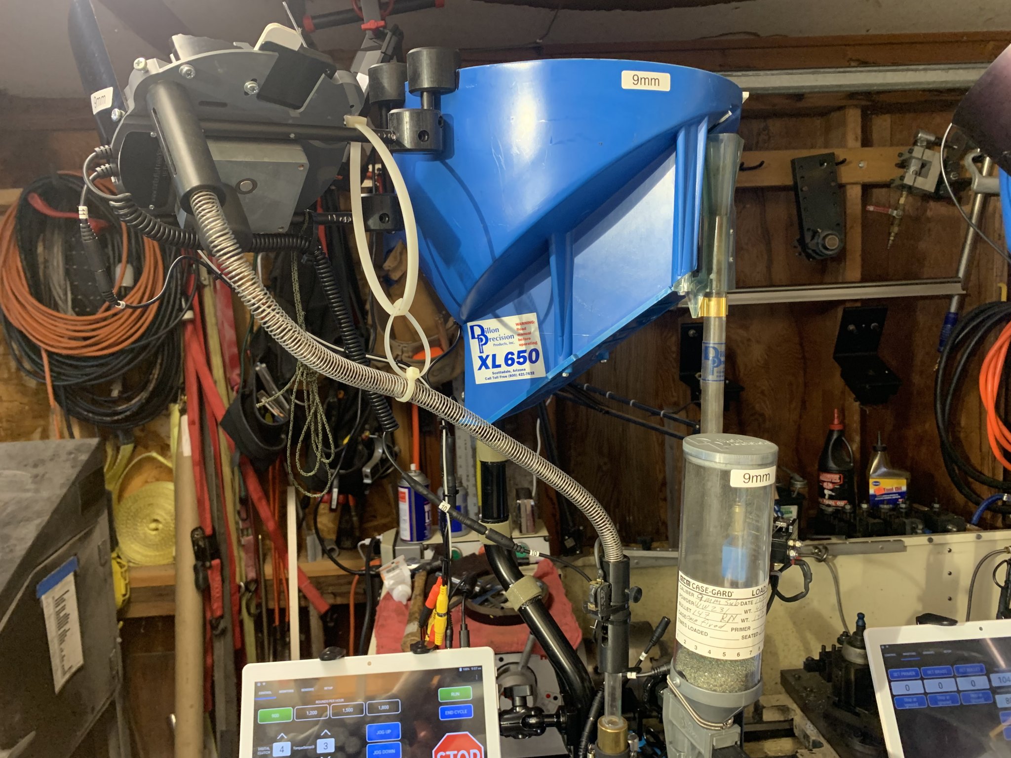

Bottom pic is of the zip tie kludge that I put together for the bullet feed tube/spring. Ugly, but it works well.
Oh, and FWIW, my Bulletfeeders are working quite well, I'm pretty happy with them. Took some tweaking/mods/additions to get there, but they're running pretty sweet right now.

I have the spring retention jobbys on the bearing slider piece. My spring coil tube from the feeder to the drop tube is a lot shorter. Maybe I need to lengthen it so they pick up more speed on their way to the flat metal switch
You can stretch the spring coil tubes out, but be careful and only do a little section at a time.
Reactions: reubenski
