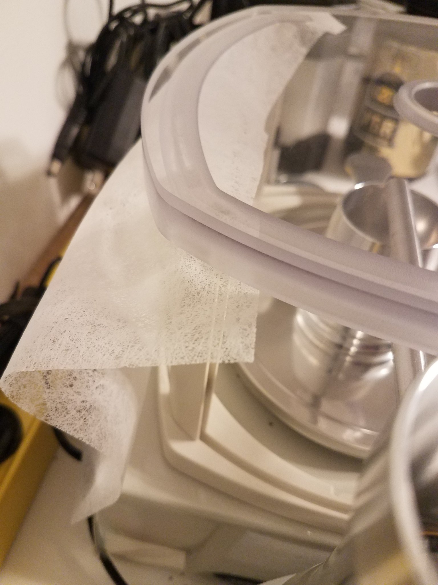

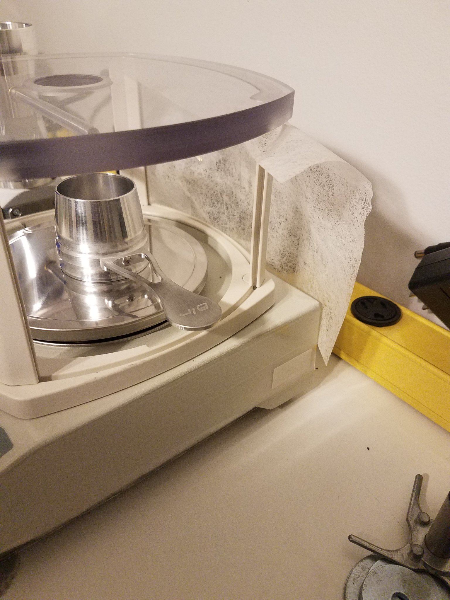

I had issues with mine drifting during use even using a conditioner. My cure was to run a dedicated plug for it on its own circuit and I use a dryer sheet and rub the cup on it between each fill and no longer have any drifting issues.
Reactions: Dogtown
Reactions: Yankee88
