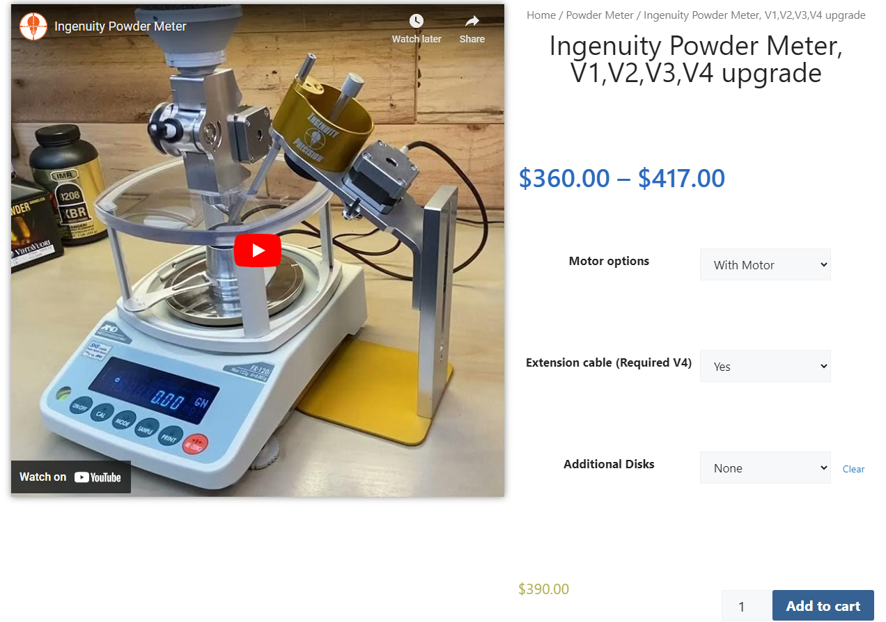

How much is it individually
The IP Trickler less the motor is $372.50, because if you are ordering the ATV4, it comes with the motor that you can use for the IP.
The ATV4 is $1070 in a bundle with the scale. So the total #372.50 + $1070 = $1442.50 USD

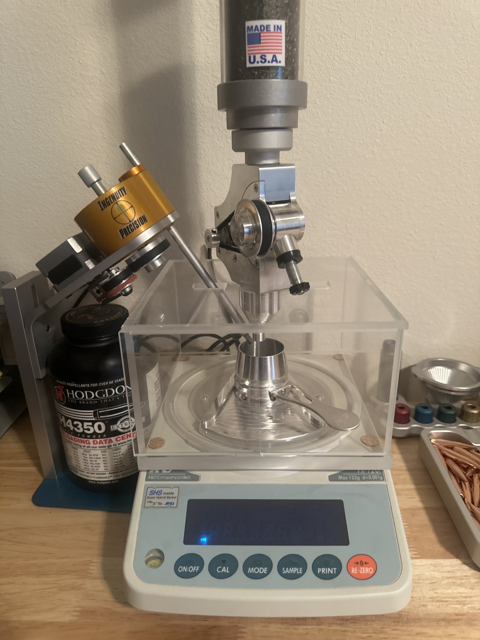

Correct get the v4 or v3 system and add just the ip trickler. Once the ip powder system comes out you can sell the v4 and keep the ip trickler you won’t have to buy it twice if you decided to upgrade systems. Here is my v3 with ip setup.
Reactions: RegionRat
What does the full ip system offer that the v4 and ip doesn’t currently give us? I read on the site and seemed like maybe just speed and not having to use the app?
Sounds like to me get a v4 and his upgrade and start loading a lot sooner, anybody have recommendations on where to get my scale? Also I see some scales with the top on them when I look them up and some without?

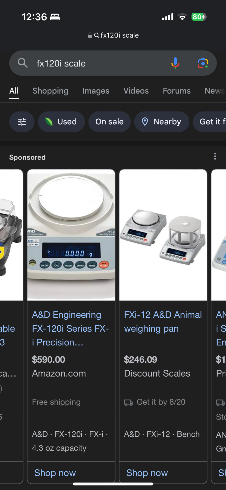

Not sure what you mean by "scales with the top on them and some without"?
I guess the cover is more what I mean, here’s what I’m talking about
You have the options listed on the AutoTrickler web page to find the scale bundled with the ATV4.
I looked and see the outfit I used for several units is still one of them, CE, not showing in stock but shows arriving soon.
https://ceproducts.shop/collections...rickler-v4-a-d-fx-120i?variant=39562066493549
There is also https://www.unknownmunitions.com/product/auto-trickler-and-ad-fx120i-kit/
https://autotrickler.com/pages/autotrickler
