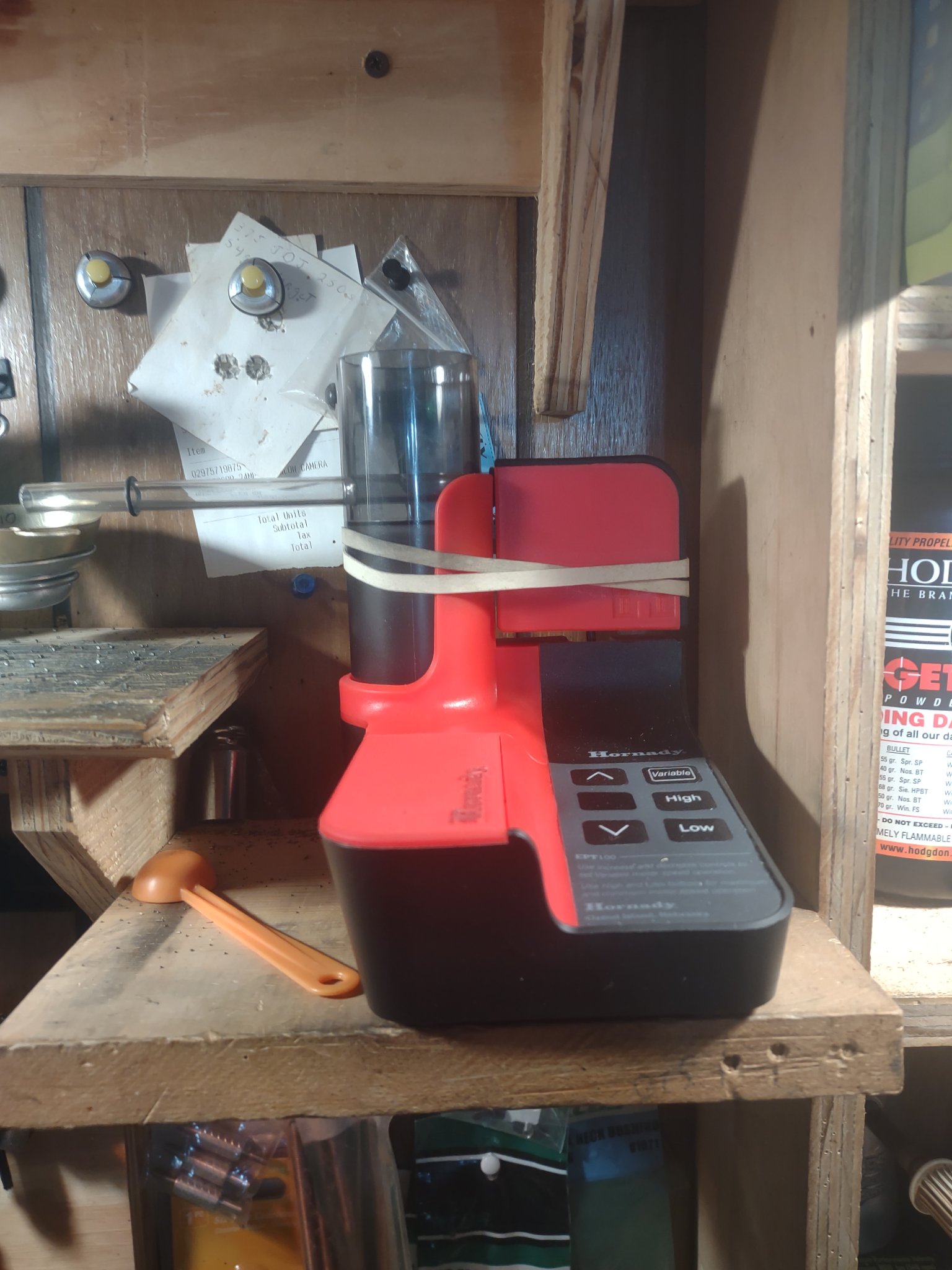

Not calling it high end.rubber band does make it work better

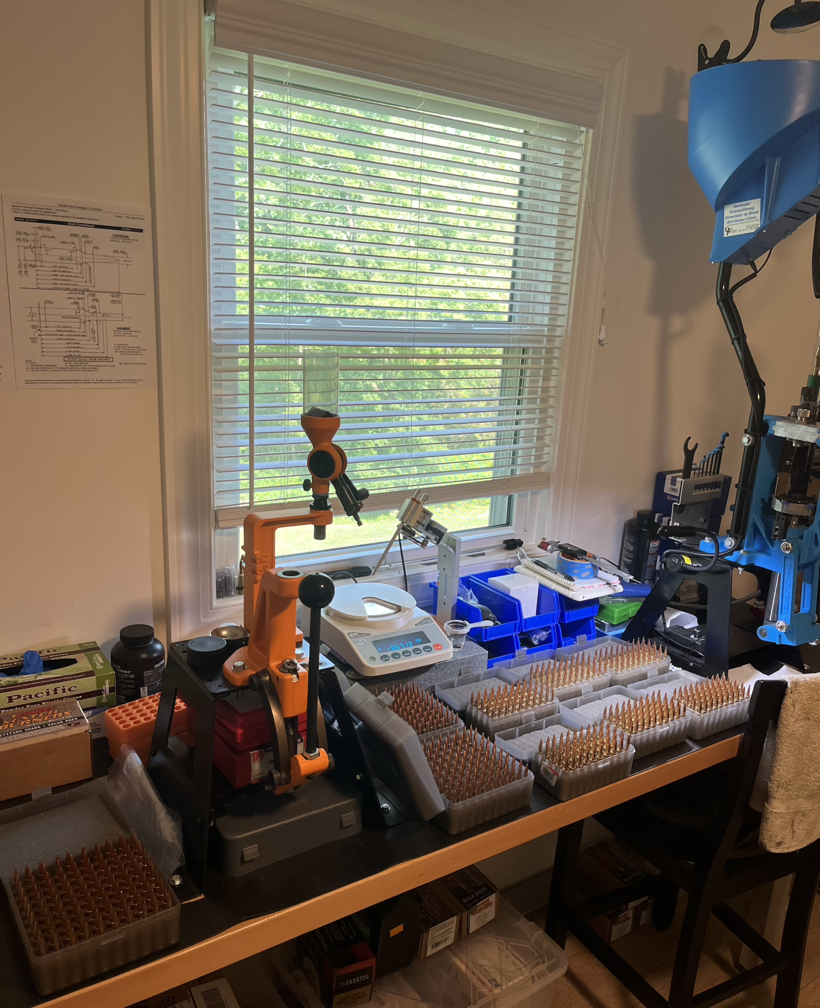

Can you explain your manual drop method? Because your process may be something to consider for me. I also wonder If I got the FX scale and IP trickler, do they "communicate" to stop at the designated charge? I am envisioning something like a manual drop, let the IP finalize, fill case and drop another as soon as the case is charged.
That's what I was going to do and had the IP trickler ordered to go with the FX I already had. When I heard about IP's whole system, it took me a while to decide to splurge and get it. As I think I mentioned before, I don't think the whole system is going to make much difference from what I planned by just manually throwing and IP trickling up. That's why I see it as a "splurge" for perhaps a little more convenience.
To your question. . . yes, the IP trickler "communicates" with the FX via a serial port and does a great job of stopping at the designated charge. Nothing's perfect, but this trickler is damn good! Though you have to use the right disks in it for the particular powder being used (a minor set up issue when changing to some powders with significantly different size granules).

You get the scale from whomever you want (I can recommend CE Products and I think they're the cheapest), the trickler from Ingenuity Precision (they call it a "powder measure"), and the other stuff from www.autotrickler.com.
So was this complicated to get set up and running? Why do you need the V3 stuff if you are manually dropping? Why wouldn't it just be the trickler software?
You program the scale per Auto Trickler's V3 instructions which normally would be connected to the AT V3's bulk dropper and the AT V3's trickler... the Ingenuity trickler replaces the inferior V3 trickler, and instead of the V3's bulk dropper, you connect nothing, and you are the monkey who lifts the handle.
I honestly love how bonehead simple and trouble-free it is doing the bulk drop manually, so I may never upgrade to Ingenuity's bulk dropper that's due at some point (kidding, of course I will, but I don't have to).

I honestly love how bonehead simple and trouble-free it is doing the bulk drop manually, so I may never upgrade to Ingenuity's bulk dropper that's due at some point.
