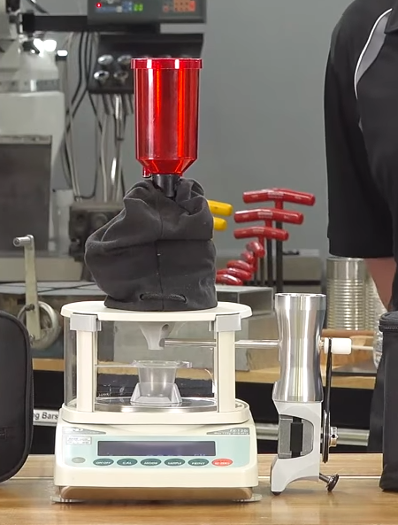

Based on this picture from his recent video with Ultimate Reloading, it looks like there's a new base for the trickler motor that has a 3-point contact setup and easily adjustable tilt via the single screw at the back.
Also, because the thrower portion is encased in a bag there may be other improvements he doesn't want to disclose quite yet or are still being finalized...
Also appears the drop tube portion for the thrower has been improved, no more bendy straw.
He says all the V3 stuff will be available as upgrades, so I would expect several incremental improvements. We'll see in a few weeks.

I also like that he changed to a glass measuring cup and ditched the bendy straw drop tube-- after dealing with static buildup on my old RCBS chargemaster where almost everything was plastic I'm not a fan of plastic for the powder cup or having a lot of plastic around the scale platform. If I kept my chargemaster wiped down with static-free endust everything was OK, but in the winter if static built up it caused false scale readings and drift. That's why on my own setup I built everything is metal and conductive to dissipate static-- drop tube from the Harrell's is copper, powder pan is aluminum & stainless, register for the powder pan on the scale bed is aluminum, etc. No static cling or drift.

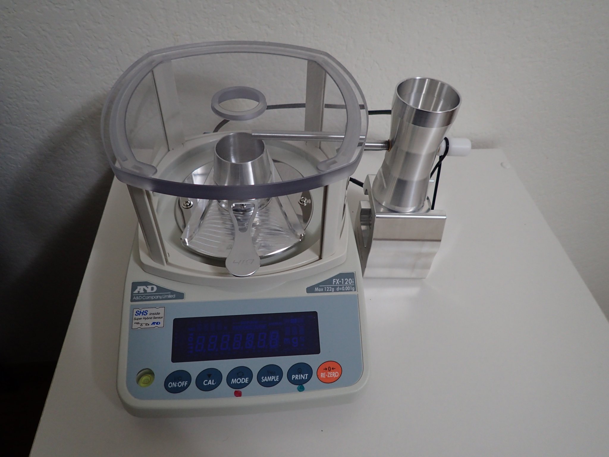

One thing he mentioned in that video is an issue I ran into when building my automated Harrell's setup. Since the Harrell's can cut kernels occasionally, it needs a lot of torque applied to "power through" a kernel if needed. If you didn't care about speed you could use a standard stepper motor with a very low drive ratio via gears or pulleys to provide the necessary torque, but then the cycling speed is extremely slow. My solution was to use a $125 high torque / high speed Hitec digital servo that had ample power to cut kernels but also be extremely fast (it can fully cycle the powder measure from handle up to handle down to handle up in <0.3 seconds at full speed, although that's actually too fast for the Harrell's to dump the complete powder charge especially if it's a larger charge.) Adam and I bounced some emails back and forth and decided the cost of the high torque / high speed servo plus the cost of the Harrell's throw was way too expensive for the targeted price point he had in mind for the Autothrow. He picked up the cheapie Lee throw to play with, and turns out that the Lee throw with the wiper doesn't cut kernels and thus requires much less torque to operate-- so he was able to use an inexpensive stepper motor and get the Autothrow to market at a much more reasonable price than my Harrell's based setup. Of course, the drawback of the Lee measure used in the V2 is it's a bit finicky and can leak ball powders, while the Harrell's I'm using works great with anything with no leaking and having the micrometer adjustment on the powder drum makes it very easy to instantly dial back to your preferred charge weight. The new V3 thrower looks like it will solve the ball powder leak issue of the Lee thrower, and be the equivalent of my Harrell's based setup in terms of performance at a lower cost.

A slight sidetrack... I've seen some pics over on Accurate Shooter of another automatic trickler setup that someone has built for themselves and is selling in small quantities that uses a Promethus-type "notched wheel" trickler so it can accurately dispense only a single kernel at a time without an overthrow as the rotary tube tricklers can, but I'll be damned if I can find the thread now. It was all controlled via a small touchscreen interface. Supposedly the builder is on a facebook group somewhere and has a waiting list. One of my thoughts to even further refine my modded Adam-based setup was to build a "notch type" trickler to add those last 4-5 kernels and never have another overthrow again. The process flow I imagined was bulk drop via the powder throw, trickler to within about 5 kernels using the rotary type trickler, then add the last 4-5 kernels with the "notch-type" trickler. I wanted to minimize the amount of powder dispensed by the final "notch-type" trickler since they're rather slow and I wanted to maintain the current ~6-7 second per charge speed of my current setup. Another one of those things that would be fun to experiment with but I haven't had the time for.

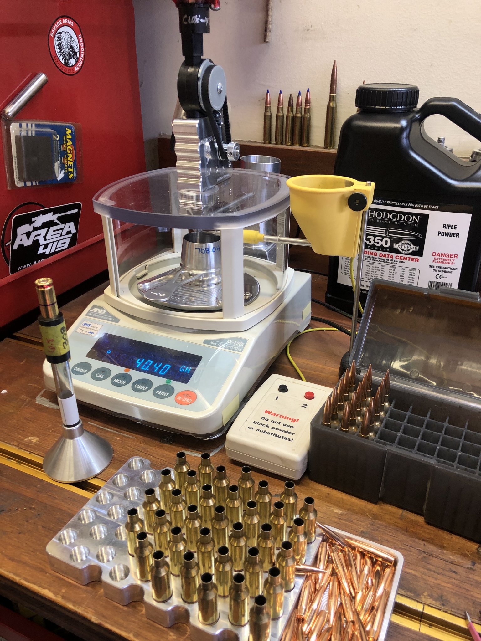

Loading last night
Dang now I want the V3
Ordered the board upgrade.. Don’t think the thrower will work with the Area 419 Acrylic top plate and funnel..

Loading last night
