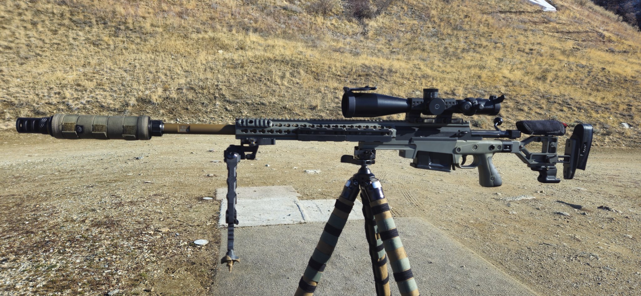

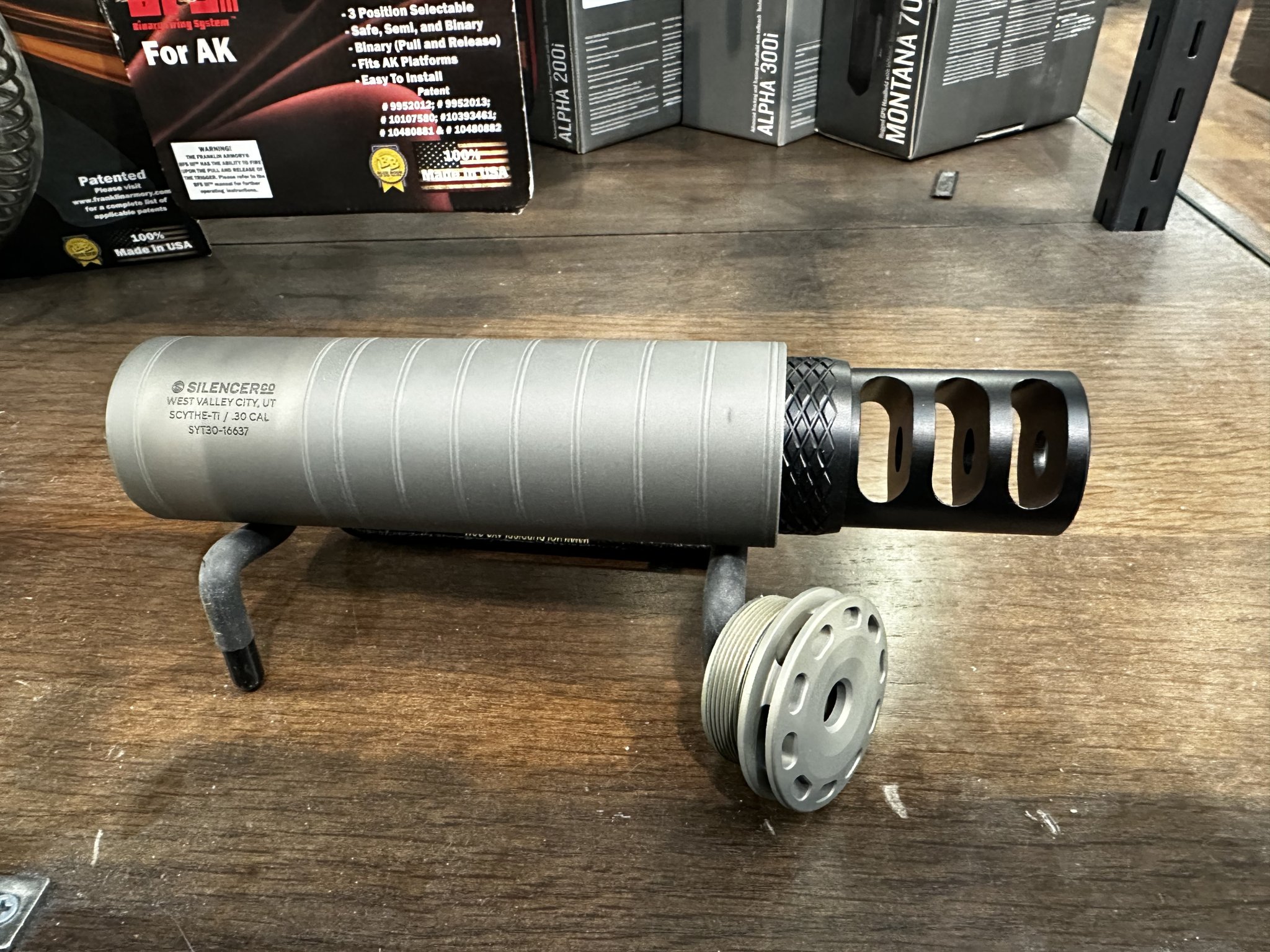

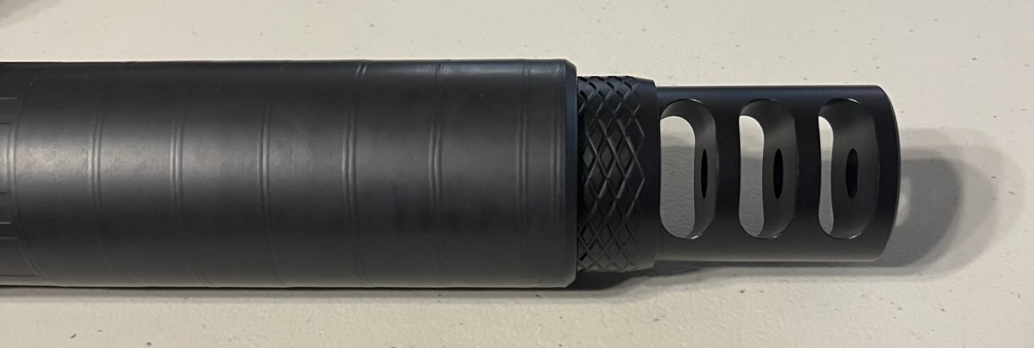

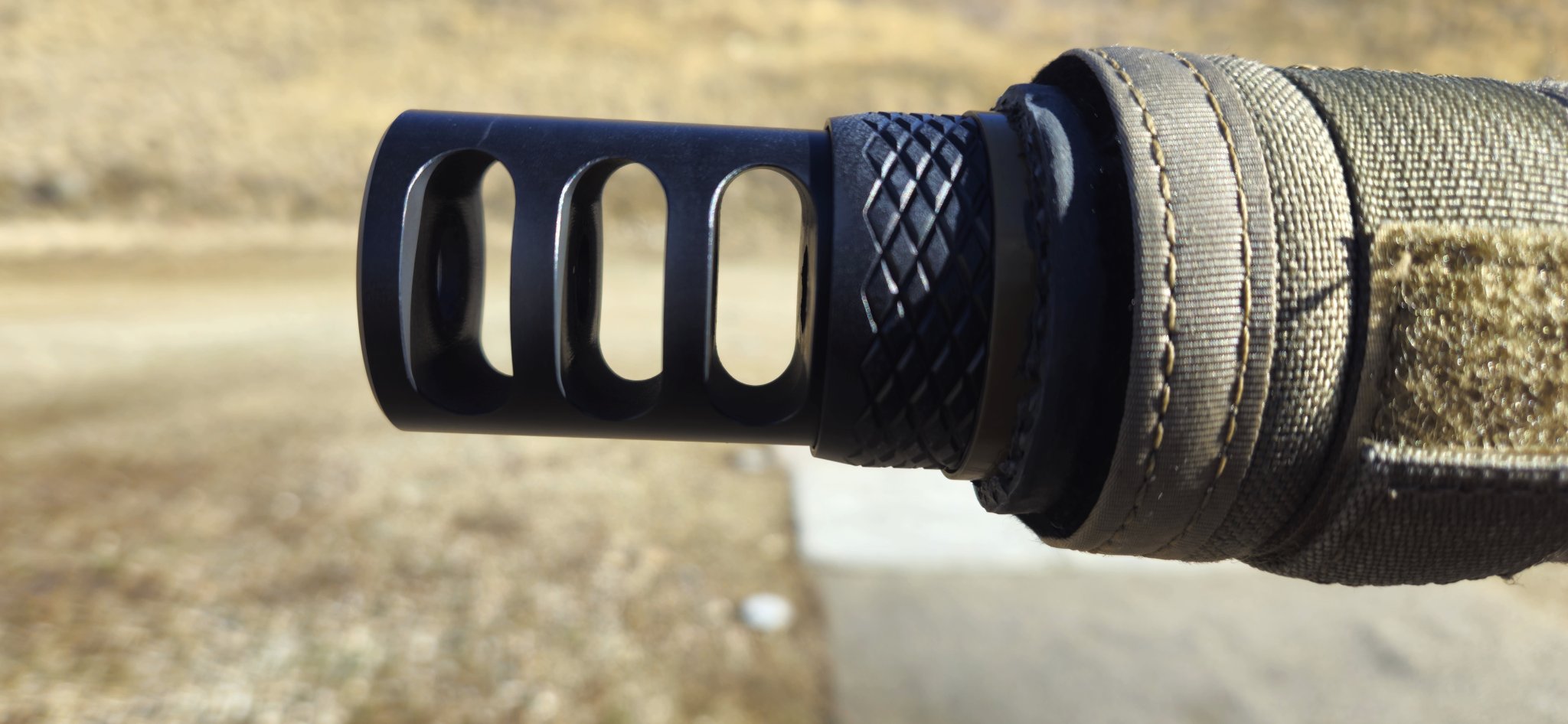

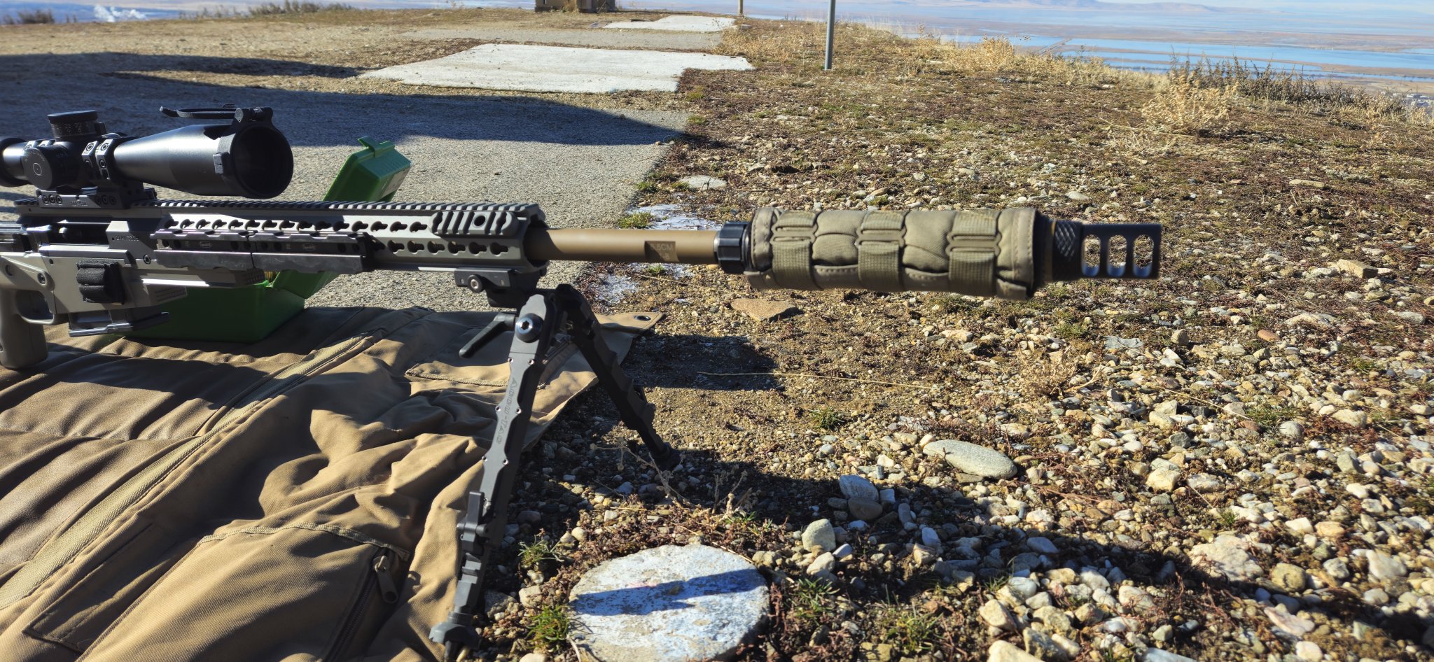

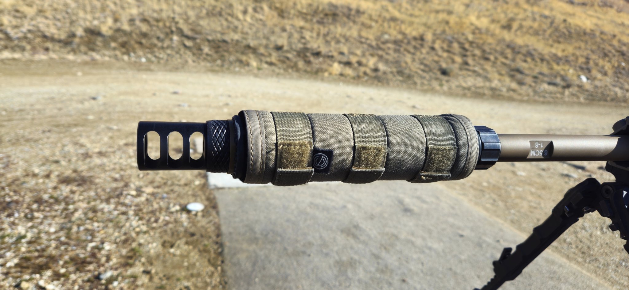

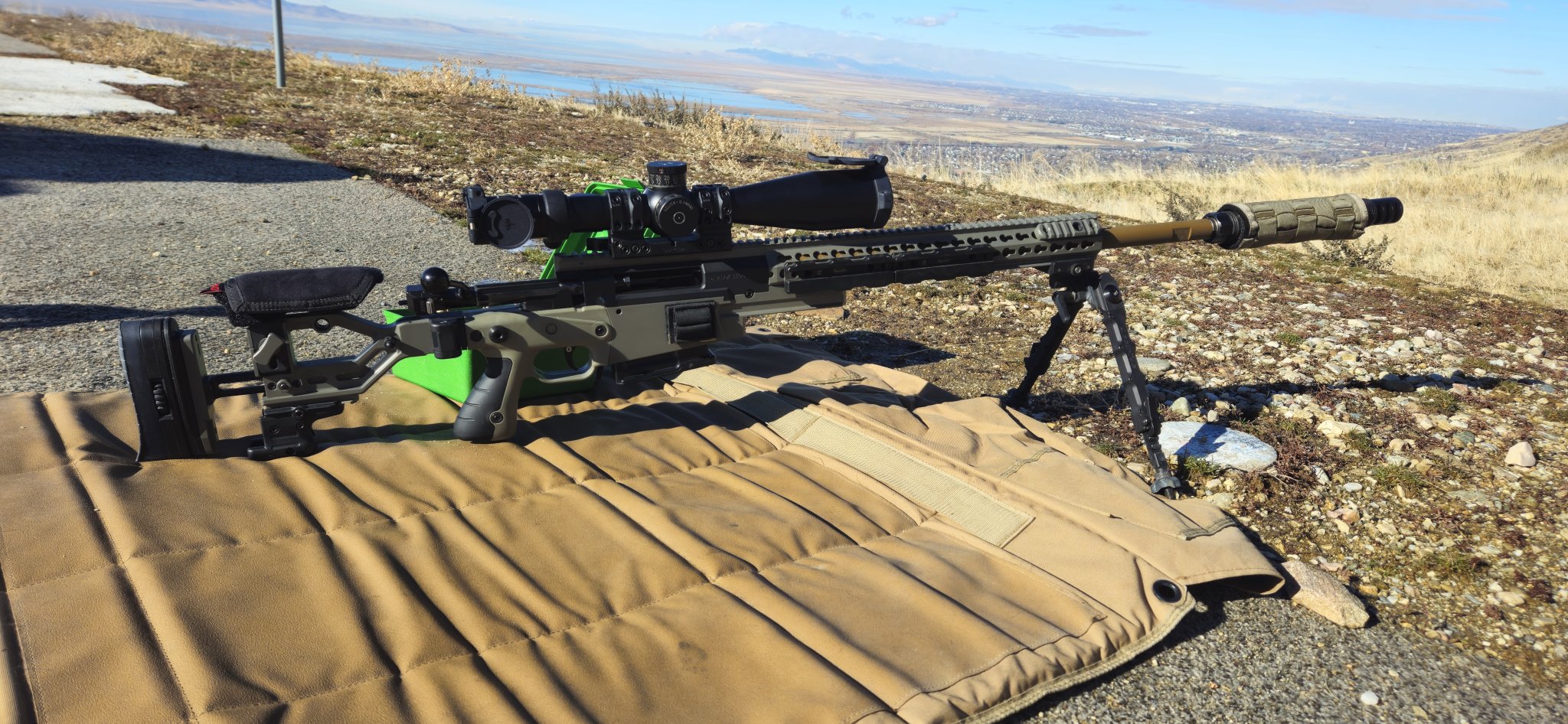

Shot a match with the owner of recoilx this past fall where he had one of his prototype units and it caught my interest. I had a chance to buy a unit this last week and took it up for some testing.
Overall it performs really well... obviously slight noise penalty but very effective. I felt like it was pretty close to the best of both worlds between shooting fully suppressed vs just a brake only.
I was able to stay on target in the glass through the full recoil off a few positions and can't wait to try it on a bigger 30 cal soon.
I was using a silencerco hybrid 46 with their 30 cal self timing brake.
On a gas gun 223 it had noticably less back pressure than just my front end cap alone which I thought was interesting.
Seems like a legit option for those of us with cans already vs buying something like the maverick straight up. I have been primarily shooting a tbac can but will probably run a can with a Recoilx brake on it this season.
Not affiliated in anyway with recoilx but I think the owner is a stand up guy from my interactions with him and I like supporting solid products from good folks.

How does the brake time and be at the proper rotation?

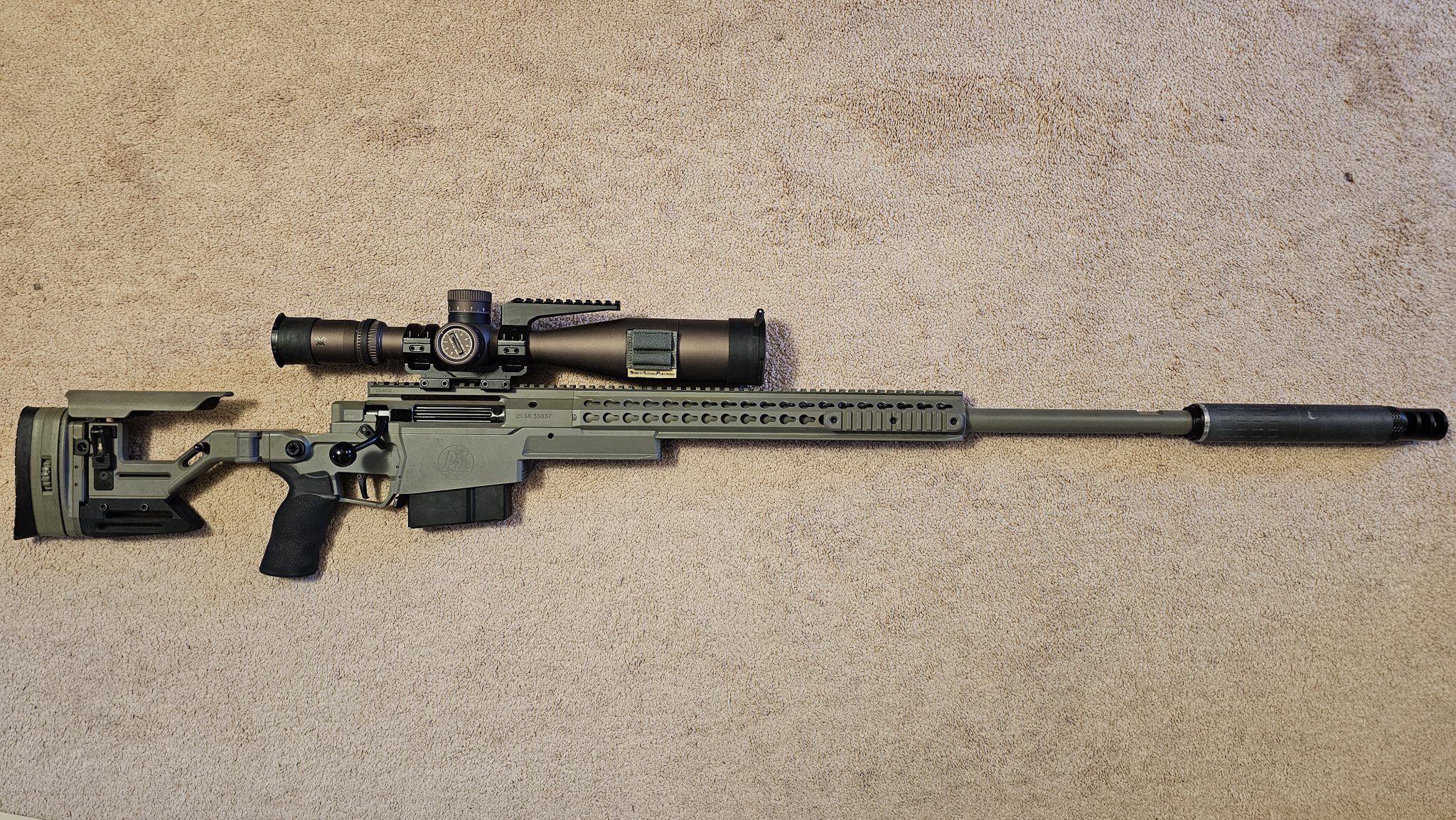

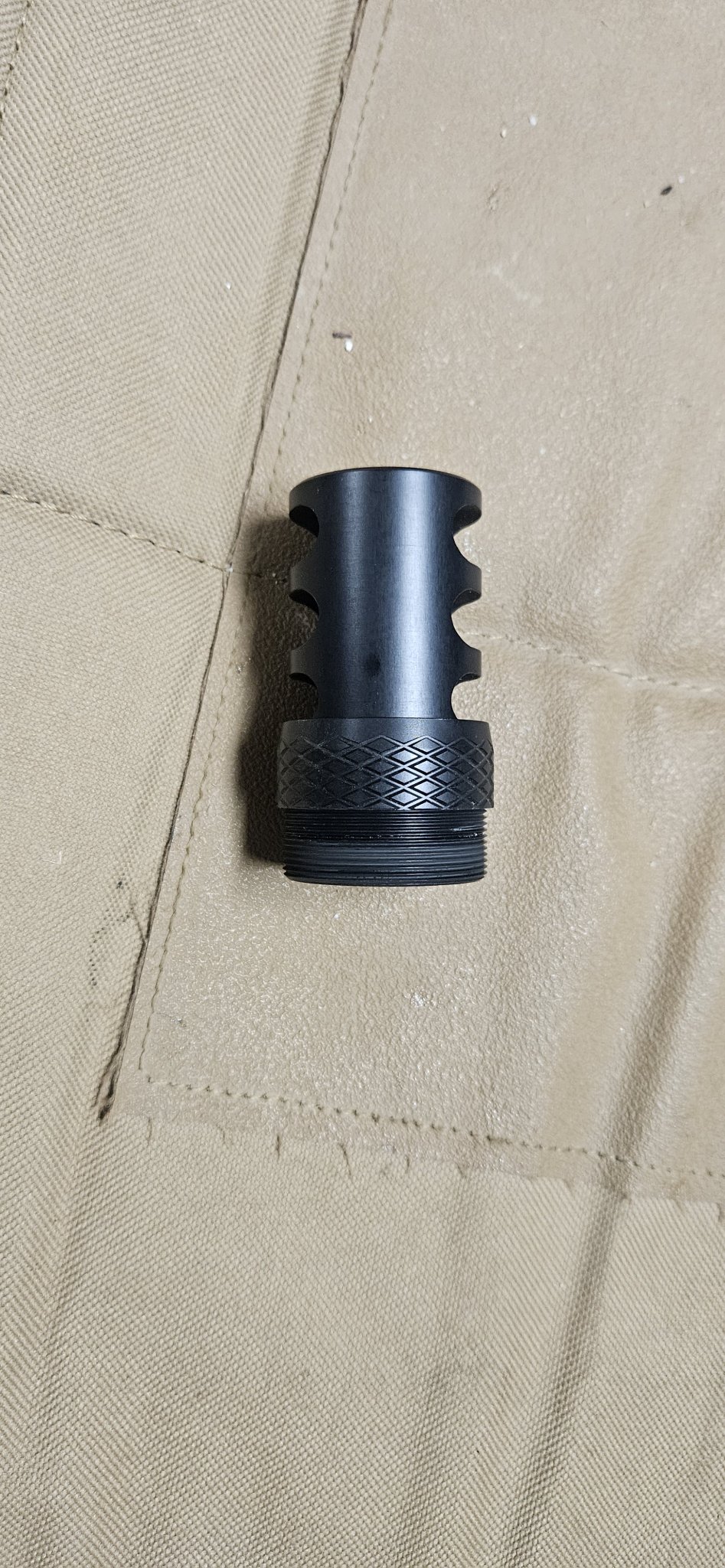

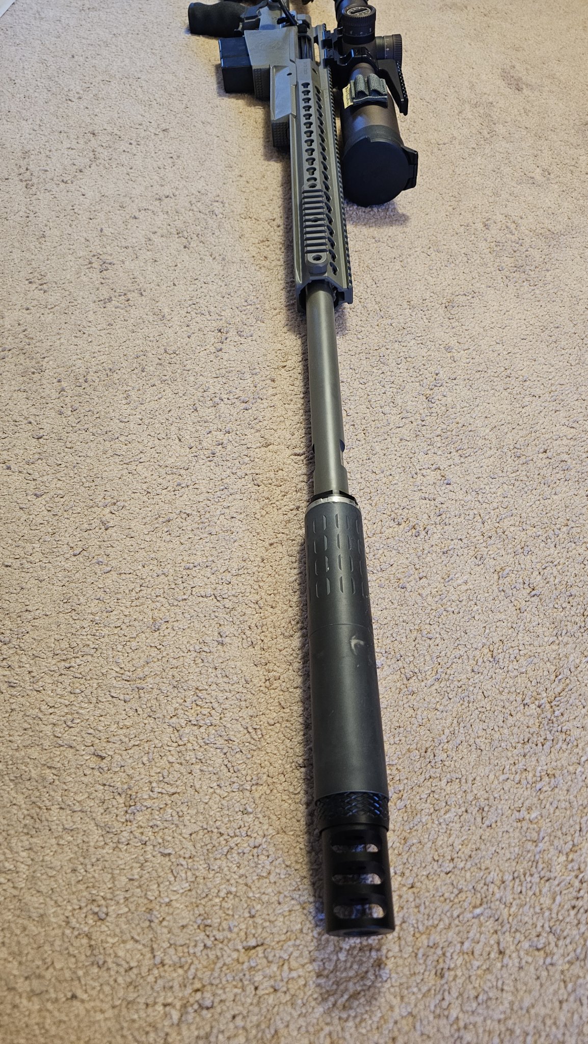

I haven’t verified for 100% if my Dead Air variant works on the new Dead Air XC. They don’t ship with all the tools to disassemble to verify on R-type. The thread sizes are 1-1/8x28, so if the R-type retains the same threads(visually looks the same) it should work. During testing for recoil on a 300 WM weighing 9 pounds, spotting shots have been possible on bench and off tripod.
Shooting Berger 215’s at 2900 FPS with Diligent Defense S-Ti and Recoil X brake.

@RecoilXBrakes What kind of endurance testing have these been put through? Any plans to offer something in 17-4 (or similar) vs aluminum?
I have shot thousands of rounds on uncoated aluminum prototypes. From .223 up to 300 NM(on multiple cans) and no signs of fatigue or failure have presented themselves. Most of the testing has been with 6ARC, 6.5 creed, 6.5 PRC, 7SS, 7PRC, 300 WM, 300 NM. ( amongst a few others )
The decision was made for aluminum due to the weight. The suppressors higher strength materials take all of the pressure and slow and cool the gasses down. The brake then diverts those gasses like a conventional brake would do on the muzzle of the barrel. It’s quite surprising how much gas and how quickly it comes out of a very effective suppressor. The type III hard anodized aluminum is plenty strong enough from what we found in our tests. (Almost a year of testing) For another types of materials, product would have to cost more.(could be an option, just not right now) Titanium would be sweet, but would end up costing double.
