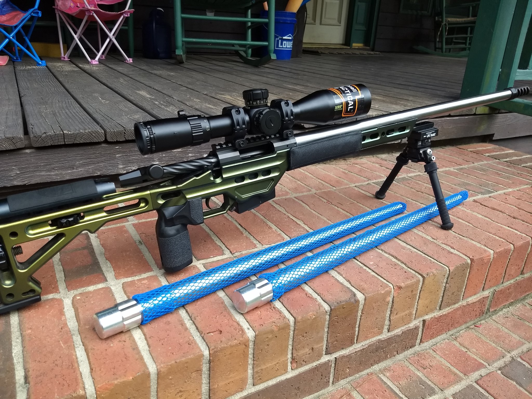

Here's a pic of my vector with three Dasher barrels, getting 308 and a 6.5x47 chambered soon.

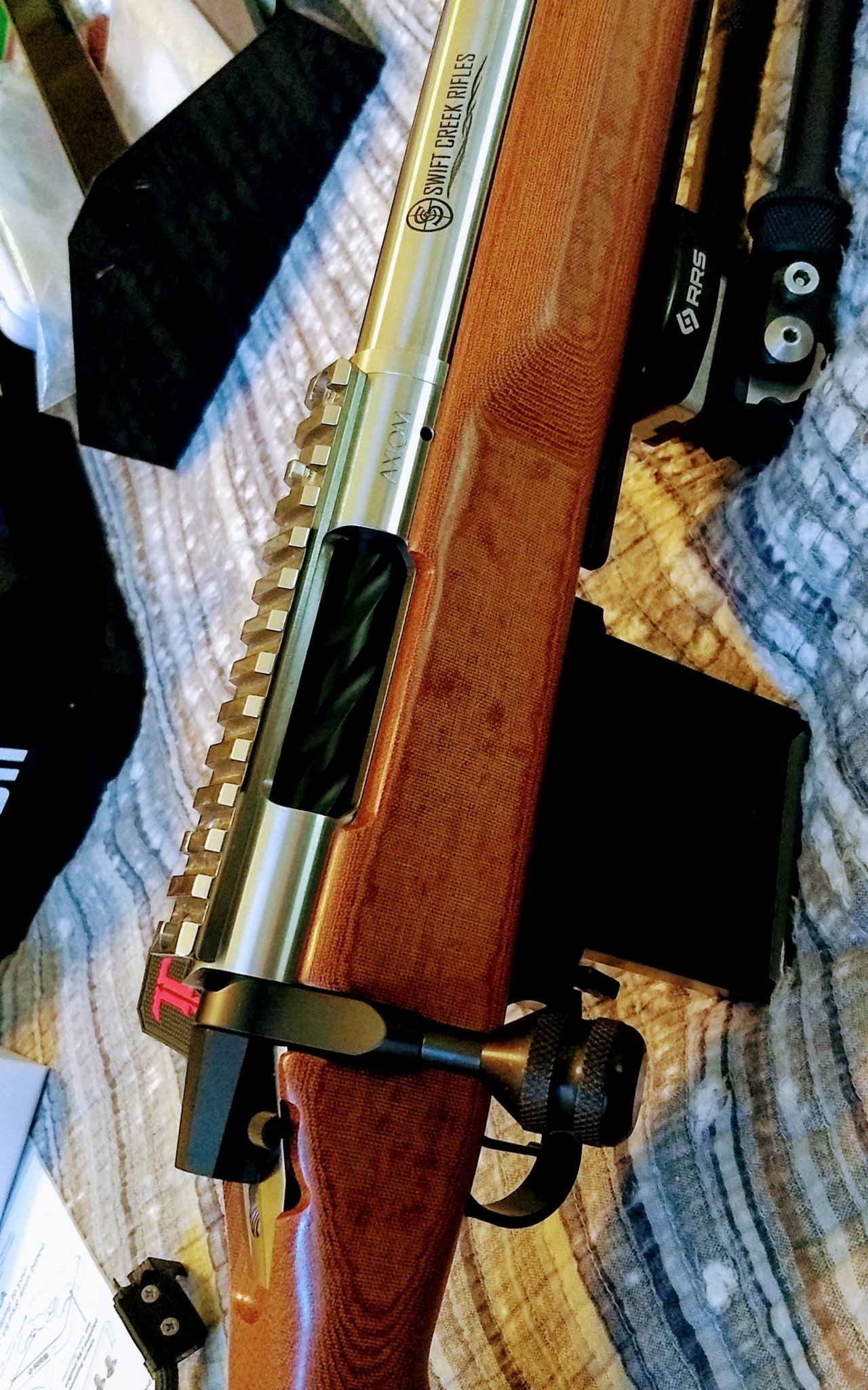

Here is pic of the Axiom in my newest rifle, a Foundation micarta stock, 6.5x47, TT diamond, Bushnell XRS 2..
