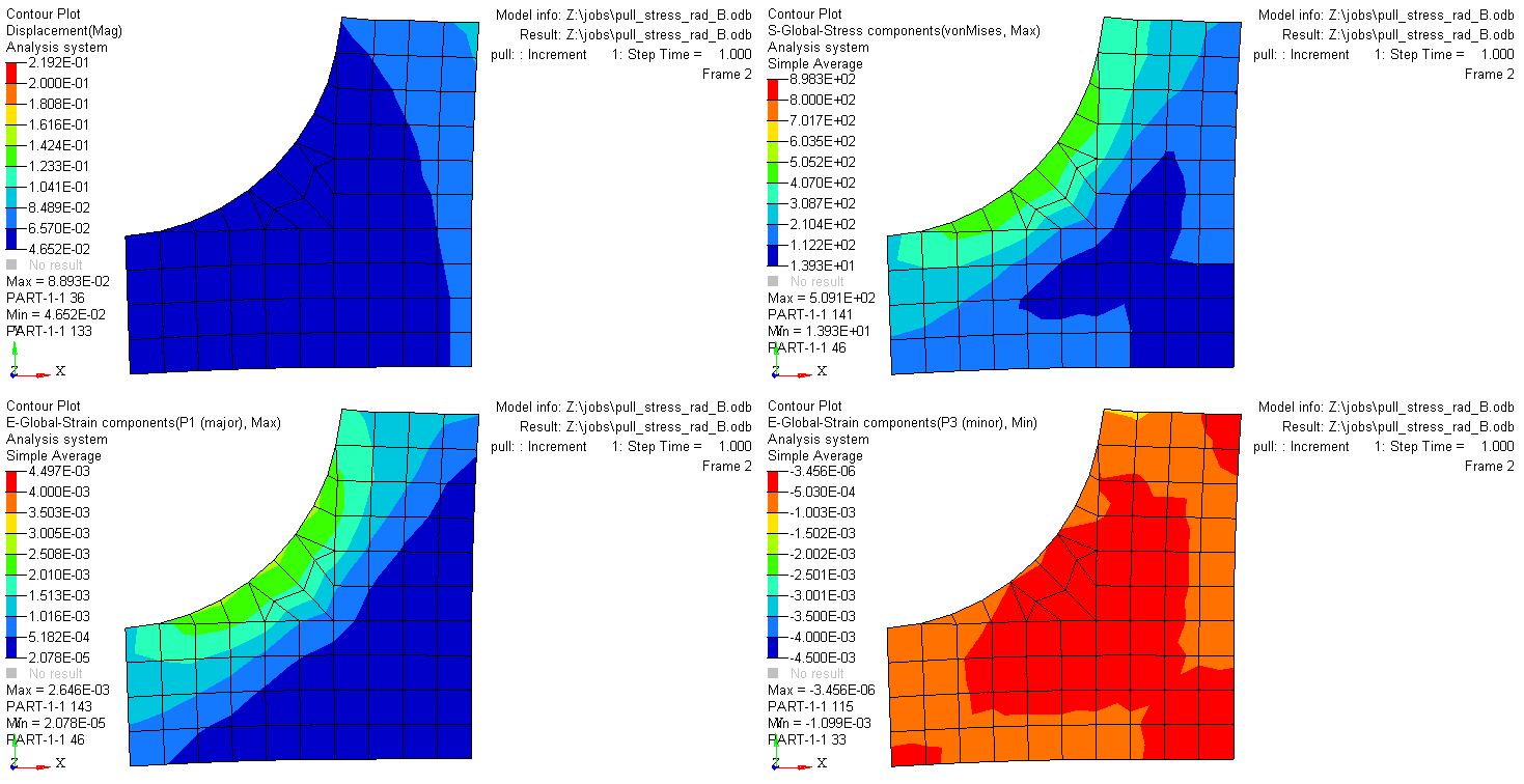

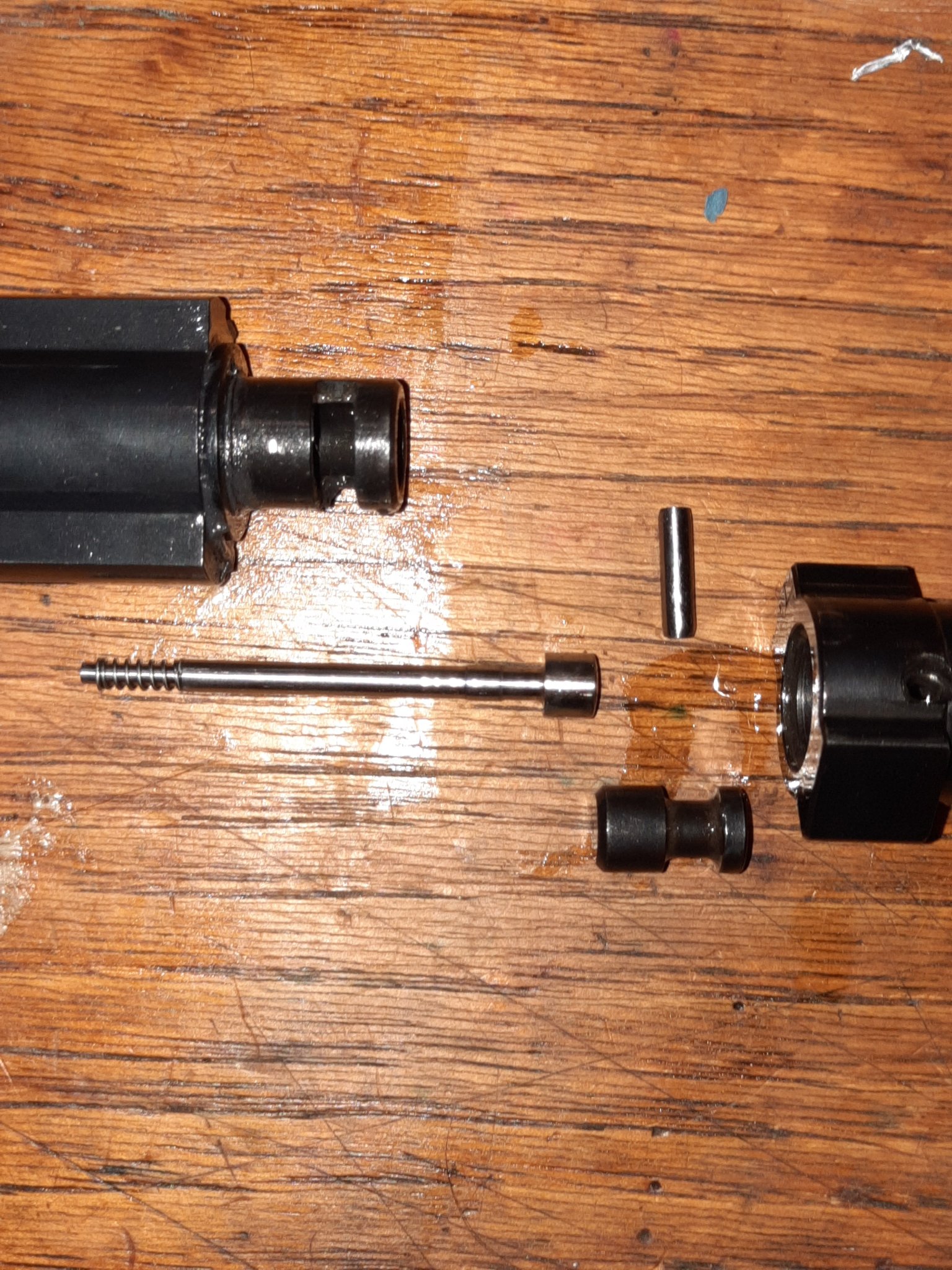

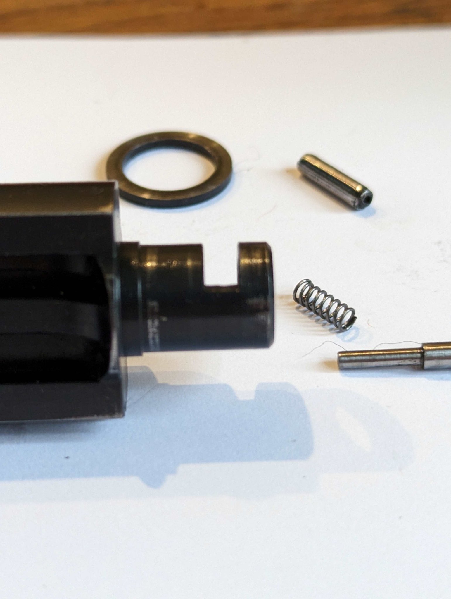

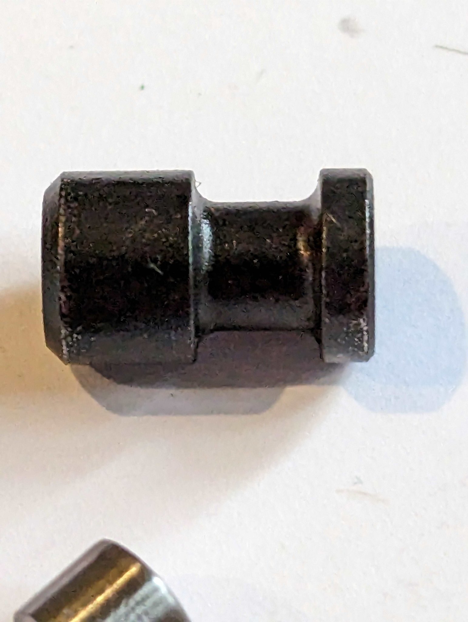

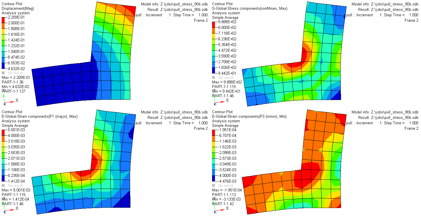

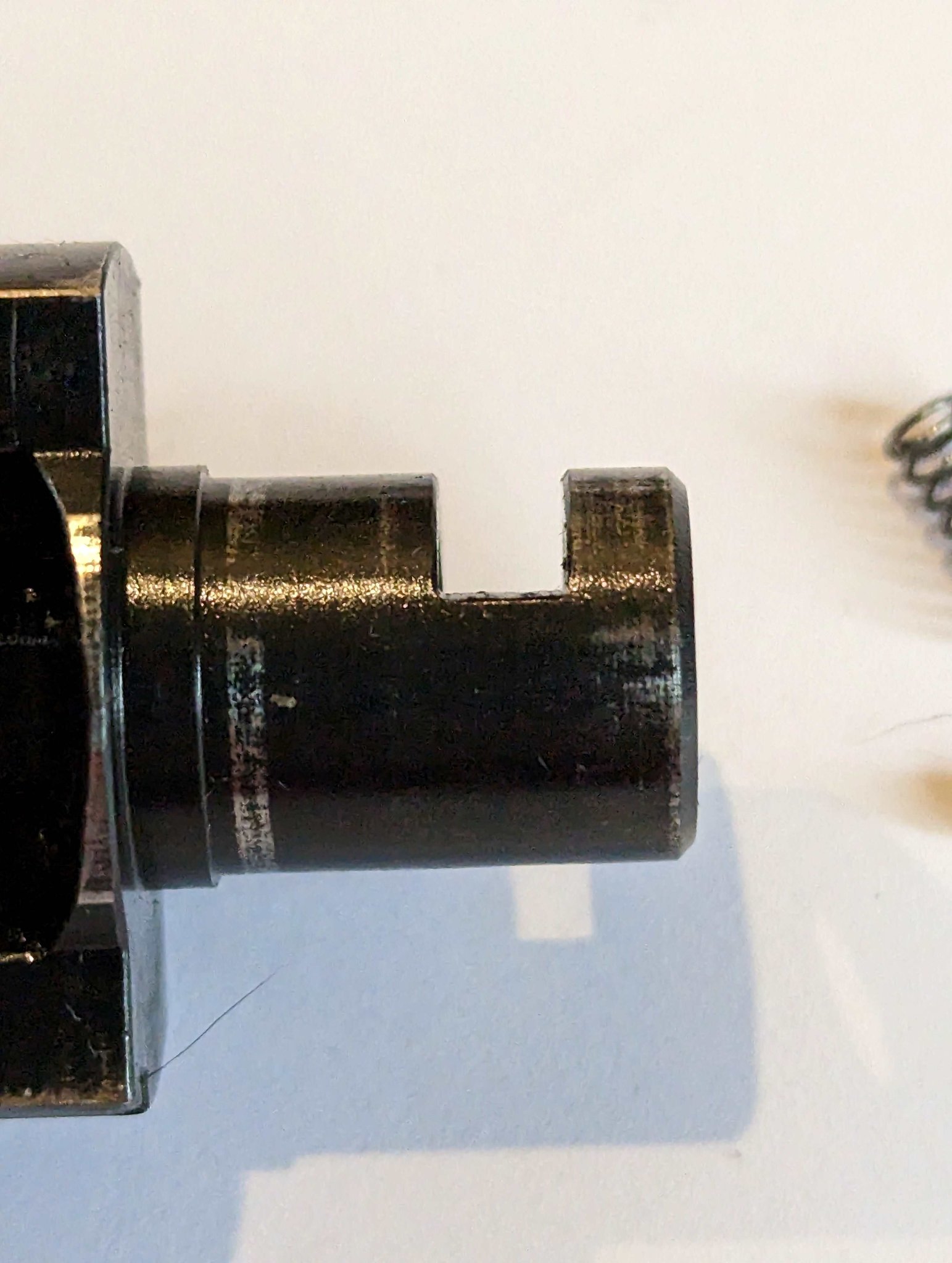

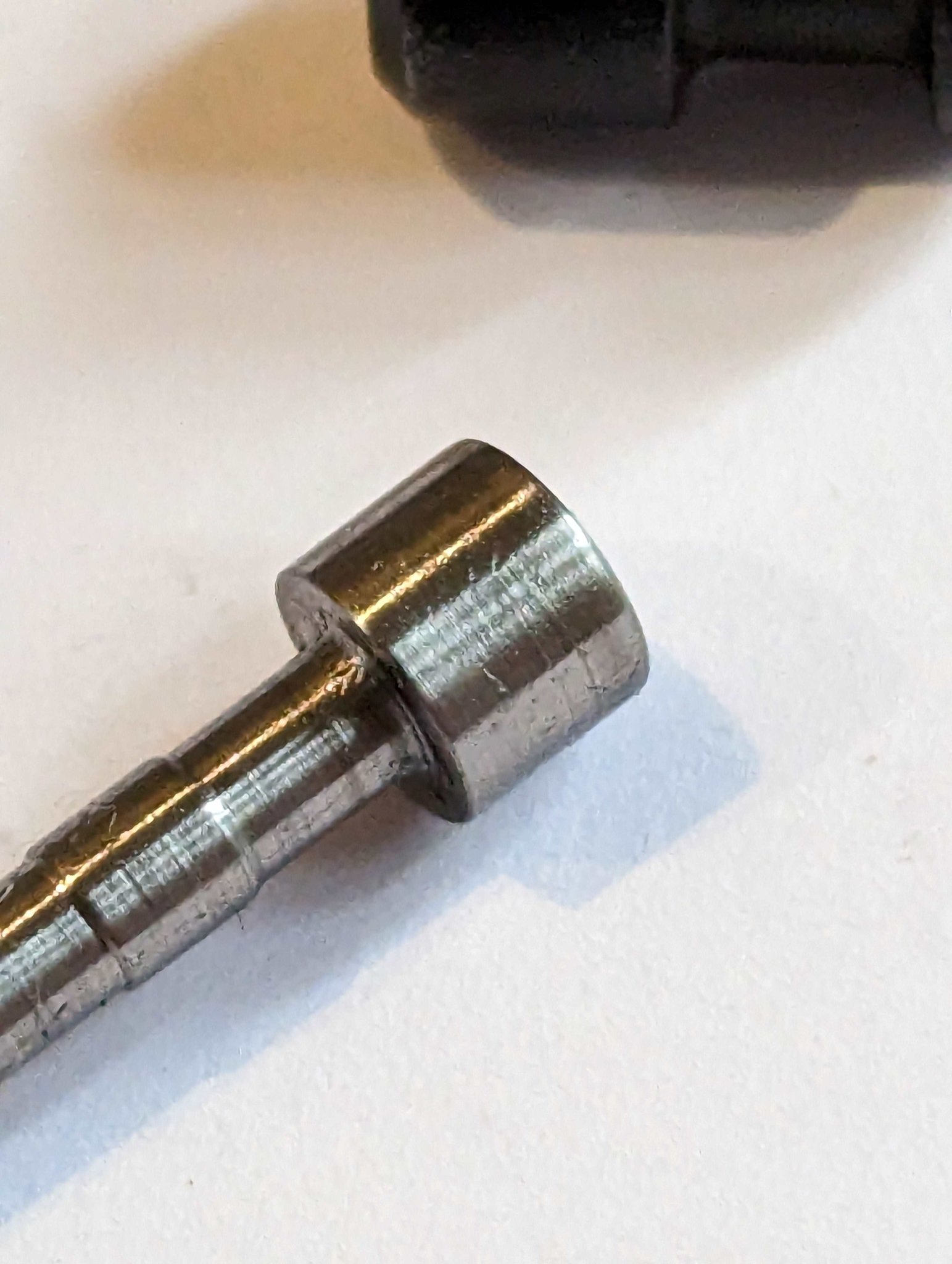

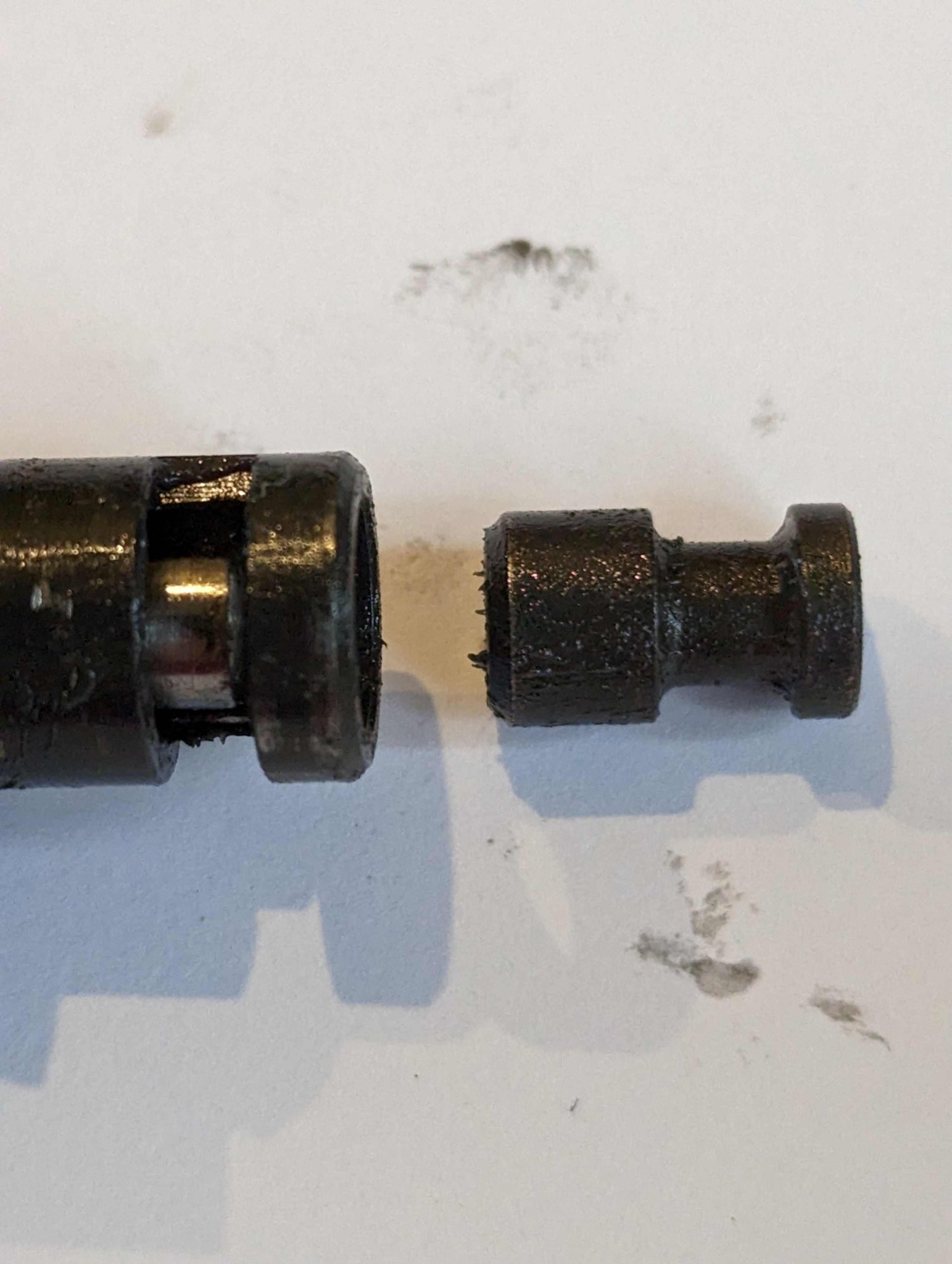

Pom, Im glad you asked. It forced me to search my files and fix them. From my file extension, I can see that
my rifle was 2020 or prior. If you disassemble your bolt, you will see a square cut like my 2020 or a revised round bottom cut. Square cuts should be avoided because they lead to Von Missis stress concentrations that lead to failure due to high stress in that sharp corner.
In the B14R design, when the bolt is withdrawal usually with some authority to eject the spent case, the large black
front section hits the bolt stop, but the rear handle section tends to continue because the human is still pulling on it. That energy gets transferred to the thin side of the square cut out, and into the sharp corner.
Bergara replaced the square with a proper radius at some point. Image #4 shows what I refer to as a Dog Bone.
Take note of its radii. It's a heat treated, high stress detail. #5 has small radii as it transitions from the large to small
diameter. Just for fun, I have included a sharp corner FEA. They are great tools to put the customer at ease since anyone can look at the pretty colors and get a feel for what's going on in the design.
Shawn

I have one of early models with over 5K rounds through it with no problems. It doesn't like Eley match (misfires) but eat Center X with zero issues.
Bergara has had failures at the sharp corner, and it is a very poor design practice. But my 2020
has never had any issue at all. She was a great rifle, or I wouldn't be looking at another one.
This FEA shows a proper radius to minimize corner stress. It's all a very pleasant blue and green.
Radii need not be large to avoid the Von Missis stress concentration.

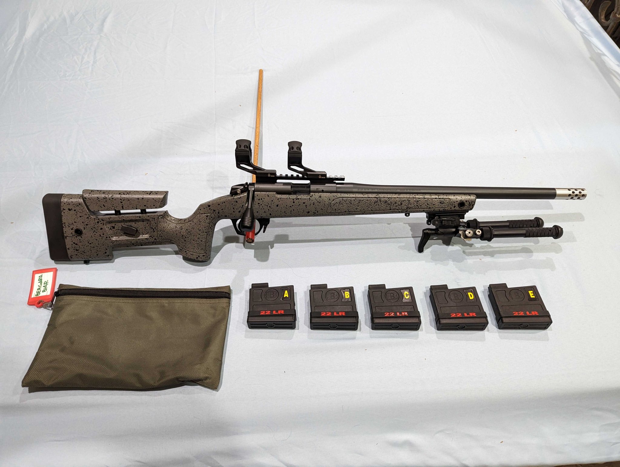

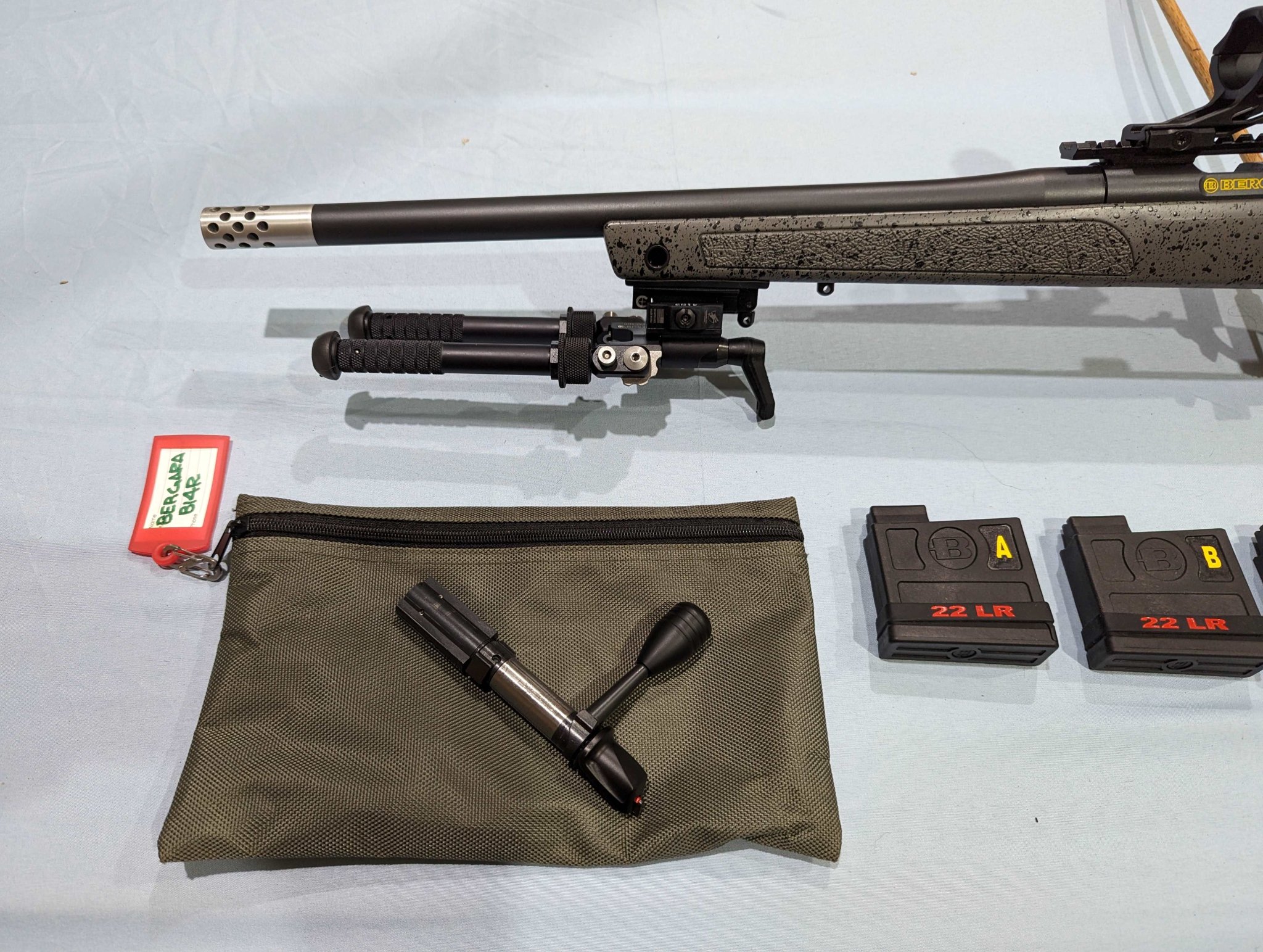

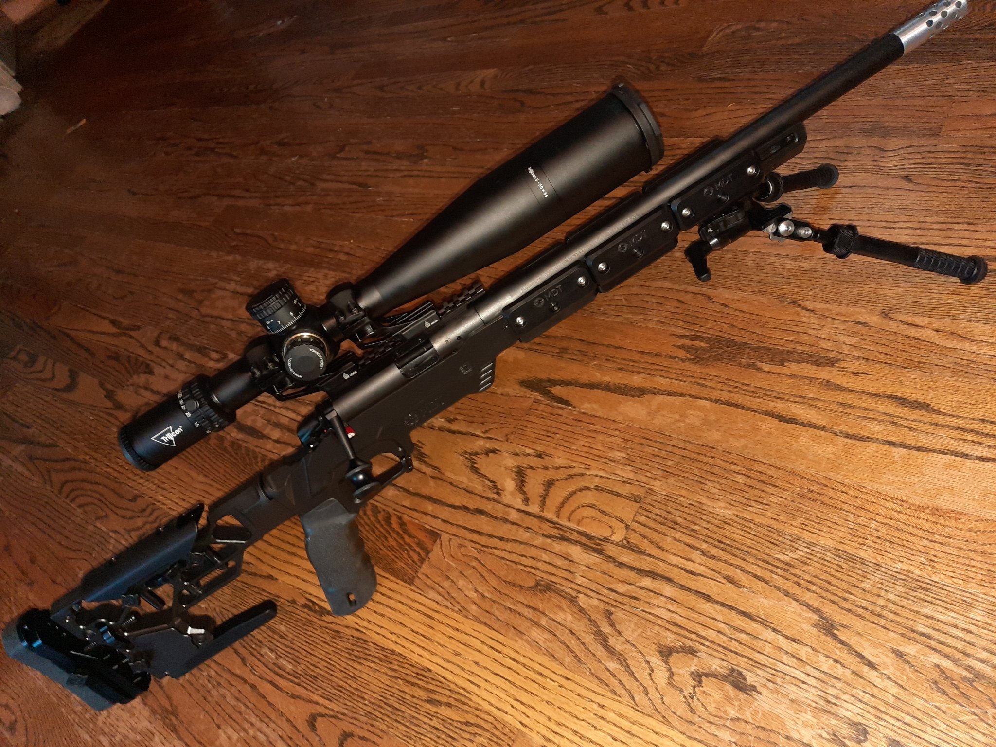

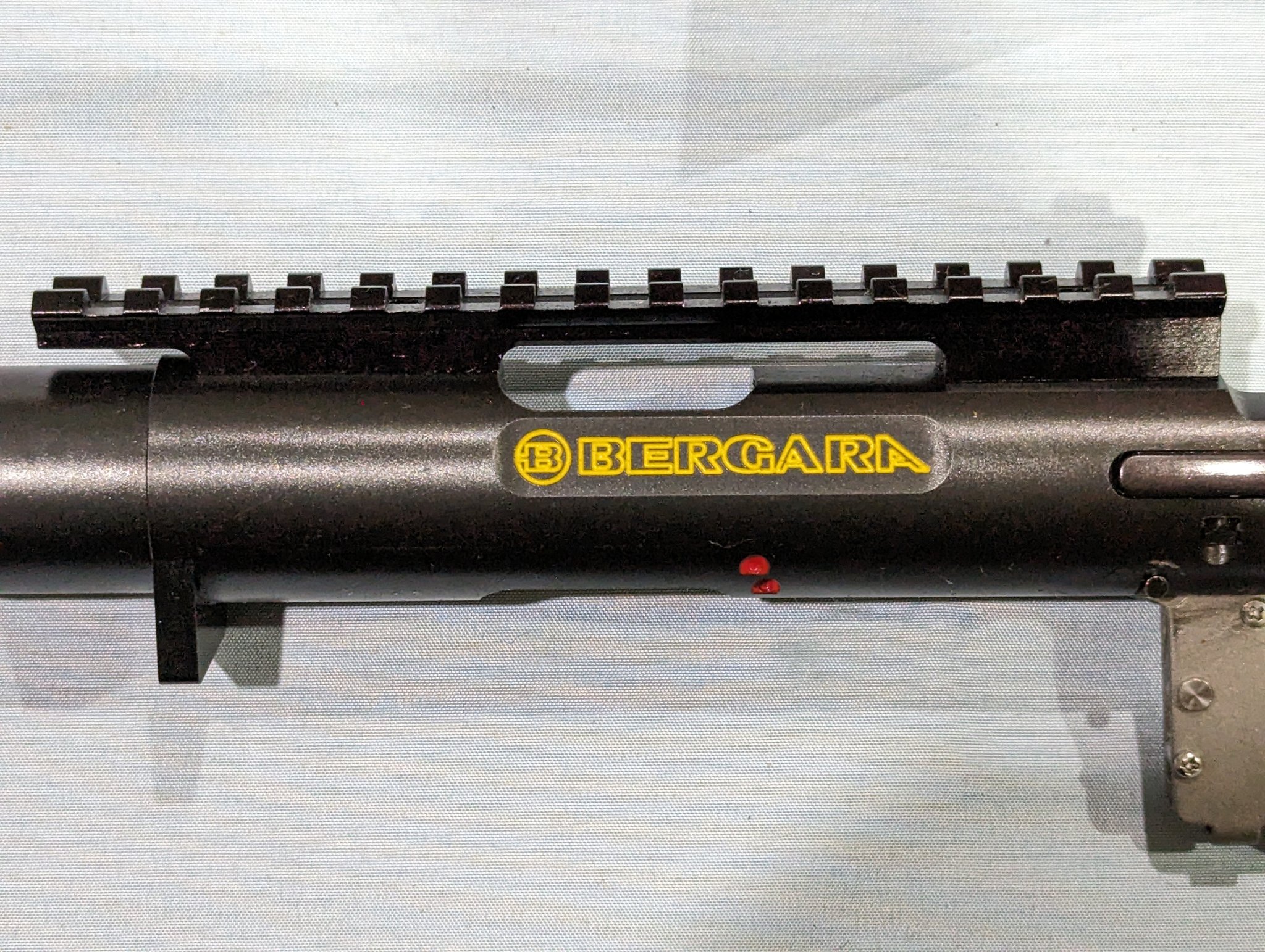

Image #4 is my B14R in my MDT LSS Gen 2 chassis that my V22 normally lived in. I also installed the Trigger
tech Diamond. The cool but $$ chassis didn't help with accuracy at all. The TTD trigger is very nice.
Given the choice, I would really like an IBI, 22" Shnooble barrel like image #3. I like the swell at the muzzle.
If memory serves me correctly, image #2 shows the correct orientation of the internal bolt parts. The shim
spacer is already on the black section of the bolt. My rifle was factory stock with no mods. The ejector did have
some lash, ( wiggle ) of about .003 side to side and about .020" for and aft. If the case pulls the ejector rearward
at the moment of ejection, why would I care if it moves?
Well I'll be darned, just checked mine and the bolt stop sure does impact on the bolt nose. I hadn't thought about it before and just assumed it would hit the locking lug instead. Still need to disassemble my bolt to see if it's properly radiused but at this point after thousands of rounds it's probably fine.

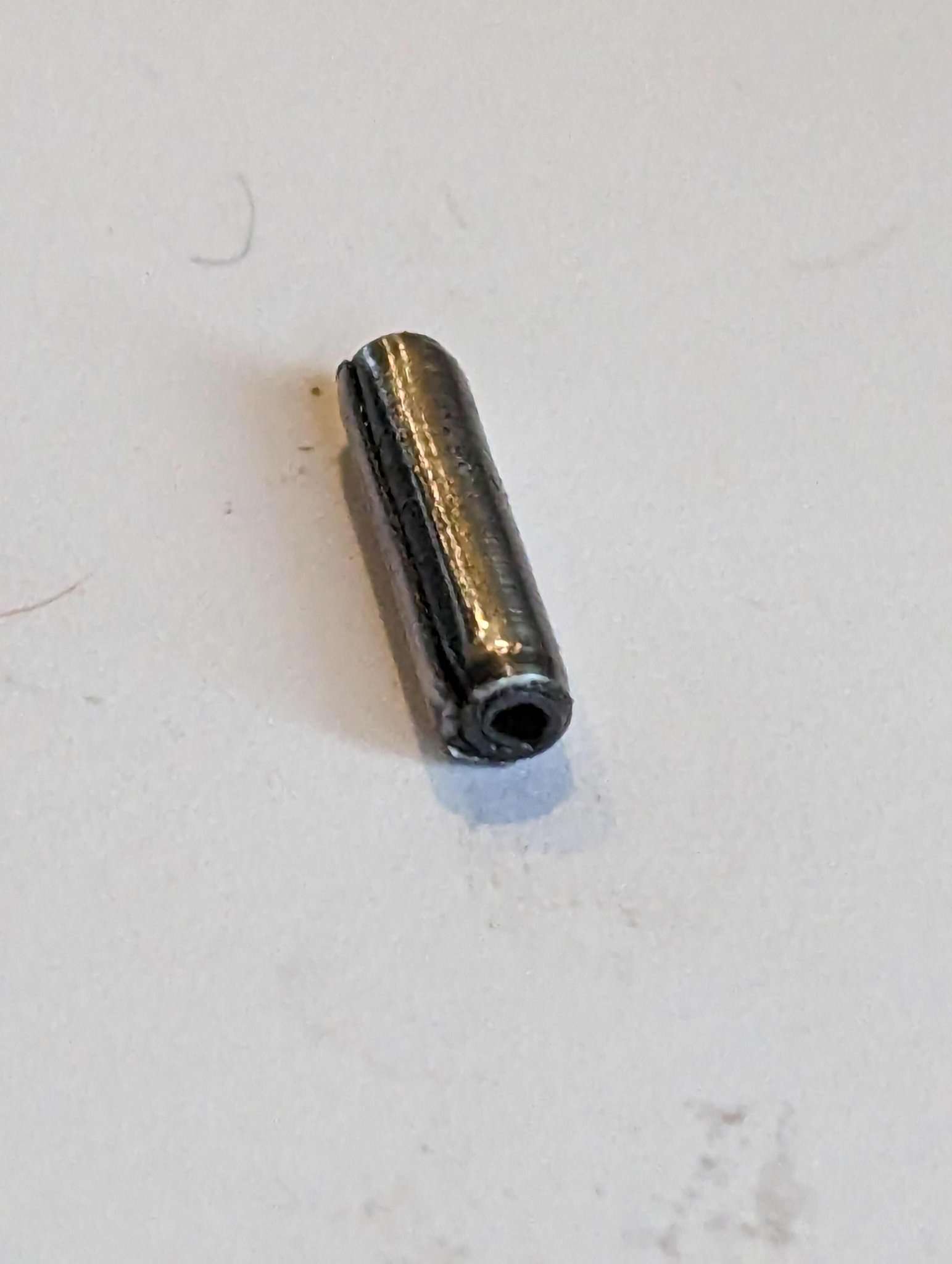

I staked my ejector in my first B14R. It solved 80% of the dropped casings. On my next days off I’m pulling the extractor on the left side (weaker of the two by design) and dropping a 9/64 detent ball I have left over from modifying savage extractors in there. If it will fit that is.
That should solve the extractor issue completely based on recent reports. I’ll pull my 20” heavy bolt extractor and do the same

I have found this eliminates the hiccups of failed ejection. I have modified numerous bolts this way for myself and friends at the range. All noticed improved empty case distance upon ejection, and none have had a hiccup since.
Most of us use an elastic cord "rubber band" on the bolt handle to comb pillar due to bolt movement during NRL PRS transistions, this keeps the bolt back prevents forward movement. When using a band, ejection is completed by the band flawlessly.
Now all this said, I have read where one person used a 3mm ball bearing under the tension lever, same idea, increase tension to hold the case firm.
My 2024 action required no mods whatsoever. Bergara has improved this action since introduction on a continuing basis, the forward bolt part in many ways. The tension lever is slightly different under the hook, the spring appears stronger, and the hole the tension and extractor pins go in are now counter bored so can't protrude above bolt body, to name a few.
I have heard Bergara will send out new tension and extractor levers with springs and pins if requested. The double spring method I use is quick, relatively easy, cheap and no time waiting for parts.
I have posted all this previously in many threads, but here it is. I hate to see someone with a B14R with issues, they are a great rifle. Yes I have read the horror stories, but crap does happen at times.
Try this spring mod and let me know if things don't improve. I would be happy to do it for you if you were close by.
