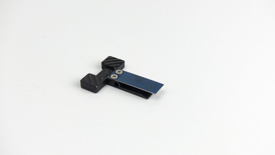

Wrong latch?
Please select our LA Latch/AW version of you plan on strictly running AW magazines or are using a 22LR. The latch is taller and helps the magazine ride higher in the magazine well for better feeding. Accurate & MDT 223 Magazines, and Vudoo Gunwerks users will also want to pick our AW/LA latch version.
