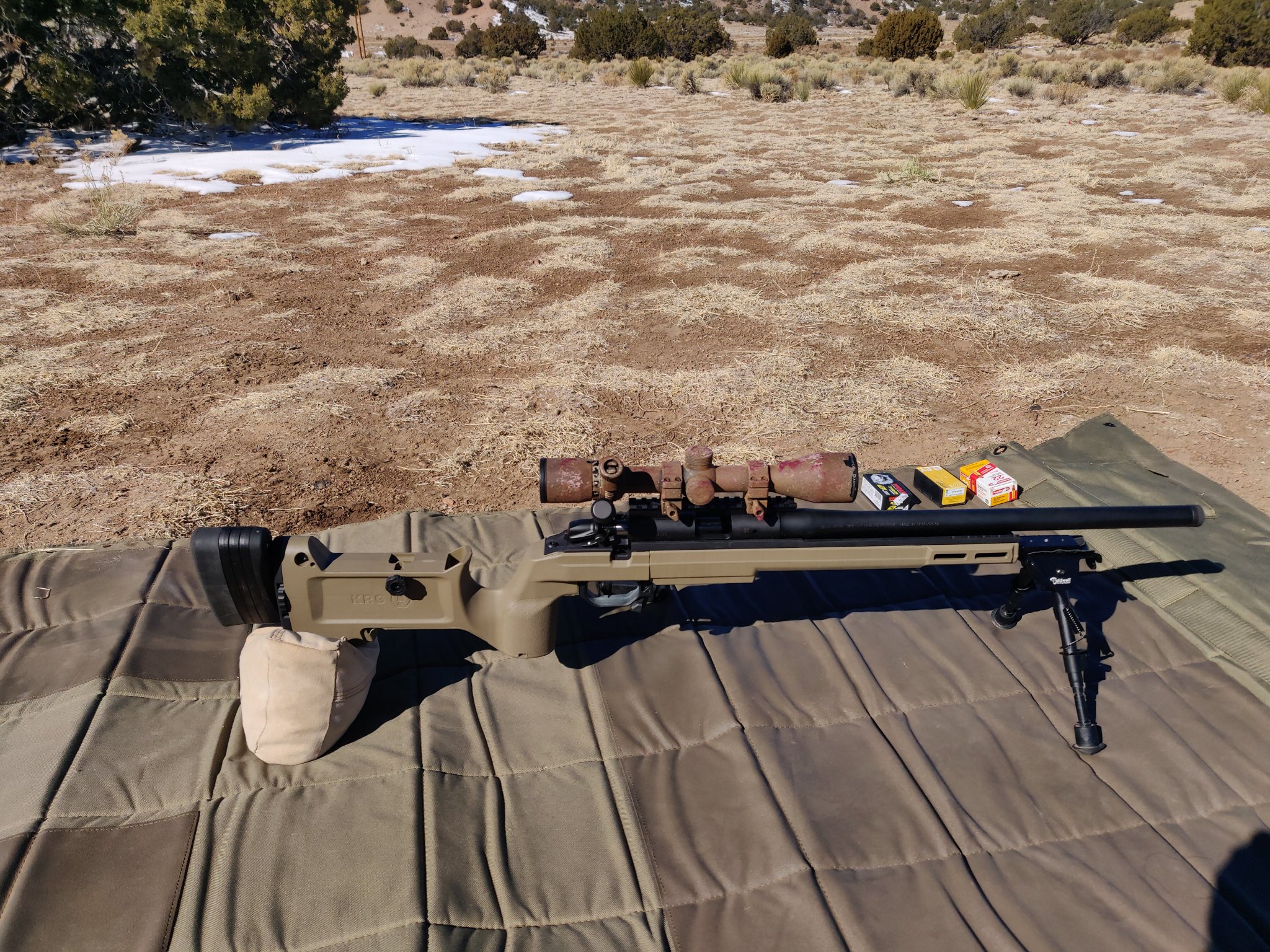

I'm wondering if anyone has diagnosed or solved this issue, my bolt knob takes kind of a lot of pressure to close. I'll review conditions below
Also bergara said I can send it in but no idea really not something the guy I talked to had seen.
As much pressure to close as it does to lift
Feels like I'm really "camming over"
B14r steel BA in Krg bravo, factory trigger with adjustment screw removed, mag in or out no difference , loading rounds or empty chamber no difference, in chassis or out no real difference, first time or cycling the bolt without pulling the trigger no difference.
I've dry fired (with drywall snap caps) probably 50 times? And fired around 200 live rounds as well.
I added some lube (I almost exclusively use mobile one euro formula 5w40) but didn't yet clean out the factory grease.
Things of considered doing, removing the trigger and testing, cleaning out all the factory lube and going heavy on the oil relube, removing the trigger and just lapping in the bolt lugs with compound 800, 1200 and then flitz polish, breaking the leading edges of the bolt faces with a stone, or just ignoring it and shooting it.
What would you do? Or did you do?
Lead time at bergara is around 45 days and they said they would send return label etc....
Pic for attention
I didn't have tools to lower my cheekpiece collars so I shot with a chin weld for this day

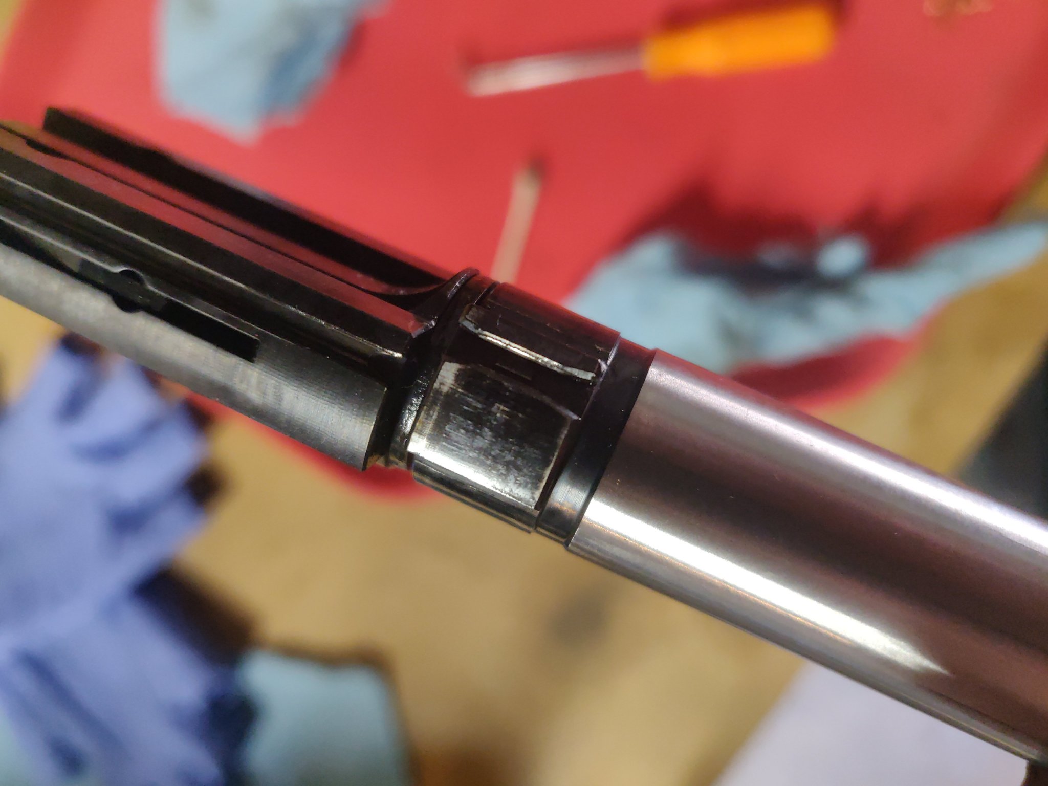

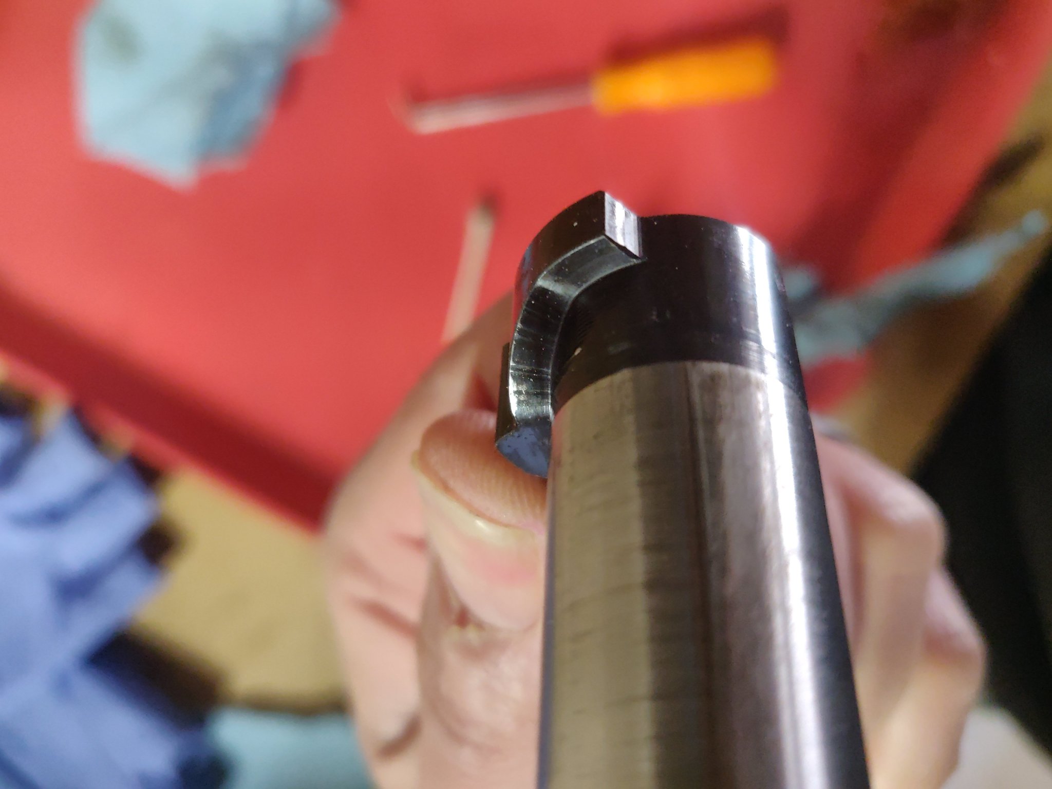

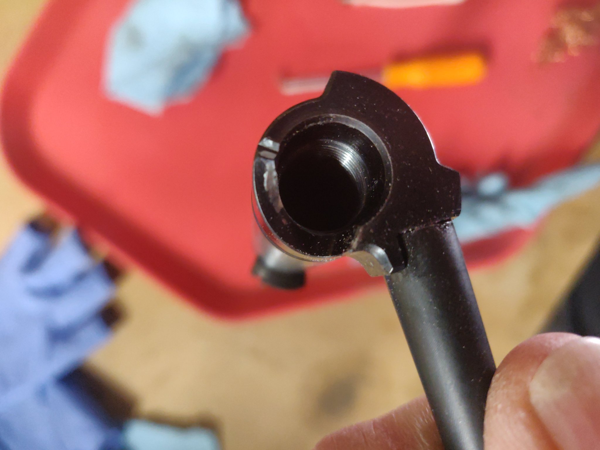

Well to remedy the issue here is what have done so far.
The headspace and bolt itself don't have any affect on the hard close, without the cocking shroud the handle falls on it's own weight.
I did completely strip the factory grease (kinda dirty and manky looking) and relubed with hoppes in some places and a gun grease in others.
I also found that with one turn out (less pretension on shroud) I got a slightly lighter bolt closing and, by eye, the same strike mark on my snap caps.
I did also notice some sharp points on the various ramps and ledges on the shroud, and also some rough machining, skips? Chatter let's call it on some flats. (I don't know all the technical names for the prices) lastly I saw some of the coating or bluing coming off of the various interacting surfaces.
My plan is to run it for a while like this and possibly try one more turn out on the shroud once things wear in to each other and I find ammo this rifle shoots well. Then I can hopefully tune the firing pin to the minimum force required to consistently ignite them.
Hopefully this helps someone and I am glad I don't need to
order any parts at the moment.
Bergara gave me the impression they wouldn't replace any parts they could tell I had worked on so may call for a price check before I stone, trim, or polish any of the working pieces in/on the bolt.
Reactions: MrMojoDiver

I polished the ramp on the bolt that the cocking piece rotates on, and polished the cocking piece.
For the trigger, I just replaced it with a Bix N Andy using the low sear.
I’m pretty sure the cock on close is just due to the fact that the cocking piece is getting pushed rearward by the sear as the bolt moves forward while it is cam-ed in. I’m guessing the MIM cocking piece is made on the long end to make sure people don’t have issues with random triggers.
Overall it’s not terrible. The bolt is slicker than I expected and the notchiness and COC aren’t even noticed if you run the bolt fast.

I have an older bergara and when you close the bolt slow you can watch the firing pin go down then back up a little as the bolt handle body / ramp sets the cocking piece on the sear ( there is clearance ) while the bolt lugs engage the lug recesses and pull it forward , it feels like it is partially cocking the firing pin to many people
I believe the timing is off

I’ve read that and have looked at the rear of the cocking piece as I close. It does lower very very slightly at the start of close, but then cocks an additional amount. Once closed, cocking piece is rearward an additional 0.055” compared to what it is after opening the bolt.
