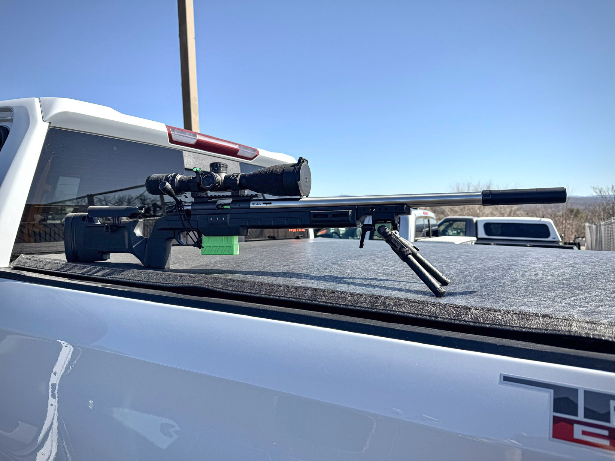

I have a B14R heavy and it balances pretty well, but it is still ever so slightly rear heavy in my KRG Bravo. I am looking at getting a few external weights for the front or just upgrading to the aluminum forend on my bravo.

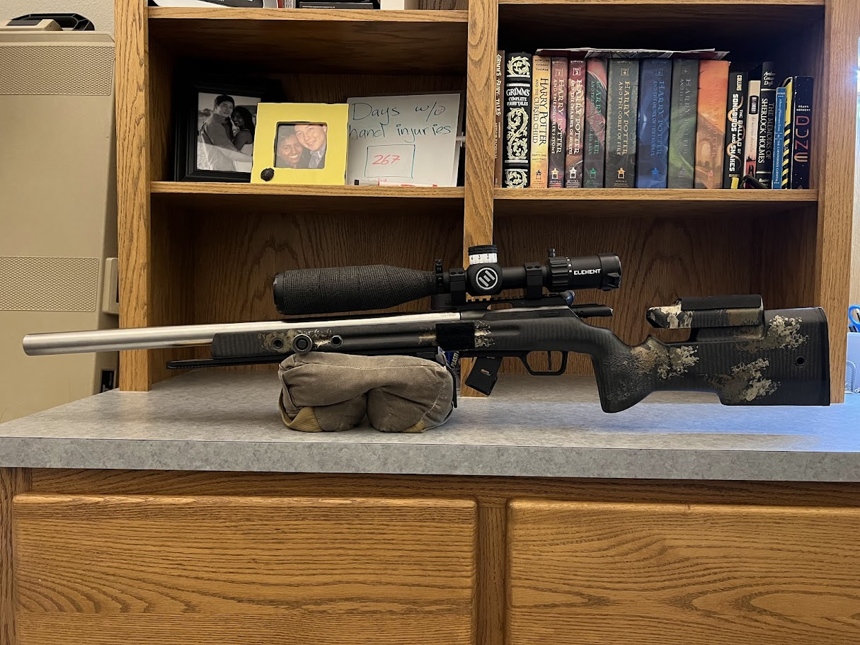

This is our CZ 457 with the L3i barrel. It's in a stock, but it balances perfectly. I know a lot of people with this barrel using a variety of chassis and all have been able to easily balance their setups.
Setup weighs ~15.5 lbs (2.5 lbs lighter than the Vudoo). However, it will balance without the weighted ARCA rail and that drops the weight down to ~14lbs.
I like the Vudoo better than the CZ overall (completely subjective). But you can't beat the CZ for value and it shoots just as well as the Vudoo.

What scope are you using and do you have the KRG arca rail or anything else up front?
Strike Eagle 5-25 currently but I have a G3 razor on the way. I have the arca rail right now but in hindsight I should have picked up one of the heavy versions instead of the standard. I also have a spig mount with my bipod on it.

Got to fire mine today, all 3 of the mags I have worked fine. I have a Hoz & Shield extender on the way, hopefully it plays nice.
