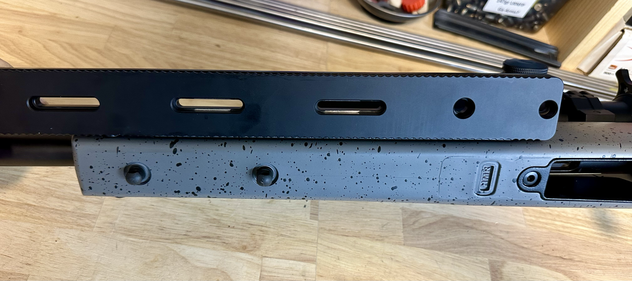

What length area419 rail is the best fit? Any pics installed would be appreciated. I know I could measure but it’s not my rifle. Trying to help out a friend just getting into the sport.

Do you have the rail installed on yours? Looking for pictures and how it was installed.If someone is looking at the factory stock they should look at the L3I heavy rail. It's solid steel so it's actually heavier than the weighted versions but also thinner. Plus it's cheaper![]()
Definitely!Put the sawtooth rifles rail on my friends. It fit absolutely perfect and I highly recommend. I could probably get you a picture if you need it
I would contact Bergara since you are not gonna find this part. Good Luck.

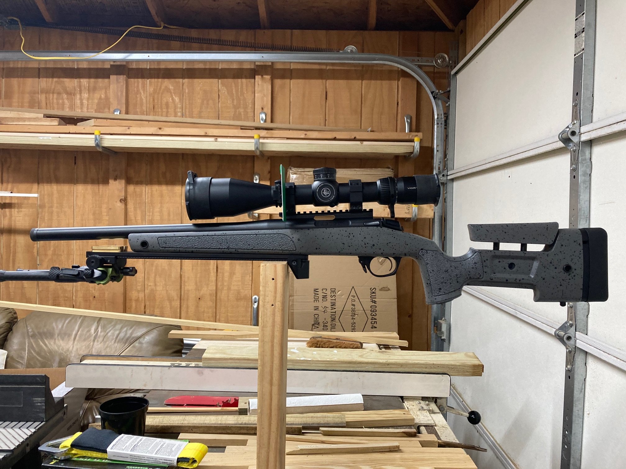

I have the same rail. Which weight is that you have up front? I have not seen that one by Area419. I’d like to get it. ThanksWaiting on new trigger, but everything else is installed. Still a little 'butt-heavy' but she's a girl, so...

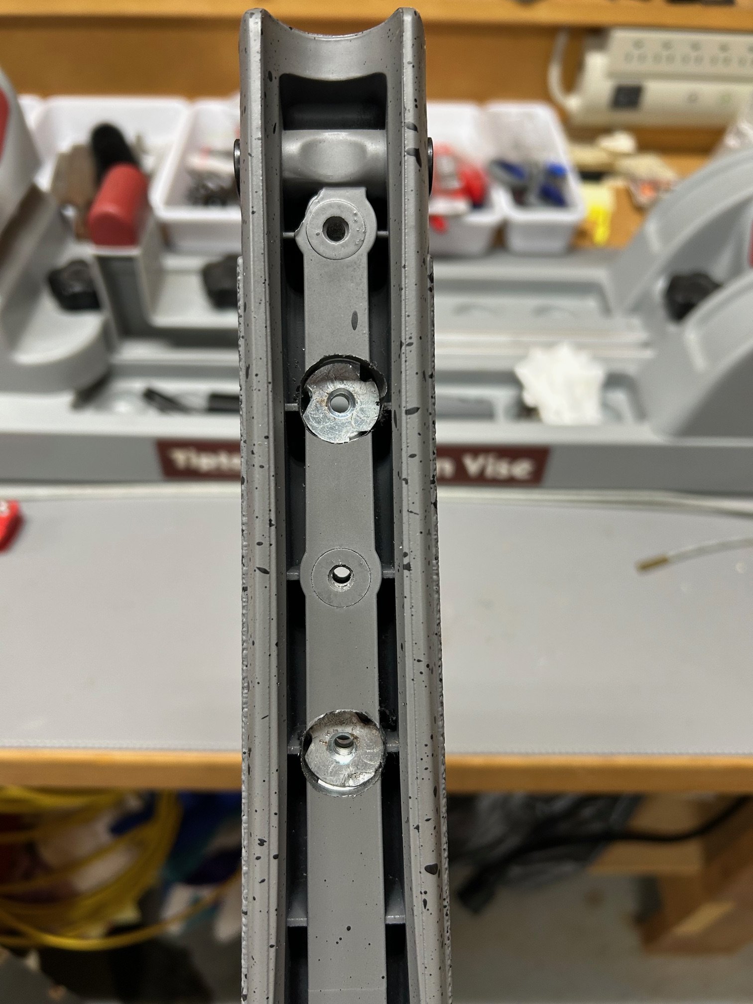

For reference for others, this is the A419 rail with (5) brass weights. I took the weight closest to the mag and doubled it up on the slot closest to the muzzle, and used a longer metric screw from my local hardware store to attach the two weights one of top of the other.I have the same rail. Which weight is that you have up front? I have not seen that one by Area419. I’d like to get it. Thanks
Edit: I don’t have that rail. I have the dovetail rail that doesn’t accept weights. I saw the barricade block on your rail and just assumed it was the same rail.
do you mind getting me a shot of your ARCA rail mounted and how you mounted it? finally got the weighted Area 419 rail and as mentioned the front screws don't line up. Saw your description of drilling and using T-nuts and a 1 3/8" action screw but just thought I'd see where you did the drilling and mounting for the forward screws.For reference for others, this is the A419 rail with (5) brass weights. I took the weight closest to the mag and doubled it up on the slot closest to the muzzle, and used a longer metric screw from my local hardware store to attach the two weights one of top of the other.
