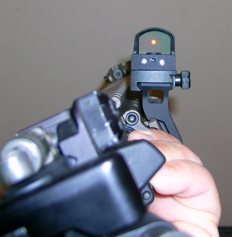

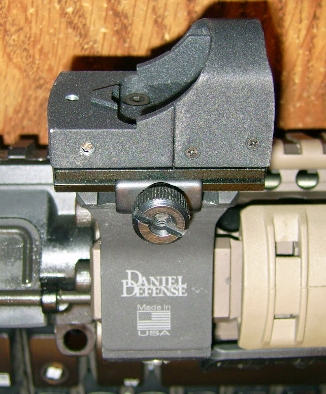

Oh, you also have several mounting options.
You could use the J-Point/Doctor base that Larue offers and mount the red dot on your Larue scope mount.
Another option is the TNVC SAR, which would you let angle the MRD however you like.
The MRD could be mounted using something like a Daniel Defense 1 o'clock offset rail attached to your handguard or receiver rail. That way the MRD is present regardless of what primary optic you are using.
