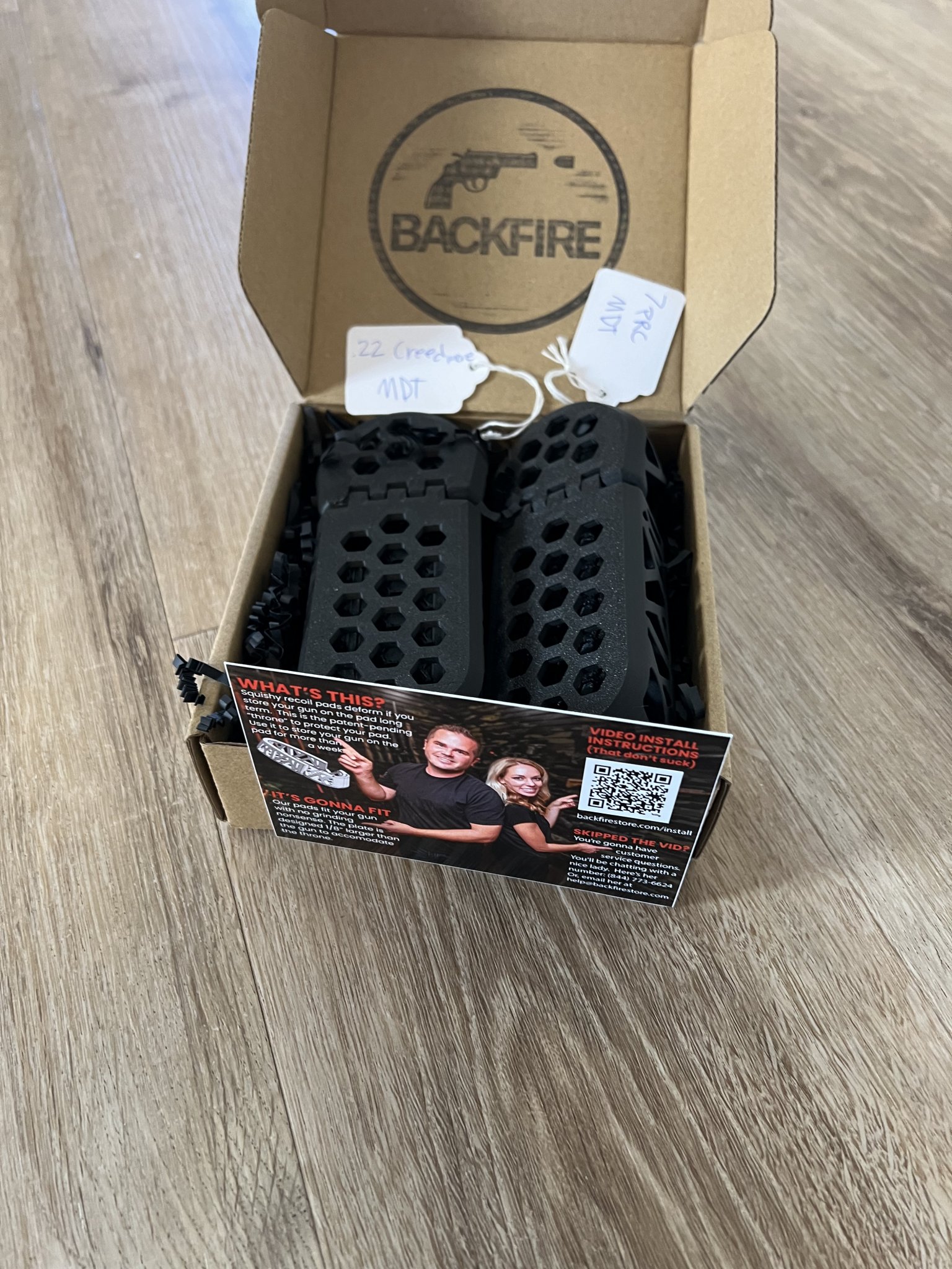

-Shipping was quick! I placed an order and was told I would get them mid February, but they arrived three weeks prior to that.
-Upon receiving the packaging seems very “Etsy”…it is nice but doesn’t really stick with their high tech solution to recoil theme.
-Quality video instructions of installation are provided

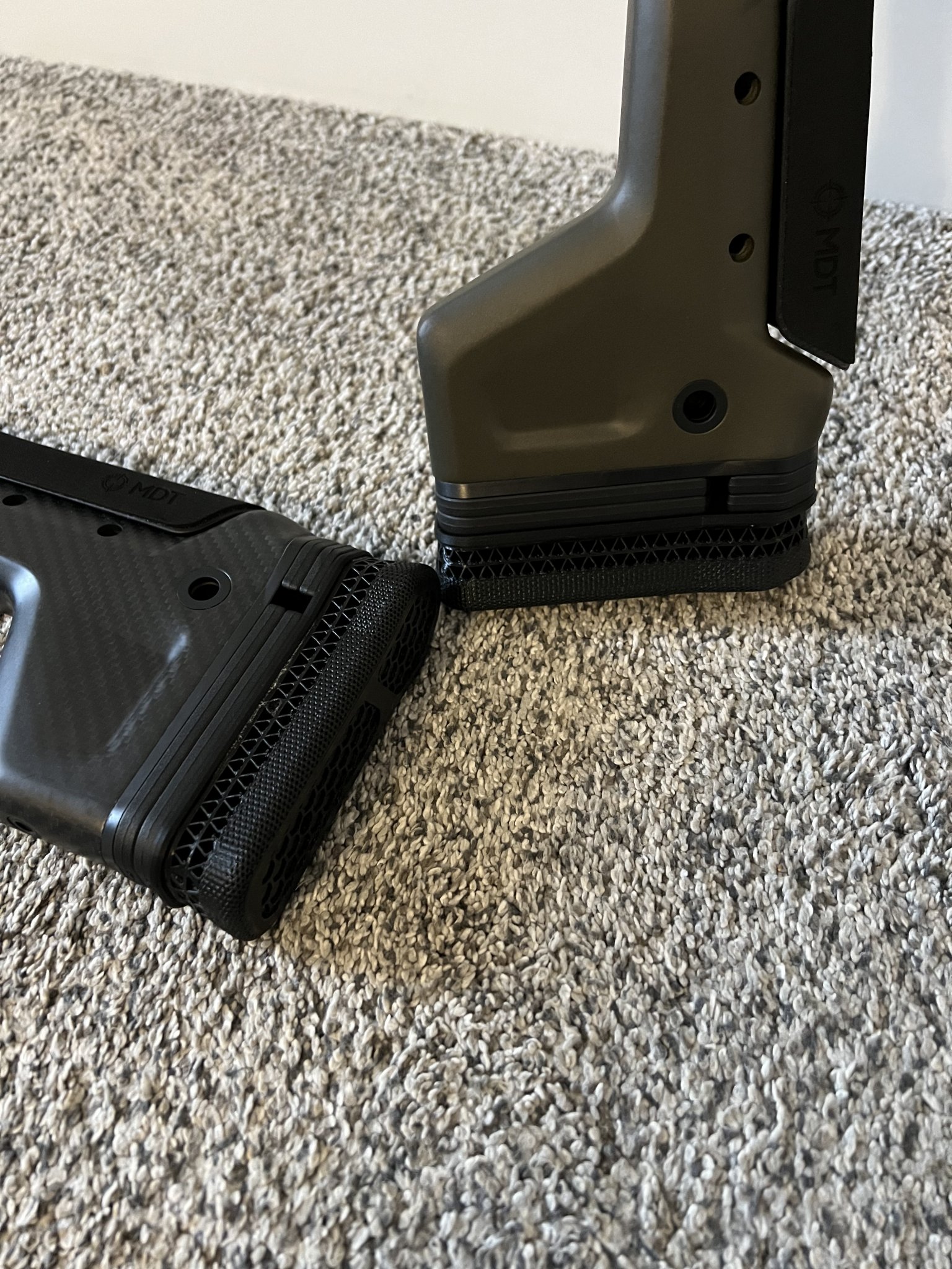

- Fitment is perfect, to me this is the current best option for the HNT26.

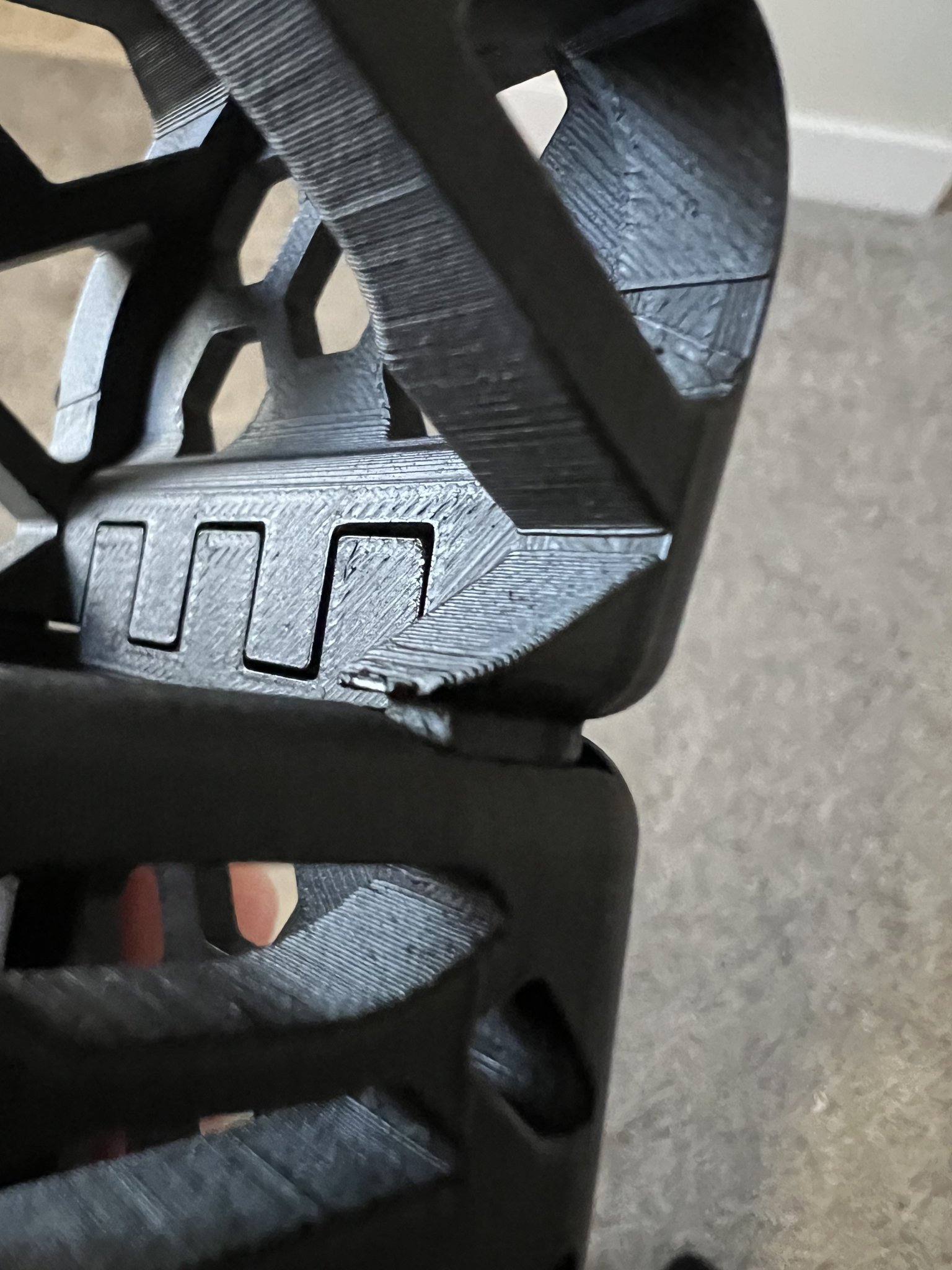

-The recoil pads feel VERY 3D printed, I am a little worried about how they will hold up. I could also see the lattice structure getting filled with dirt when shooting prone.
- everything feels just barely unfinished, like edges pictured. I realize this is due to the limitations of 3D printing used. Once you accept it for what it is, it feels overall well made.

I finally got to the range to test these out in my 7PRC and 22 Creedmoor. Overall I think it is a great upgrade to the HNT26. Felt recoil is so difficult to quantify and accurately compare, but I did feel a marked improvement after adding the backstop. I did notice as others have mentioned that the structuring does capture and hold quite a bit of dirt.
I will really start putting it through its paces soon in the back country!
