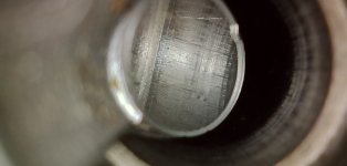

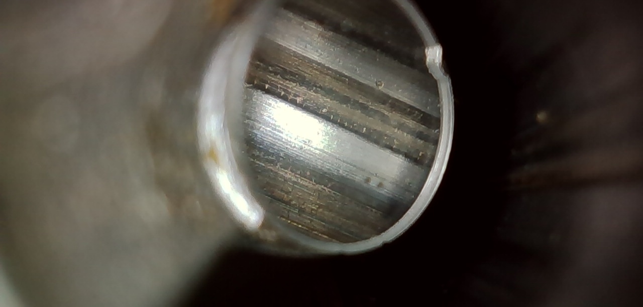

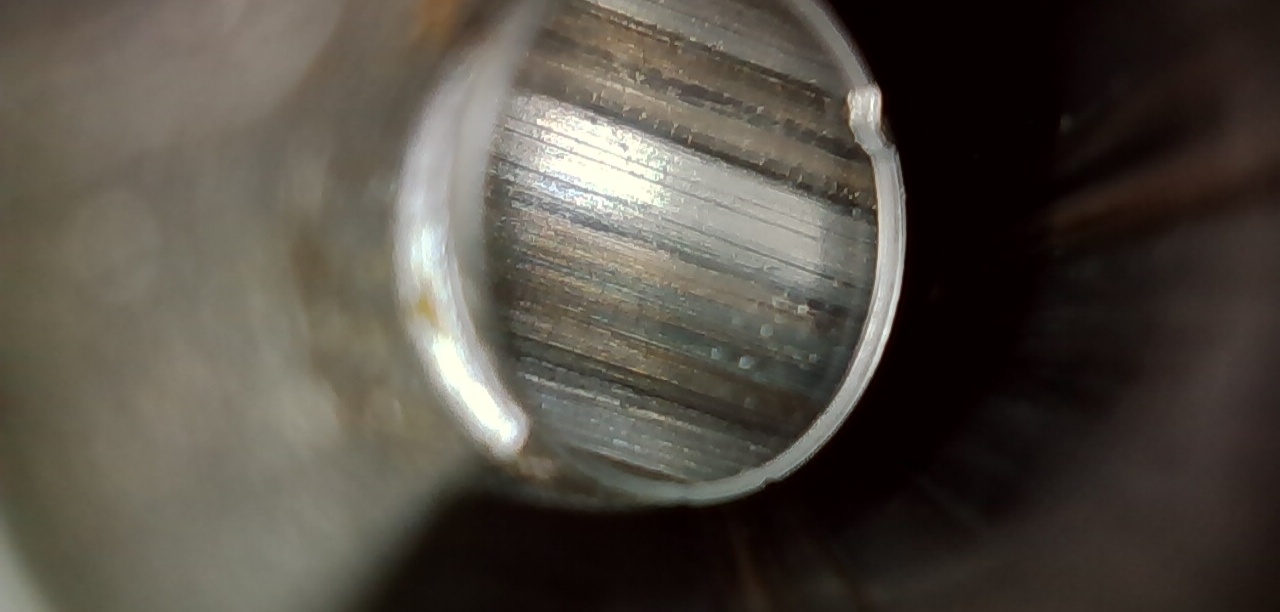

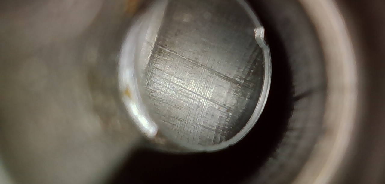

I've attached some pictures of the throat and the rifling (about 2" past the start of the lands). And no, I haven't cleaned the barrel yet from the last outing with it.

If the optics have been eliminated as a problem, there is a possibility the shoulder of the barrel is not square to the bore. If the bore is not in the ideal relative alignment to the optical plane that would explain the wingage discrepancy. Misalignment could cause anomalies you are interpreting into BC variance. As for the copper fouling, it doesn't look like anything exceptional at face value. I do see a partial land running up to the neck which could be an indicator of misalignment or a worn reamer.

Lord. Disregarding what looks like linear galling in the blank, (edited to avoid dogpile). In the throat you have radial tool marks that look like a somewhat dull reamer or not cleaning it out as the chamber was cut. For the sake of impartiality and competence, get it to a known good smith like LRI.
