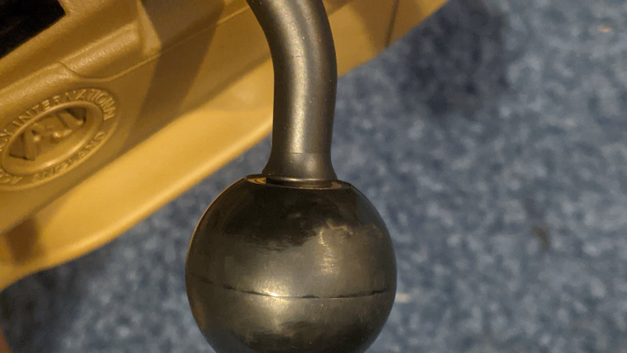

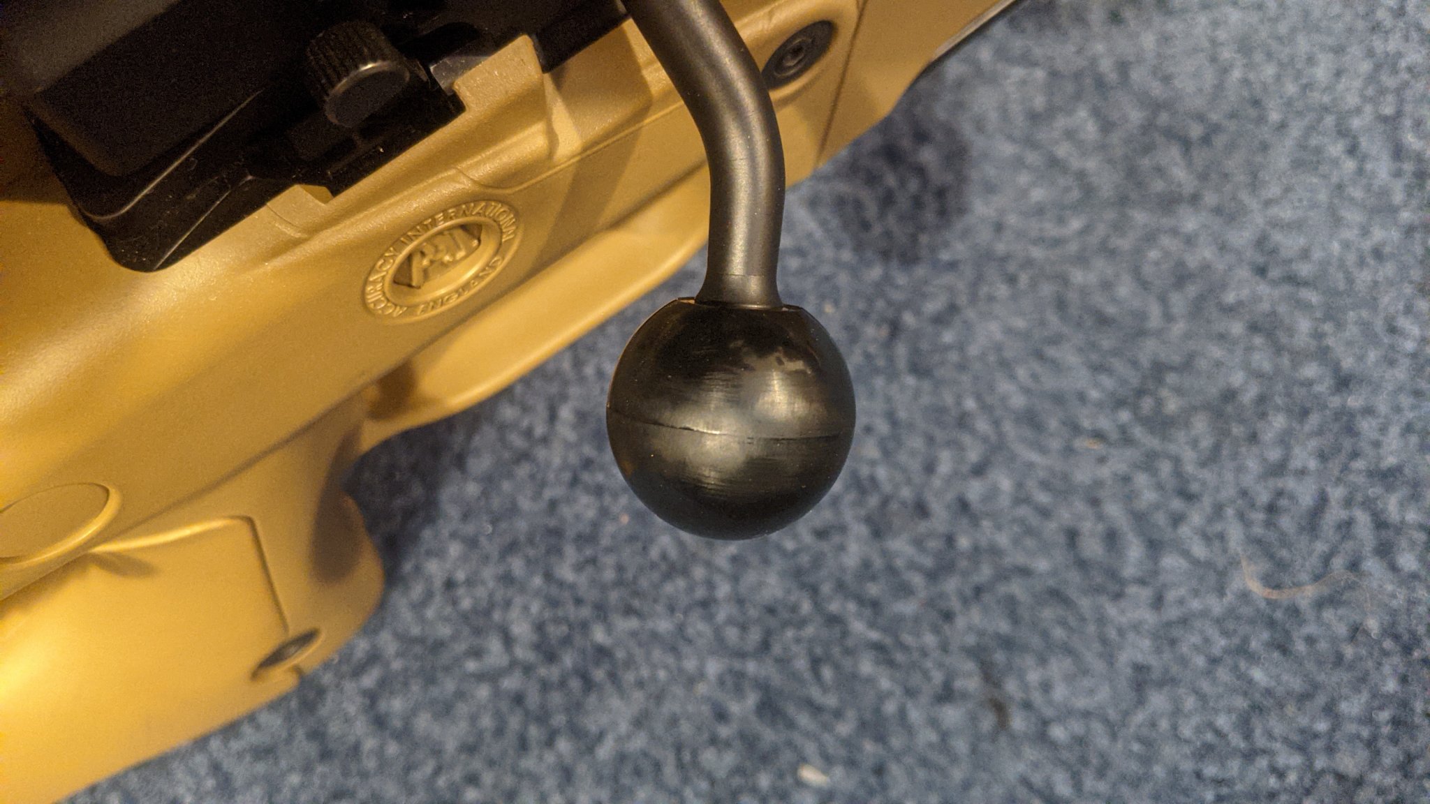

A 13/64" drill bit and 5/16-24 tap got it really close.
I'm going to grab a bottom tap and try to get it exact though.
It does seem to make the bolt lift a smidge heavier since the ball is smaller (rather shorter) than the tactical knob.
Figured it out. There's 1/32" that's not threaded under the shoulder. I removed the first thread in the knob with a 5/16" drill bit.
It is now perfect!
I still have 8 more knobs too. The first try I didn't drill deep enough and split it with the tap...oops.
