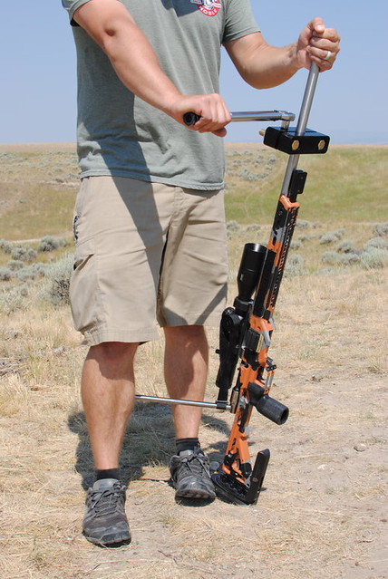

For guys that use your rifle as a switch barrel, do you ever remove the barrel while leaving the action in the stock? You'd have to obviously use the barrel vise further up on the barrel but that still seems like a better way to do it than using a wrench all the way out at the muzzle.
Reactions: Taylorbok and hseII
Look at the pics carefully.
He has a variation where you use an internal action wrench suspended with a bungie. On the other end, instead of the Ross portable vise (no longer available) just imagine you have barrel flats machined in and you use a crow’s foot and torque wrench (or a stout adjustable wrench).
The breaker bar attached to the action wrench presses against your leg as you turn on the flats. You don’t have to remove the action from the stock as the internal action wrench is taking the stress.
Again, imagine that instead of that little Ross barrel vise, instead he’s wrenching on barrel flats near his top hand.
So look at the link at top; there’s lots of pics.
Full disclosure: I do not yet use this system I described but am working towards it. I just need barrel flats and a crow’s foot.
This technique closely mimics removing a barrel on an AI.
Reactions: hseII and Mauser48

Is there a preferred action wrench that would work with 700 Pattern/ 700 clones, or will this need to be specific?
I’ve swapped barrels that way. Saves a couple minutes for sure

i was also cornfused when he's using a torque wrench to REMOVE the barrel..... i was raised that thats a surefire way to ruin a torque wrench. but maybe im not a cool kid doing barrel swappers standing on a mountain. 👀
Apparently some torque wrenches have a lock off so you can use it to loosen too, and some are meant to work both ways without adjusting anything on the tool.
Heck, they all should work like that! Handy.
Here’s a test. Spoiler, you really shouldn’t remove stuff with a torque wrench that isn’t designed to do so. But he shows a Tekton model that IS designed to work that way.
