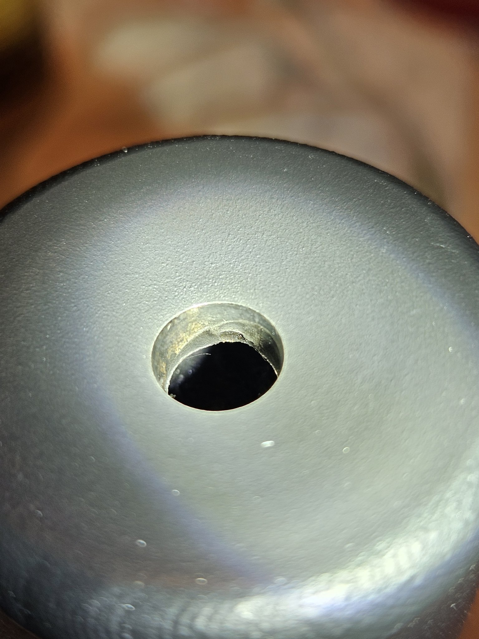

Long story short, my alignment was slightly off (alignment rod not touching, but favoring 12 O'clock position).
I had a couple rounds completely miss target and noticed what looked like an end cap strike.

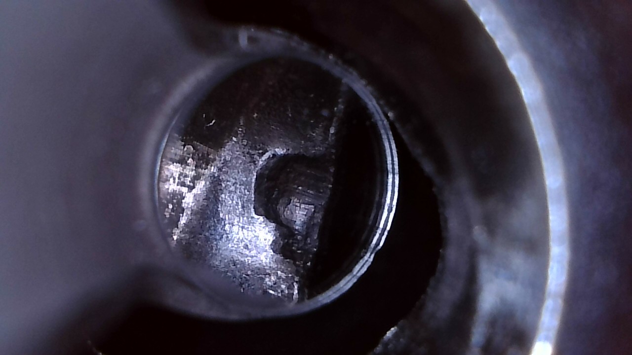

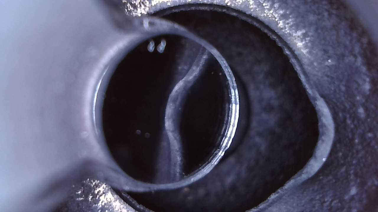

With the borescope I saw the deformation of the 2nd to last baffle as well. (Last baffle is fine for some reason).
No other damage seen.

Suspected end cap strike originally noticed
Borescope view of endcap damage

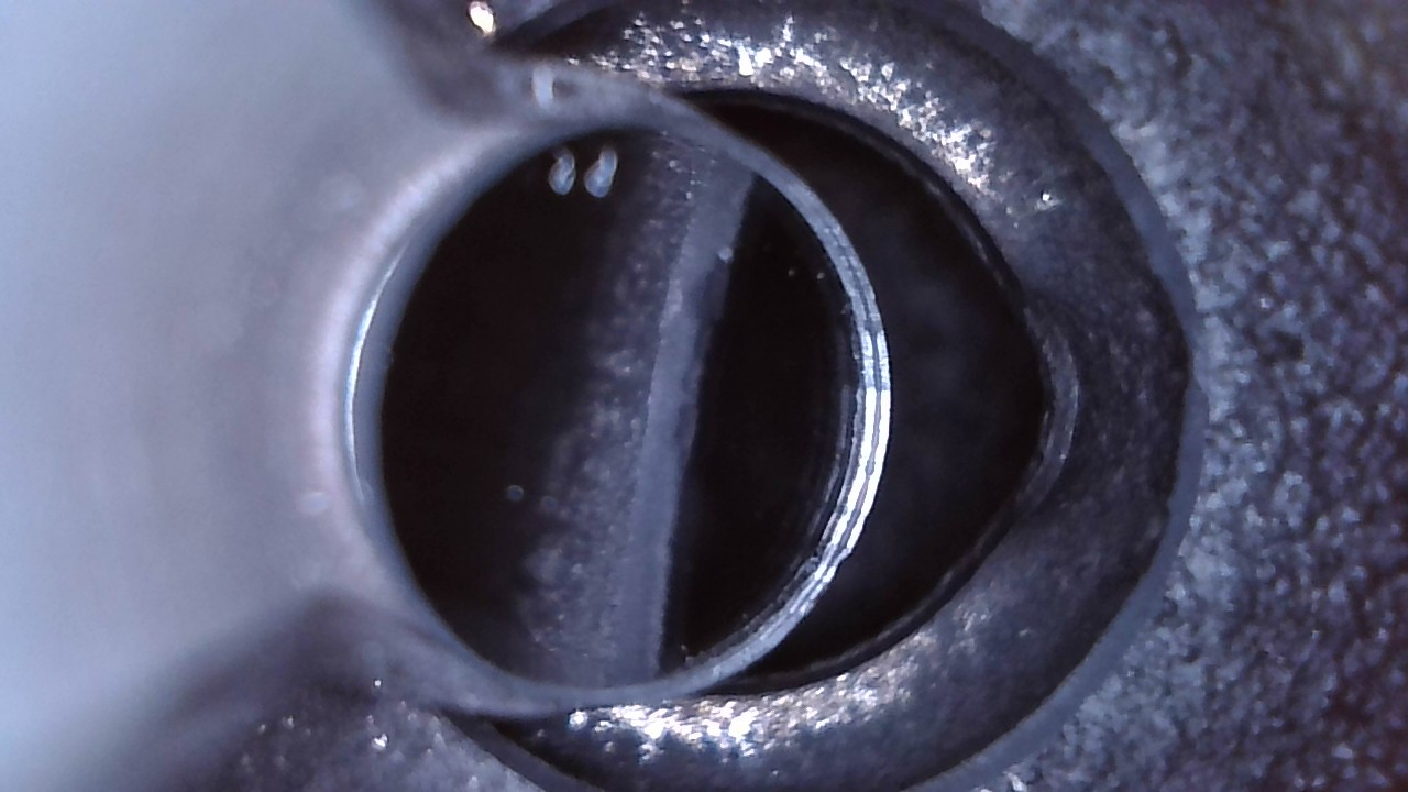

1st baffle from endcap (No real damage)
2nd from last baffle
