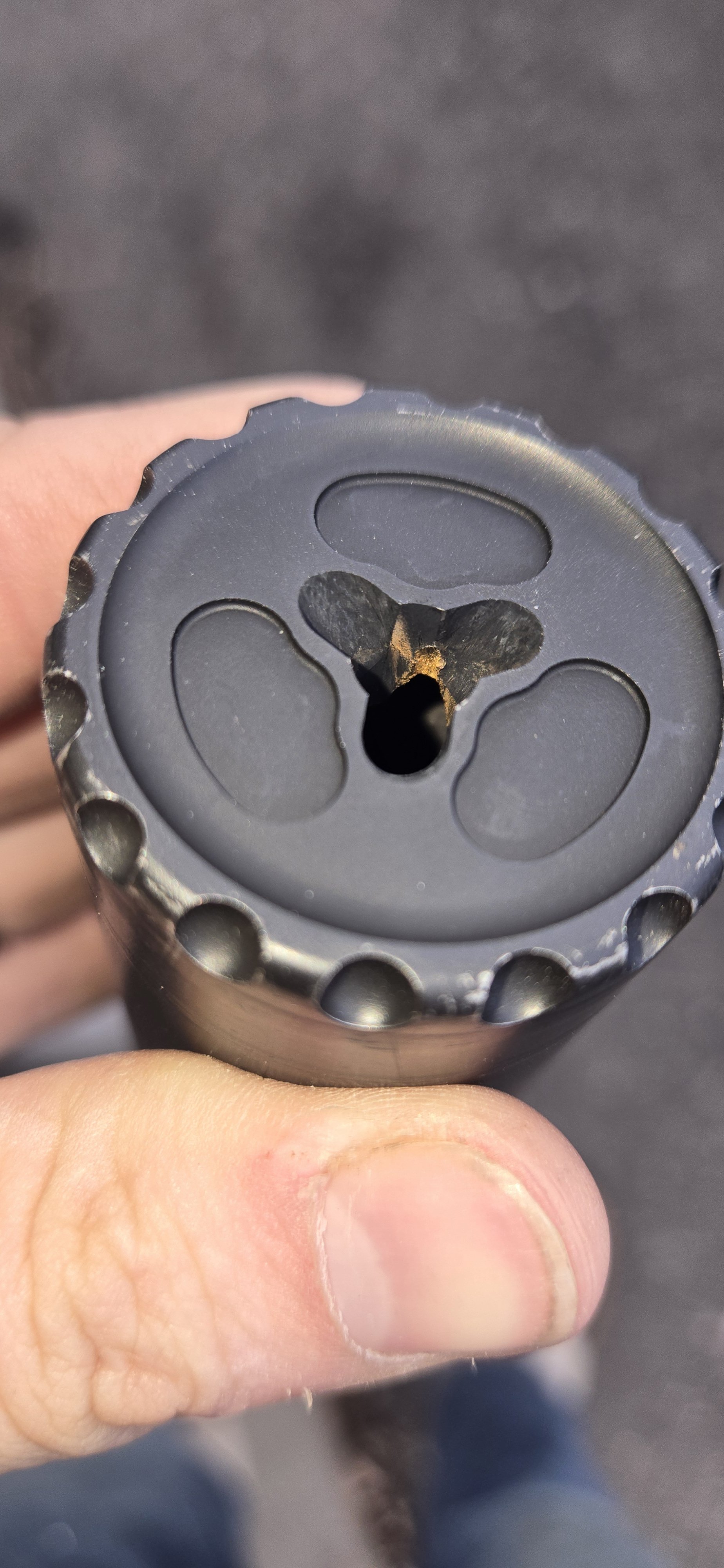

I have a yhm t3 I swap between a 16" ar and a 18" bolt gun, both 223/556.

I put the can on my bolt gun and couldn't hit paper even at 15 yards! Took can off and all was well. Only thing I've noticed in past is the muzzle brake I have on the bolt gun sometimes makes can hard to get off once it gets warm. Today I noticed after a few shots there was some wiggling and a small baffle strike at very end. I'm gonna try to get the best Pic I can.

Anyone know what's causing this? Only thing that's changed since I shot bolt gun was new chassis and reloads but ar had no issue with the reloads.
Ar has the flashhider muzzle device and bolt is muzzle brake. Cant swap one over since threads are different unfortunately.
I did. Teeth were lined up. I might just run direct thread. Only issue i have with that is I plan to do some comps this year with it and id prefer the brake over the can. I'll just have to order a DT adapter and test it out. I plan on getting a few cans next year so It's not like I'm stuck with this one between the 2 for life
Here's a picture. I'm assuming this will cause accuracy issue?
Yeah it could. Is the end cap removable on that can? Hopefully they can help as I am sure you aren’t the first.

I’m confident YHM will take good care of you. I’ve had a few customers that had baffle/end cap strikes that were happy with how YHM handled the issue.
I suspect the problem you experienced was do to the threads on your QD mount having a buildup of junk on them. When you screwed your can onto the mount the junk on the mount prevented the can from tightening down properly. It will also make it harder to unscrew the can from the mount. I would suggest spraying some Rem Oil, or something similar, on the threads and cleaning the mount. It wouldn’t hurt to do the same on the treads inside the can.

I wouldn’t put anti siege on there. No need. Just something like he mentioned REM Oil or a similar light oil that’s easily cleaned off.
