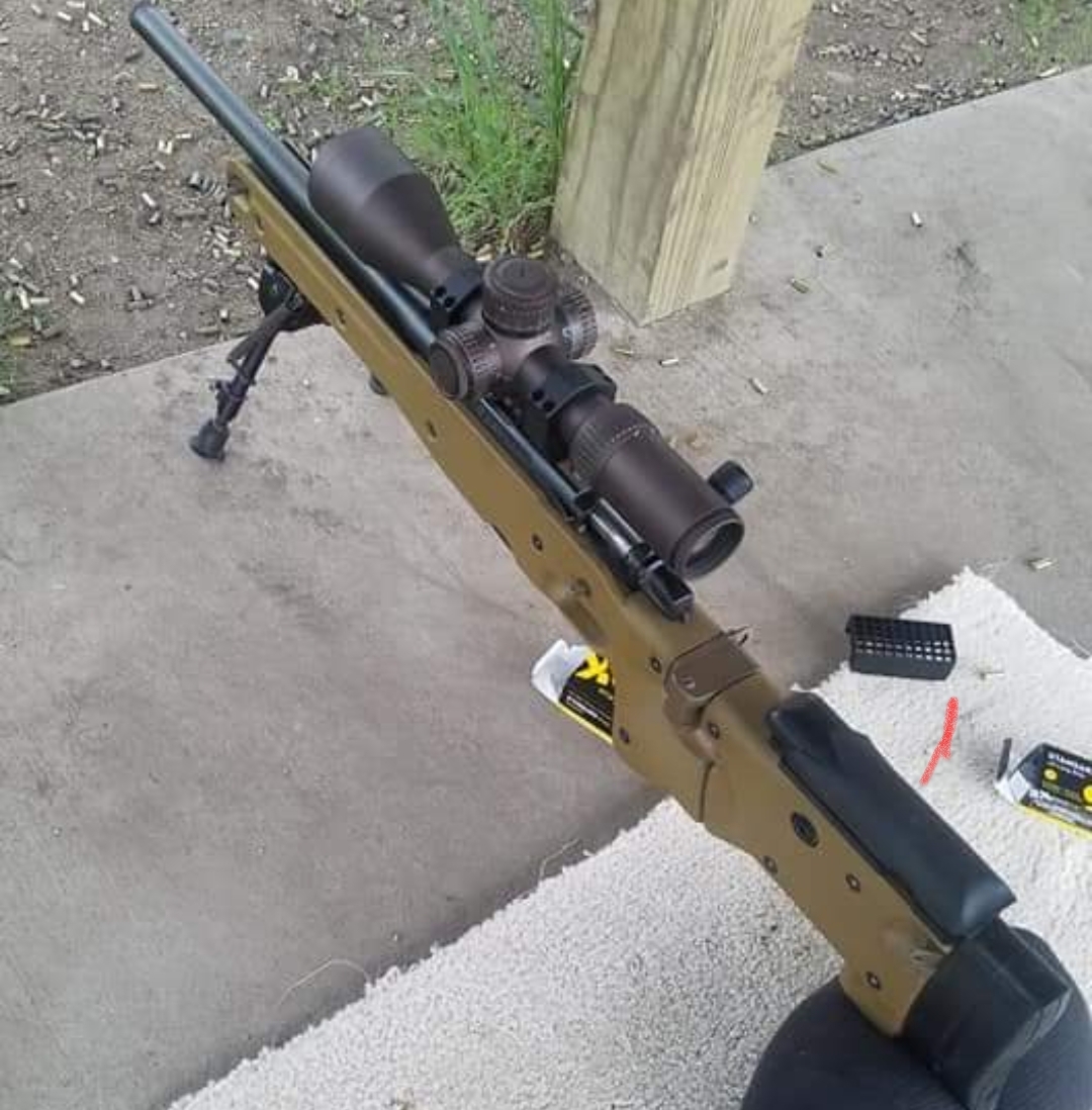

Not a bergara but I have a Vudoo with 18" mtu and it needed the enclosed forend and two weight sets to balance. The new arca forend that KRG makes has a lot more mlok slots then the older version I have.

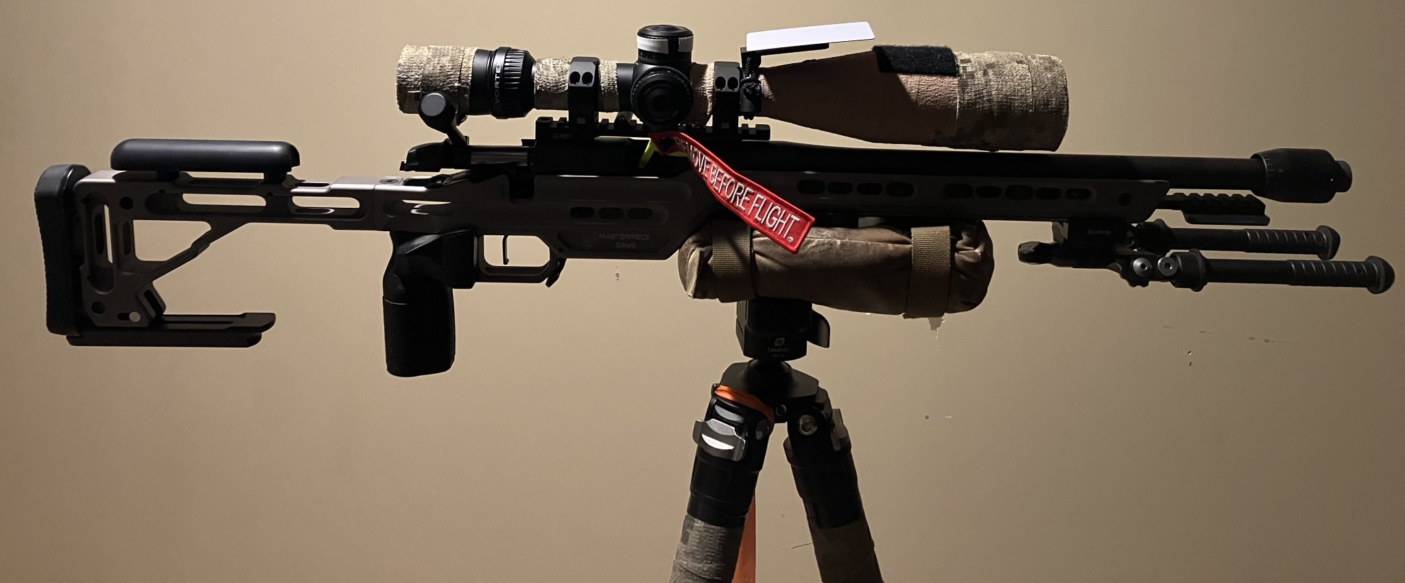

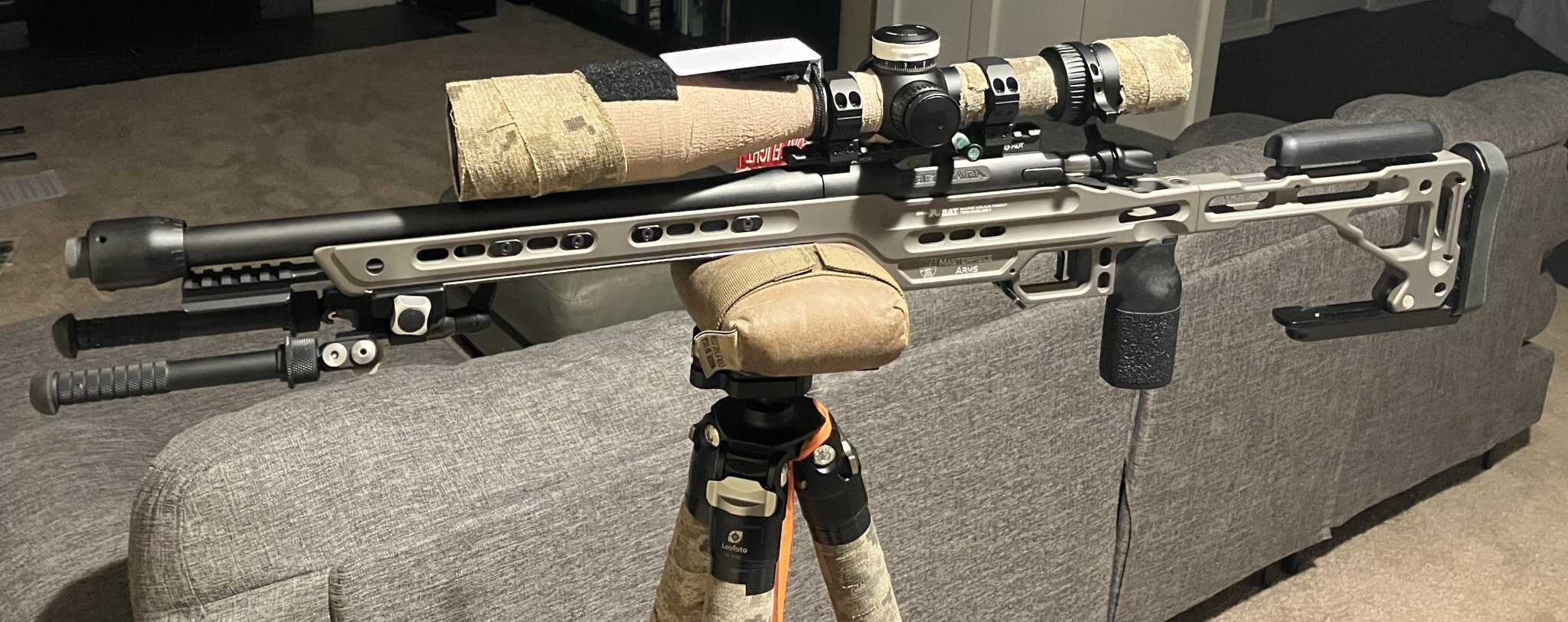

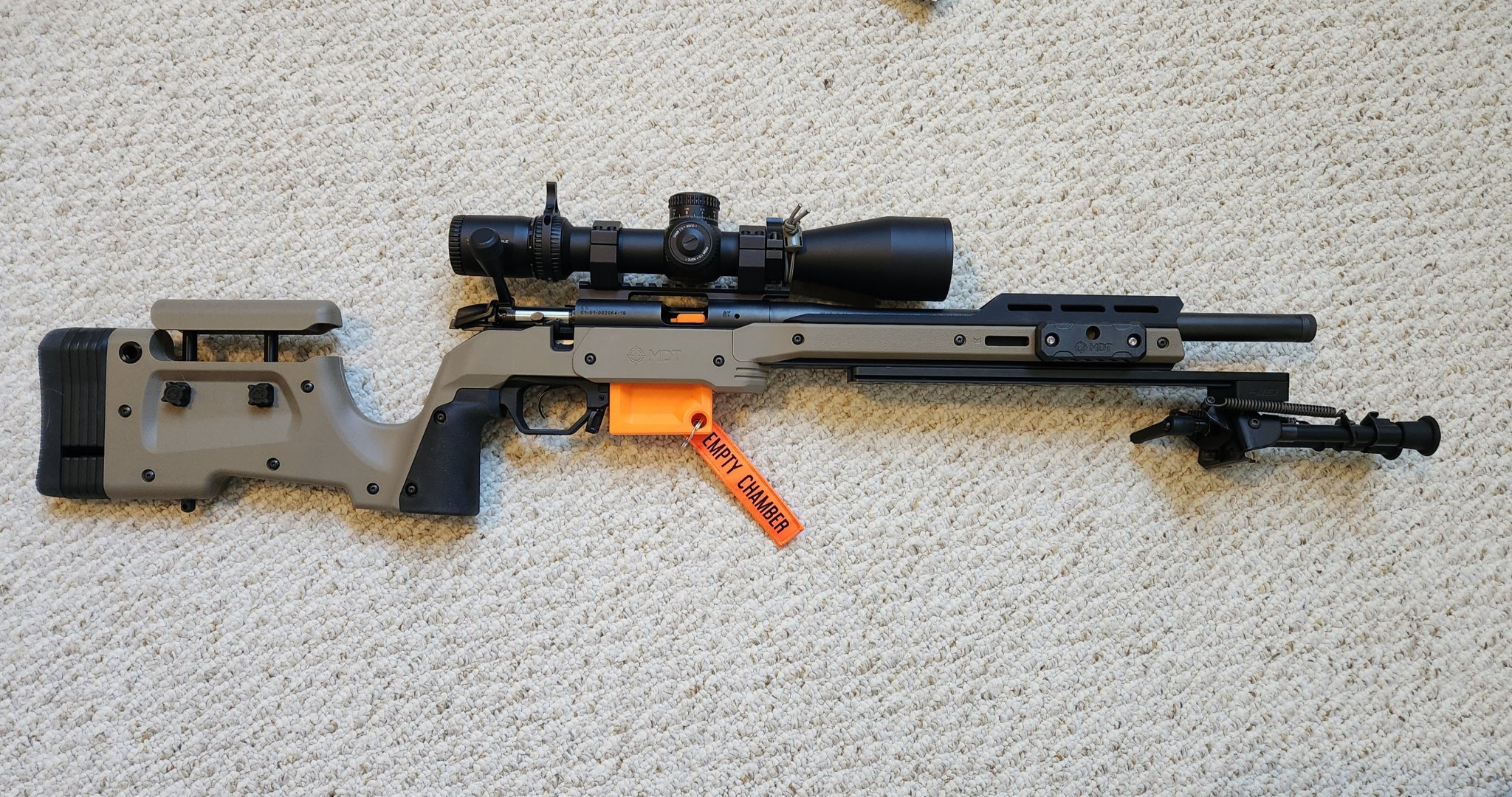

I wanted to give an update to my Bergara B14R saga. I went with the MDT XRS chassis. The photo below is the rifle in it's current form, with the exception that I replaced the MDT M-LOK weights with a set of Grey Ops CNC Hybrid M-LOK weights.
After the XRS chassis arrived I put the barreled action into it, and also added the 360 Precision M-LOK arca rail (which weighs 34 oz. according to their website). This didn't come close to balancing the rifle forward of the magwell, even with the arca rail as far forward as I have it. So, I ordered the enclosed forend and the internal MDT weight that fits inside it. That weight is another 16 oz, and I hoped that adding this would solve the balance issue. No chance.
Next I added the MDT external weights, which also didn't balance the rifle. After a little searching, I found Grey Ops CNC and their external weights. The Grey Ops weights are are heavier than the MDT weights (16 oz a pair) and also have M-LOK slots on the outside so that they can be stacked. I put a set of those on the chassis, but still no luck with the balance. Just for the sake of science, I also put the MDT weights onto the upper set of M-LOK slots on the enclosed forend, and even with both sets of weights, the rifle doesn't balance.
My conclusion is that it is going to take a LOT of weight to balance this thing. There is almost 4 lbs of weights in and on the forend of the rifle, not including the bipod. I'm considering trying to add a brass weight on top of the arca rail under the barrel. I saw a photo of a rifle with a brass weight in that location. It's that, or I slap a dive belt weight on with some zip ties... which isn't really the look I'm going for, but desperate times call for desperate measures.
Now I'm thinking about the future of this rifle and whether a more easily balanced chassis would be the better way to go (and what would that chassis be?). I could have a new barrel put on it, but this one has less than 300 rounds through it so far, and a re-barrel would raise my overall cost closer to the RimX level.
I'm happy to hear suggestions from Bergara B14r owners who have found solutions to the balance issue.

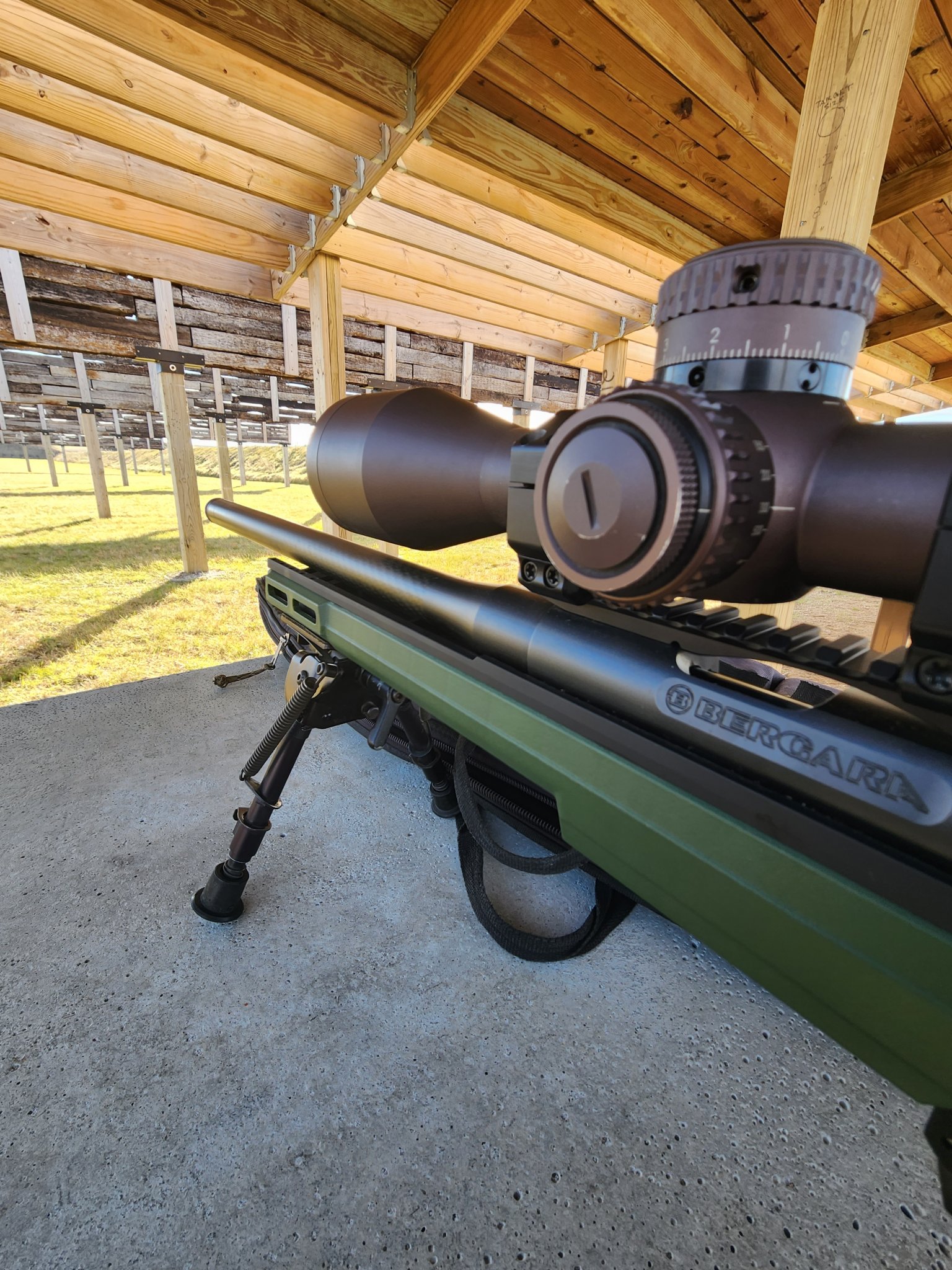

Moving your internal weight to the forward position will help some. I'm kind of surprised with the trouble you've had, are you running a really heavy scope?
Here are a couple pics of mine with a bipod (1lb), internal weight in the forward position and a set of snyder precision weights balancing on a shmedium (heavy fill).

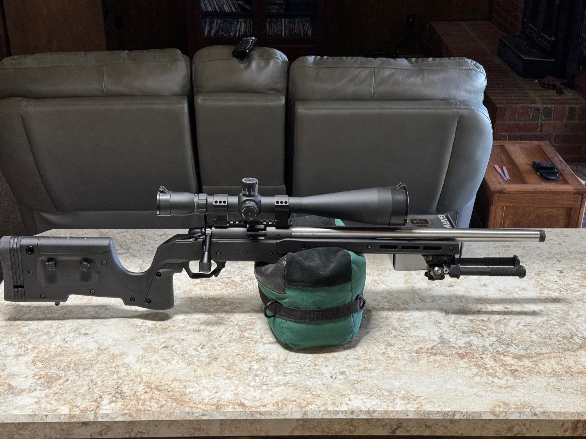

I have a B14 R and you are correct, the factory stock is decent enough, but very light in the front. I put mine in a KRG Bravo and it balances about 90%, meaning just about as well as my 6.5, but not quite perfect. I also have the extended spigot mount, which puts the bi pod out another 3" or so,
it isn't much weight, but it helps a little. I actually just now ordered the KRG heavy spacer to go under the Arca rail, it will add almost a pound and should put it at 100% balanced! At least I hope it does!
I have the steel version of this product on two rimfires. It weighs close to 5 pounds by itself.

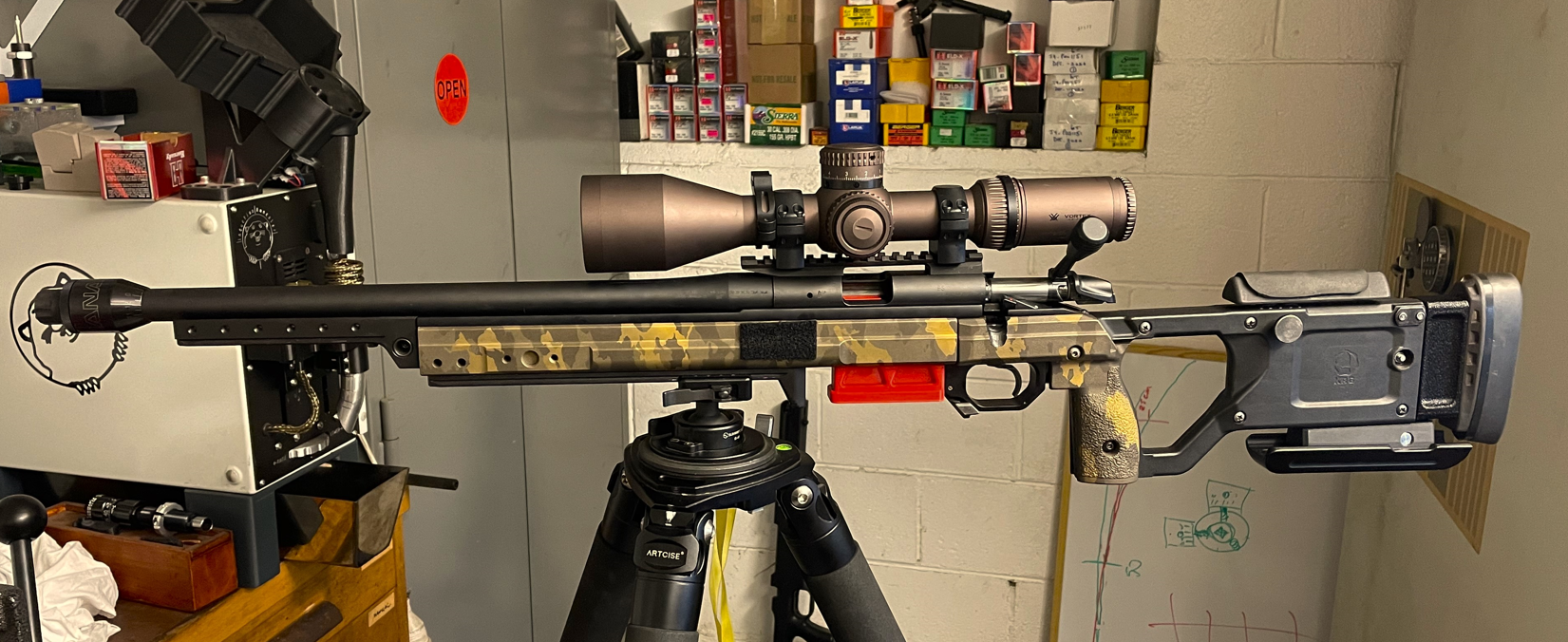

Here’s mine balanced on a tripod head with the Cole Tac rail and sand bag. Now balanced, stable, and weighs -15.5 lbs.
YMMV, happy shooting

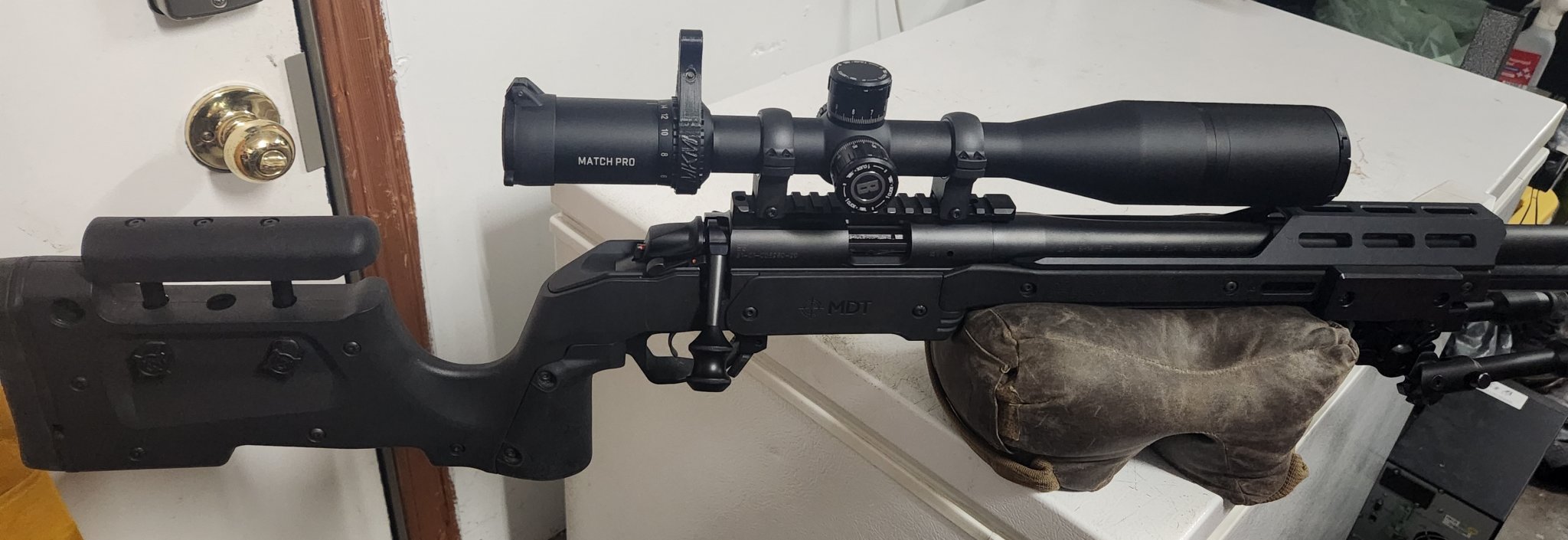

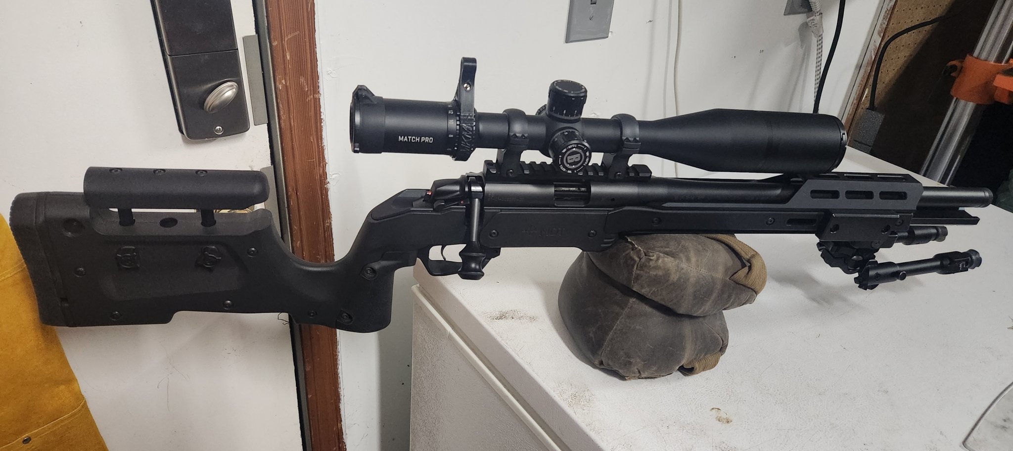

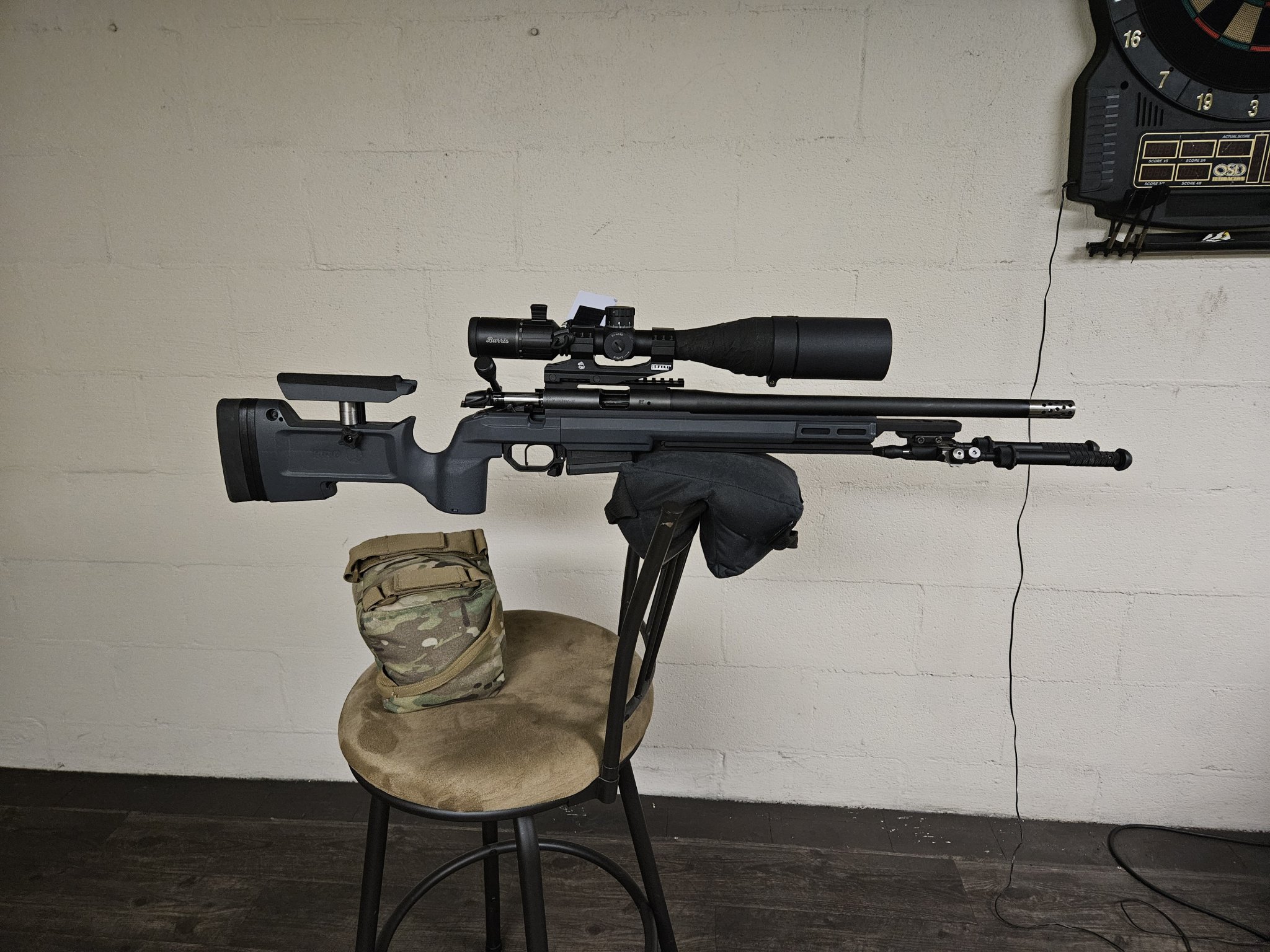

For those wondering about whether a KRG stock would have made a difference in the balance, I decided to try it out and see. The answer is: No.
It's not a 100% fair comparison because I do not have the KRG T-slot weight, which obviously would help. I also only have two M-LOK slots on the forend, so I can't install my Grey Ops CNC weights. I mounted the MDT weights instead, and also attached my heavy 360 Precision arca rail (one caveat to the 360 Precision arca rail on this chassis is that the forend is slightly rounded on the bottom corners, which creates some rocking with the arca rail that is not idea).

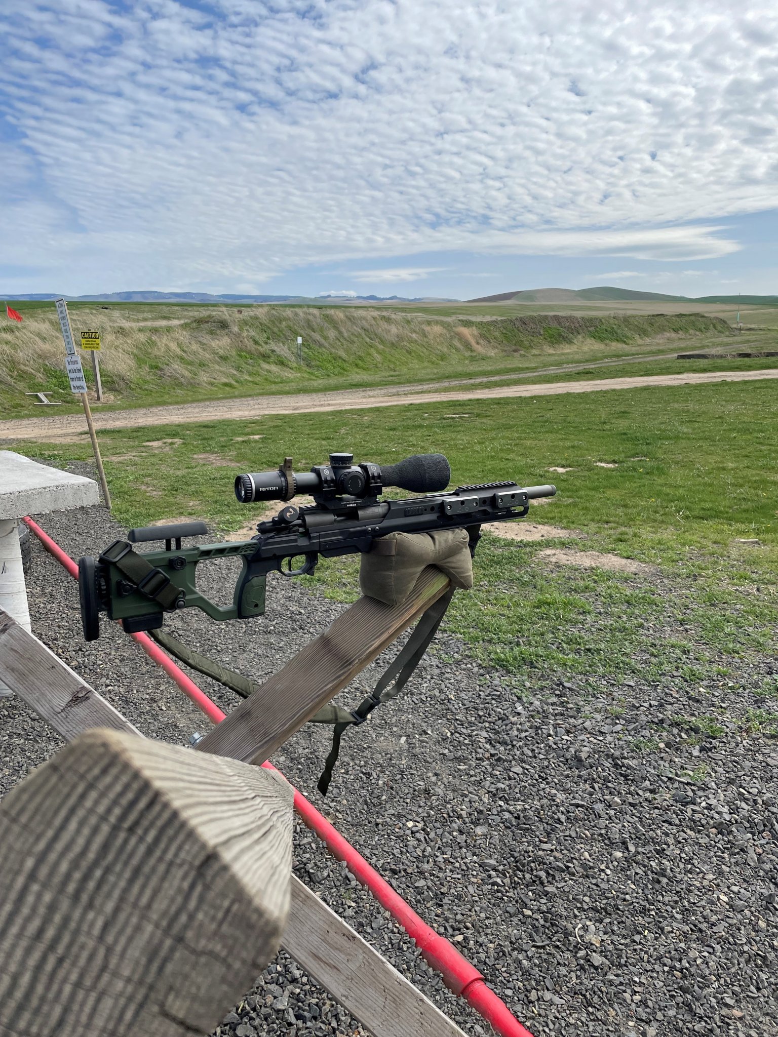

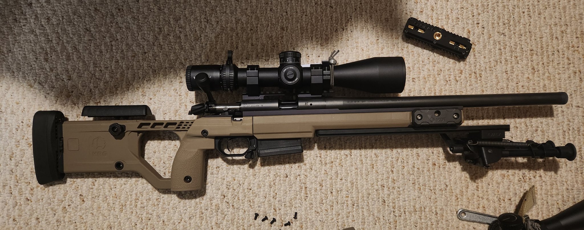

The photo below is the rifle in the KRG X-Ray. As you can see, the forend is a lot shorter than the MDT XRS, so the weight isn't as far toward the muzzle to help more with the balance. Out of curiosity, I started putting some small weight plates (barbell ones) on top of the arca rail where it extends past the forend. With the bipod attached, it took 2.5 lbs of additional weight to balance the rifle. Personally, I think that's crazy, but it shows that these chassis were not designed with rimfire rifles in mind--at least not ones with shorter/more narrow factory barrels.

Here is the balance point on my MDT XRS with the Bergara 20" Barreled action. I'm certain the Scope with the 17"length and Atlas Bipod add to the weight but I don't use any chassis weight. I only shoot for entertainment off a bench and most of the time I use a Lead Sled II since it's more stable than I am. Weight as you see it is about 15 pounds.
Mine balances pretty much perfectly in a bravo. No idea how much heavier the x-ray is. Spigot with either the ckye pod or a Harris out front and full arca rail. Could do the heavy steel rail to pull it forward slightly.
For reference, I stuffed 4 lbs of buckshot in a bravo to balance a 24" #8 taper (1.125-.930 straight) for the 243.
My Arca weight/spacer came today! I won't get a chance to install it till Friday, but my rifle also balances almost perfectly in a Bravo with no extra help.
In fact, I was shooting Sunday with a friend of mine, she is very new and just started shooting. We shot my B14 R and a Ruger Mark 2 22/45. I had the rifle on a 4' stepladder, balancing on a schmedium Gamechanger, heavy fill. Pretty sure the rifle would still be there on the ladder if I would have left it. FYI....once I figured out the wind, it was brisk, she hit my 1" mini gong at 85yds from on the ladder!
I'm surprised it balances so well with no extra weight. That heavy 20" barrel sure must make a difference! And yes, the Harris adds almost a pound, and it being way out front helps.
Well here it is with the KRG heavy weight under the Arca rail. The extra almost 1# under the barrel seems to help with balance and the gun seems more grounded, if that makes any sense? When you set it on a bag, it feels like it's not going anywhere!
Reactions: GearMaker
Nice! I'm glad it balanced for you! I think having your bipod out so far on the spigot helps as well. With the contour of the KRG forend being slightly rounded at the bottom, does the arca rail/spacer setup have any rocking, or is it rock solid? Thanks for posting the pic!

Well, here is the long-term update to my balance issues with the Bergara B-14R in the MDT XRS chassis. I had to spend more money than I had anticipated, but this ended up being the solution that I decided to pursue:
I'm being a little tongue-in-cheek here, because this is not a re-barreled Bergara B-14R. I decided to have a RimX built instead. I'm probably going to sell the Bergara.
I made this decision after placing a 2.5 lb barbell weight on the arca rail where it extended past the forend of the Bergara (see previous pics), and it just barely balanced with the external M-LOK weights and bipod attached to the 2 lb arca rail. That was just too much extra weight to try to figure out how to add to the rifle on top of everything else that I already had on the XRS chassis to try to balance it. It seems pretty clear to me now that both the XRS and the KRG X-Ray were simply not designed to balance lighter-barreled rimfire rifles--and that's ok.
The RimX just barely balances forward of the magwell in the above configuration, which includes the MDT XRS weight-capable forend and the forend weight installed. The barrel is a Krieger 25" 1.2" straight profile barrel. I still need to put the arca rail back on it, but I really like not having to worry about any external weights, attaching scuba belt weights with zip ties, or making big DIY brass M-LOK weights, etc.
Now all I have to do is put a bunch of rounds through it and enjoy it.
