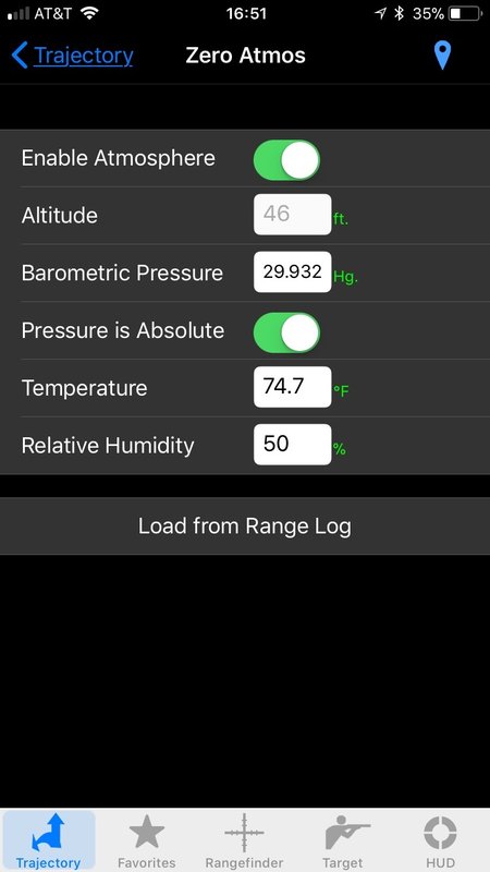

    Can somebody PLEASE tell me how to manipulate the elevation setting on my Ballistic AE app. I’m trying to find the difference in shooting conditions here in Tampa (~50’) compared to those in norther Carolina (~4000’).

    Turn off pressure is absolute, then you can change altitude. You can turn on pressure is absolute again if you desire, the value remains.
    What I am not sure is if the calculation does take into account altitude when pressure is absolute is enabled.
    I switched to a Kestrel so I don't remember this setting.
    Yeah turn off "pressure is absolute" if you are not using station pressure (versus corrected barometric pressure, which is what it currently reflects in the picture).
    I just came from Nevada (to Tampa) where I had my rifle dialed in at about 5K' DA. My zero did not change but my transonic range did. Also, if you do not change your zero here in Tampa, you do not have to change your "zero atmosphere" in Ballistic AE. Only change/update your "current atmosphere".
