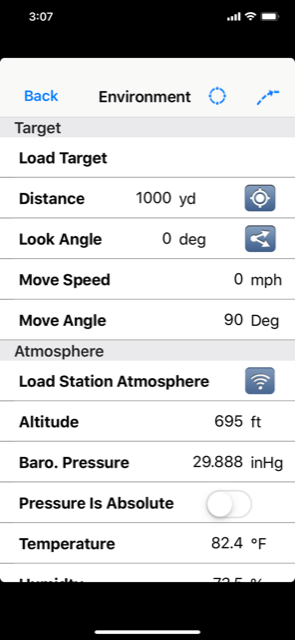

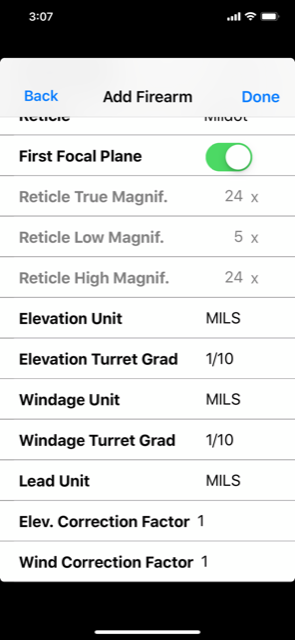

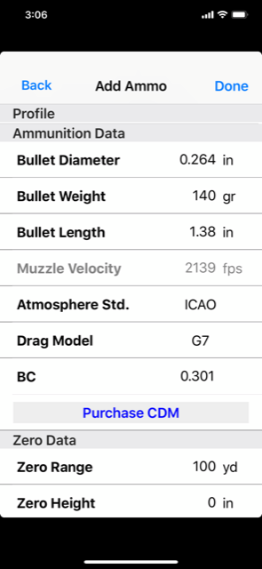

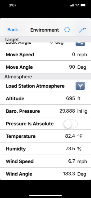

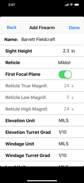

screen shot your set up screens and ballistic screens, we will find the issue
The bullet data was picked off of the ballistic apps menu.
Regardless of the app, the real world shooting dope is what seemed to be way off, not really the app. The 100 yard zero is good. We are required to confirm at the range I go to. I double checked the torque on the scope rings. Possibly an internal scope problem?

where is your range card,
There have to be missing pages because 2100fps on you MV should not be anything of value and your BC is easily a 3000fps BC
Give us the shooter screens too
Sorry, the MV would normally have read 2628fps. the 2100fps number is the number it spit out AFTER i did the "calibration". Once

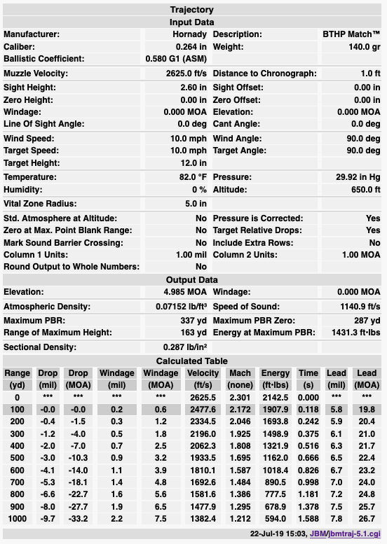

7116428
These numbers are close to right, didn't say which 140gr bullet so I picked a generic one. this data is closer to right
