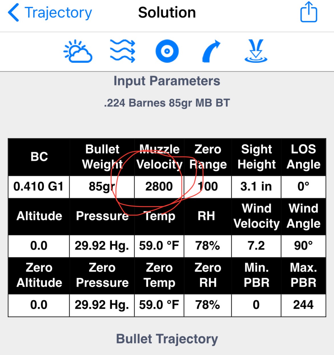

Shooting Rd15 85gr badlands match burners. Don’t know exact mv but am using what others are getting out of the same length proof barrel.
Shot this weekend got a solid 100yard zero.
Used Hornady app to see what drop would be for 300. Move back dial mills all shots high. Shoot some paper and measured with a tape 9.5ish inch of drop. Roughly .7ish mills. I held .6 got hits on 8” steel.
So my question is why is the ballistic app saying I should be seeing 15.7 ish inch of drop but on paper constantly getting 9.5” ish. Even if my mv is off which I’m sure it’s not exact. In the app the bullet would have to be going like 3120 to match what I’m seeing.
Am I just being poor and need to get a garmin and better ballistic app?

Well, u less you start sharing some pertinent information, like caliber, load info, barrel length, what velocity you punched into the app, scope height over bore, etc., you have us all taking pot shots without all the information.
You are essentially asking us, “What is wrong without telling us what you’re doing.” It’s like playing twenty questions.
Reactions: 6.5SH
I will check and make sure the scope is tracking properly. But I believe its fine in that aspect. Advertised MV is 2900 I understand I'm probably seeing a few hundred feet per second less then that. I do plan on getting a Garmin but will be another month or so before I can snag one. Group size at 100 is about moa and also opened up to about a 3" group at 300 so still holding moa accuracy. I just double check my inputs in the app and unless I'm missing something everything is correct. Which leads me to believe my distances must have been off but I just don't see how unless my rangefinder completely shit the bed...
556 85gr badlands match burners, Factory ammo from them. Adveristed MV is 2900, I dont know my exact MV but it should be around 2800 from what others are getting from that ammo. Factory RD15 upper so it has a 16" Proof barrel. Height over bore should be 3.145.

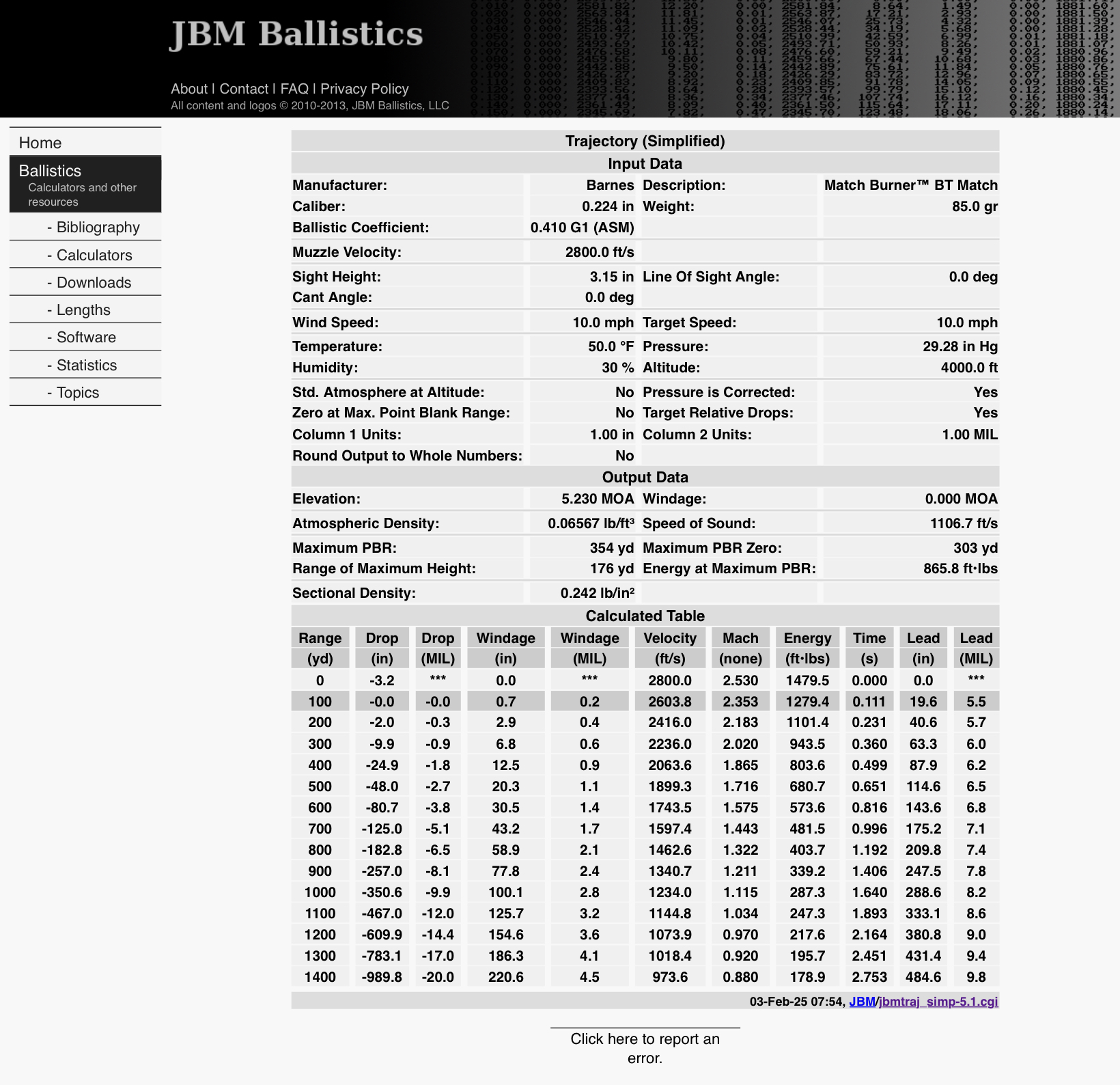

Based on your 85 mb, going 2800, at 4000 ft, 30% humidity, 50* (Arizona?). Here’s what JBM says. Not too far from your 9.5” of drop.
Reactions: LRRPF52 and lash
OREGUN beat me to it, I got similar numbers running it through JBM and Strelok Pro too.
A) Something isn't jiving with the Hornady program.
B) You were a little off on the distance, maybe picking up the background instead of the target.
Those powers combined could throw you off and make you doubt life, the universe, and everything.

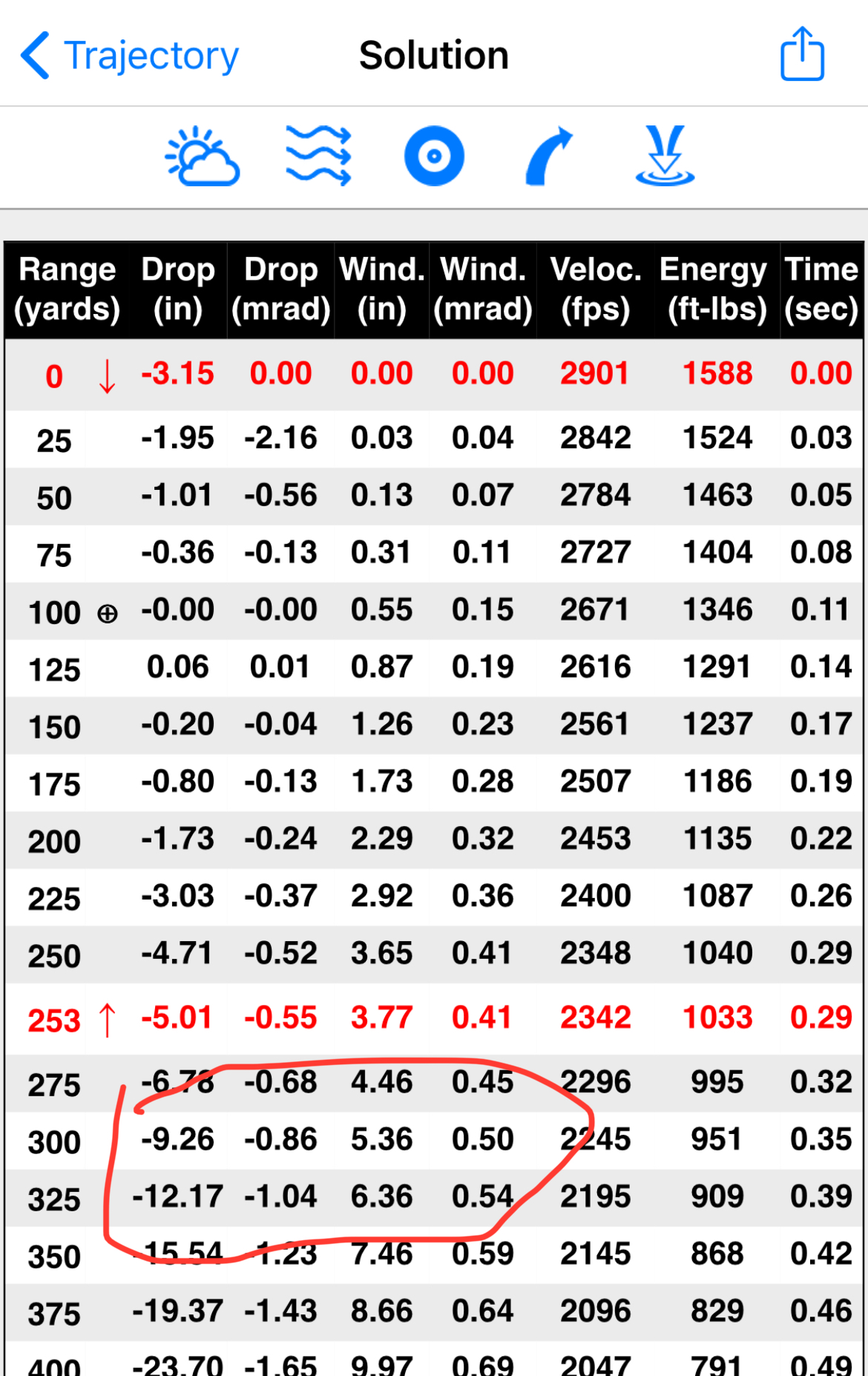

And carefully check that all of your inputs are correct when you built the profile. Every detail needs to be input correctly, ballistics coefficient, G1 or G7 ( it makes a big difference), scope height (from center of scope at front ring to center of barrel/bore), zero atmosphere, etc.
Once you are confident that this is all spot on and your dope is close to matching the predicted drop, you can adjust the velocity to tweak things just right.

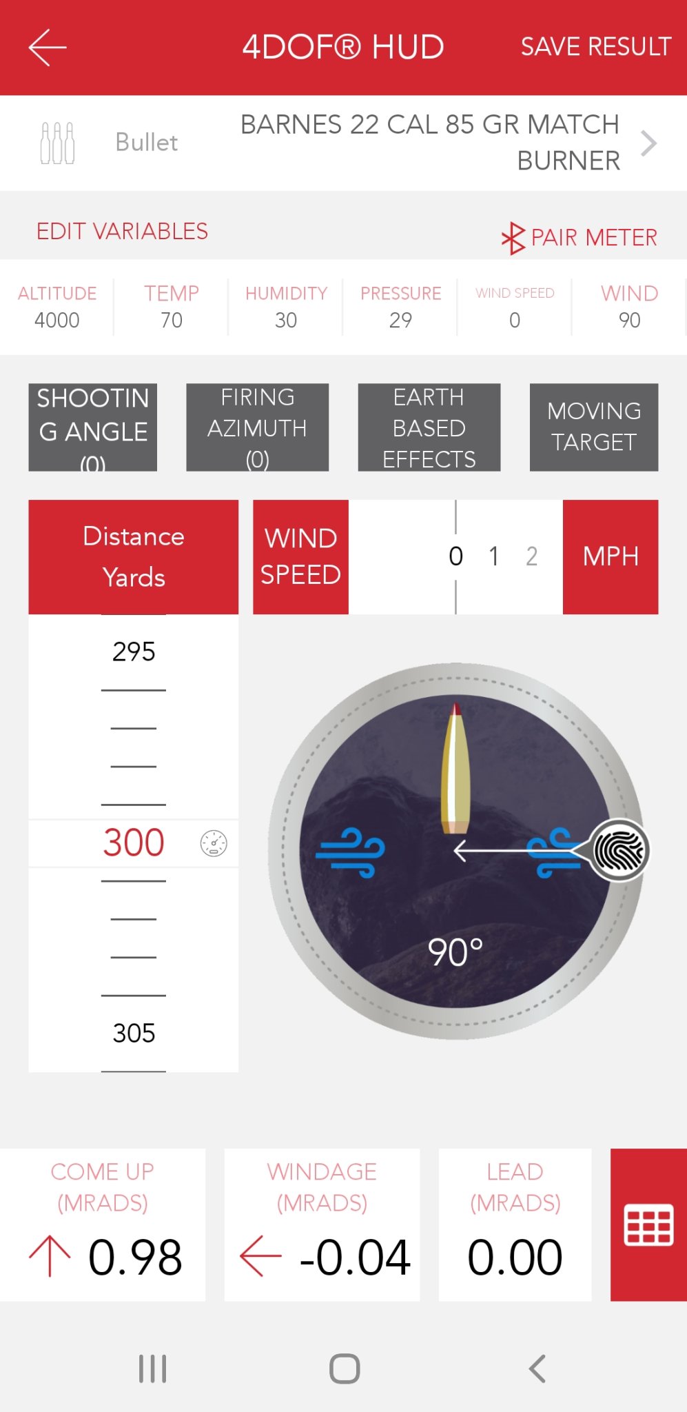

Yeah, check your app inputs. I just downloaded the Hornady app and if I go to the 4DOF calculator, select the match burners, and do nothing else then I get a data output similar to yours, around 16" of drop at 300 yards. Changing nothing else except the velocity to 3120 fps, then the data starts to align with what others posted above from other ballistic calculators. If I change the parameters to what you indicated above and the average atmospheric data for AZ then it aligns more accurately with Strelok Pro, JBM, and lash's numbers.

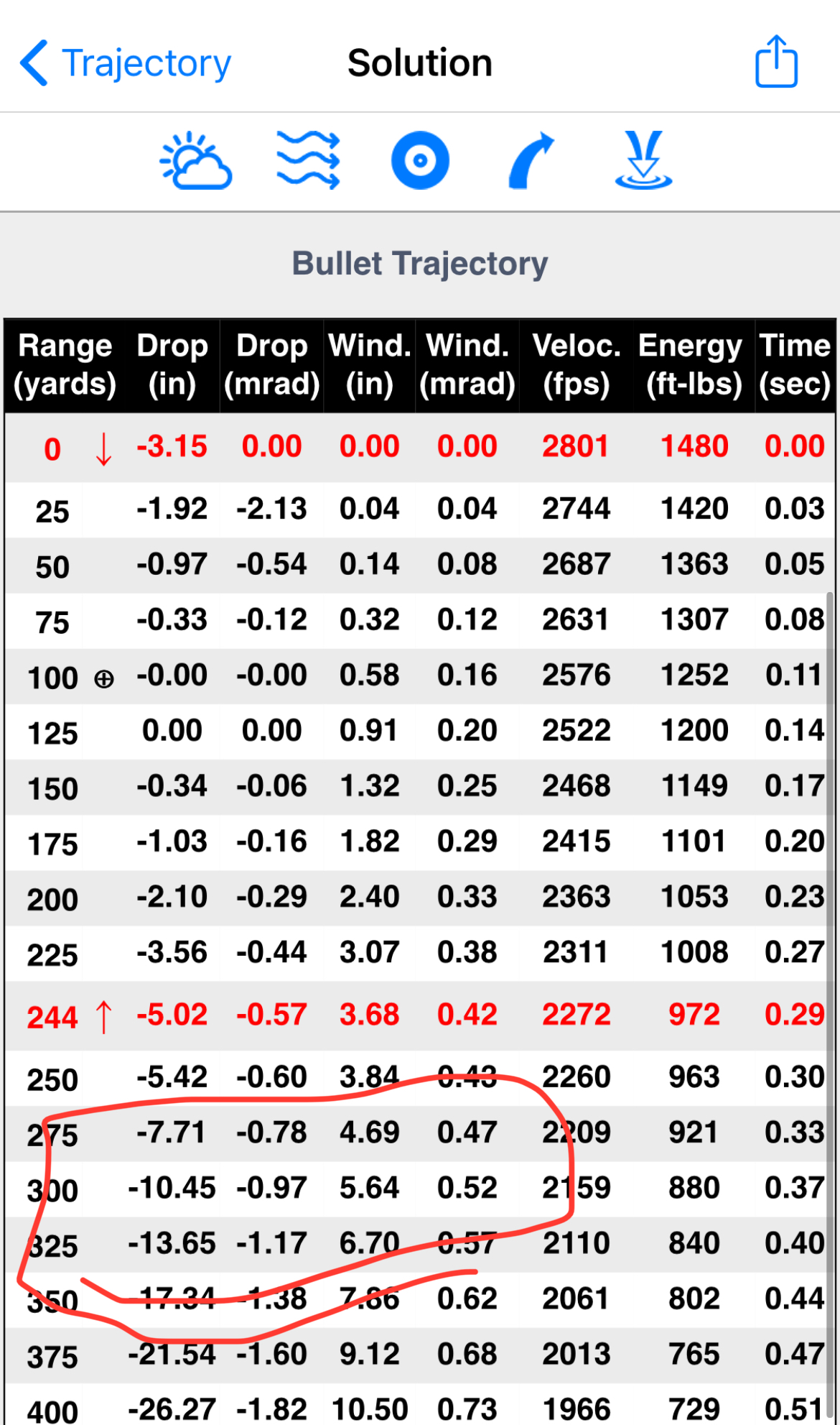

Im starting to think that something was glitching in the app yesterday. I just went back in and punched everything back in and Im now getting the same output as above.

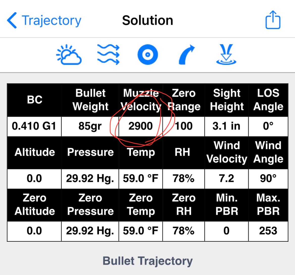

Did you enter your atmospheric data, like temperature and elevation or barometric pressure?
Once you enter temperature and barometric pressure, you can be dead-on with modern programs at 1k.
You need to know your mv though. You also need to know your optic height above bore, measured yourself.
If I don’t measure the critical variables myself, then I don’t trust them.
But mv, baro pressure, and temperature plugged into a modern program (especially doppler) will get you dead-on in my experience.

Yes all the data was entered yesterday when I was out shooting, But again when I reentered the data today its giving me a different output. I'm guessing I may have been in a shitty service area and the app wasn't working properly. I understand to be real accurate I need to know the MV but I was more confused in the difference I was seeing on paper to the app. I will be getting a Garmin eventually.
