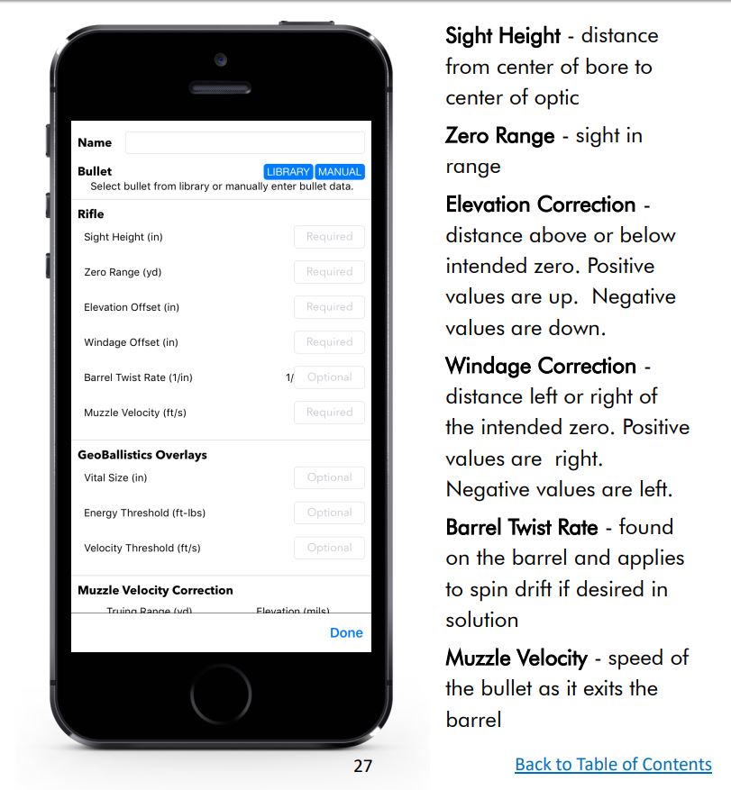

Does anyone know if the app accounts for spin drift and if so can it be turned off? I've read through the 65 page manual but didn't see it mentioned anywhere.
AFAIK the ballistic engine in BallisticArc app does not calculate secondary functions such as apin drift and coriolis.

Thank you. I would think if it did account for spin or coriolis it would have an option to turn them off but I saw no mention of it on the app or in their manual. I wonder if the wind predictions would be valid at longer ranges where these effects might have an impact. I haven't shot past 1200 yards while using the program.
According to the manual on their website it says that barrel twist will apply spin drift. If you don't want spin, don't put in the twist. I have a rifle set up with and without barrel twist and I've never actually noticed a difference in the output with barrel twist added or without.
Thank you for pointing that out. I just testing removing the rifle twist in the app setup. Comparing the solution with or without rifle twist set up, at 1000 yard for 6.5mm ELD-X the difference in windage given by ballisticarc is 0.1 mil. With strelok or AB the difference is 0.3 mil. Something is off with ballistic arc spin drift if it is somehow actually accounting for it.
Looks like you can set the twist rate to blank and save.
Thank you. I'll have to compare the spin drift with some other apps to see how they match up.
From my (limited) experience, spin drift is overcompensated in a lot of software, which is why most people just turn spin drift off. With no wind, I have 2 different apps that will give me .3 mils at a grand. Real world conditions that puts me off of the plate. It's probably shooter error, but turning spin off and using their hold, I'm getting hits. @Lowlight has said something similar several times about spin drift and he has been doing this almost as long as I've been alive.
ETA: I'm also shooting a 6 Creed at about 1000 feet above sea level, so your mileage may vary.
Coriolis is automatically accounted for with lat and shot bearing. Keep this in mind when evaluating spin drift. One scenario you can run is setting location to 0,0 and run solutions in Comp mode at 0,90,180,and 270 deg. Sorry for the late input.
