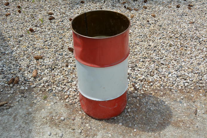

    1 Barrel.jpgThe barrel we used for the outer shell,

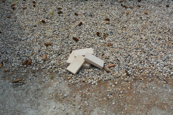

    2 Fire Brick.jpgThe Fire-Brick for the coal base,

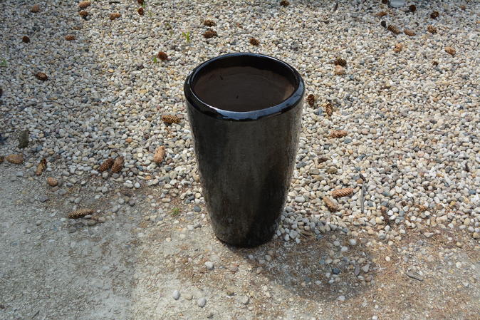

    3 Clay Pot.jpgThe Clay Pot that we used for the Tandoor itself. We cut the bottom off, inverted it, and cut a port in the top rim (bottom, now), for the intake pipe.

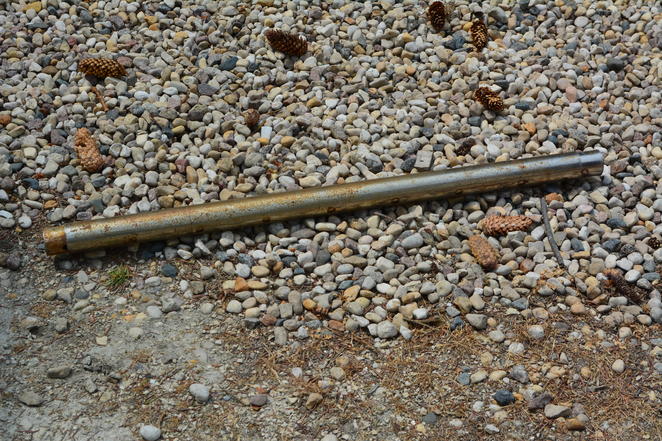

    4 Steel Intake Pipe.jpgThe Steel Pipe we used for the intake.

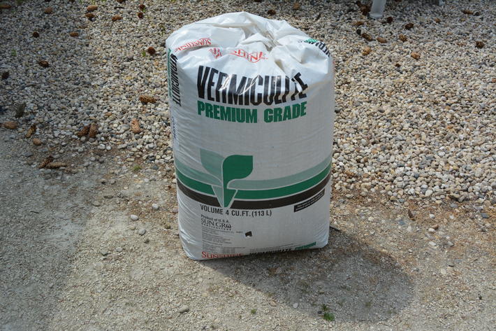

    5 Vermiculite.jpgThe Vermiculite that we used for insulation.

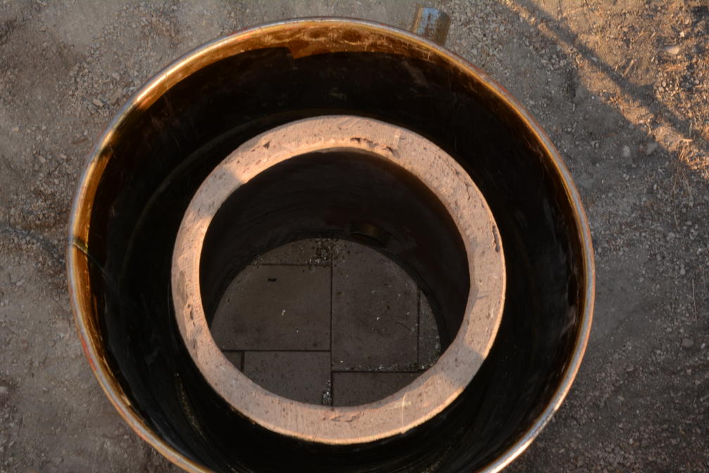

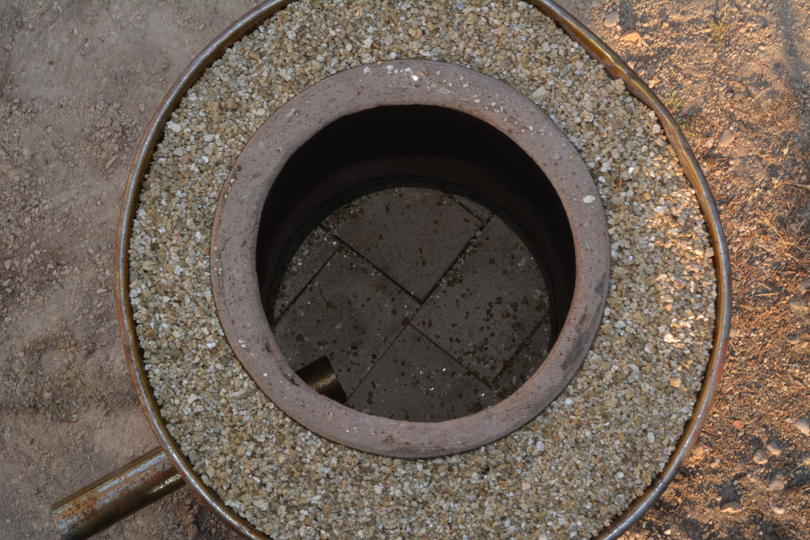

    6 Assembled.jpgHere it is, assembled (from above).

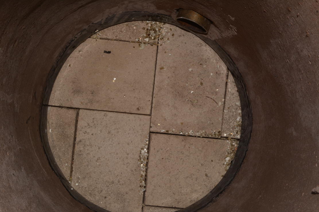

    7 Assembled - Inside Brickwork.jpgBit of a close-up of the inside brickwork (Coal Base) Check it out,,,, last week I couldn't even spell "Mason",,,, now I Are One!!!!
    8 Assembled and Insulated.jpgAnd last but not least, a completed shot, after filling the cavity between the walls, with insulation.

    some vermiculite contains asbestos i hope it's not in that bag.
    fyi it was a while ago tho. google libby montana.when we come across it at work it is treated as asbestos.

    Forgot to add, that aparently (supposedly?) this supplier of Vermiculite is stating Asbestos free, from a Canadian mine. FWIW.

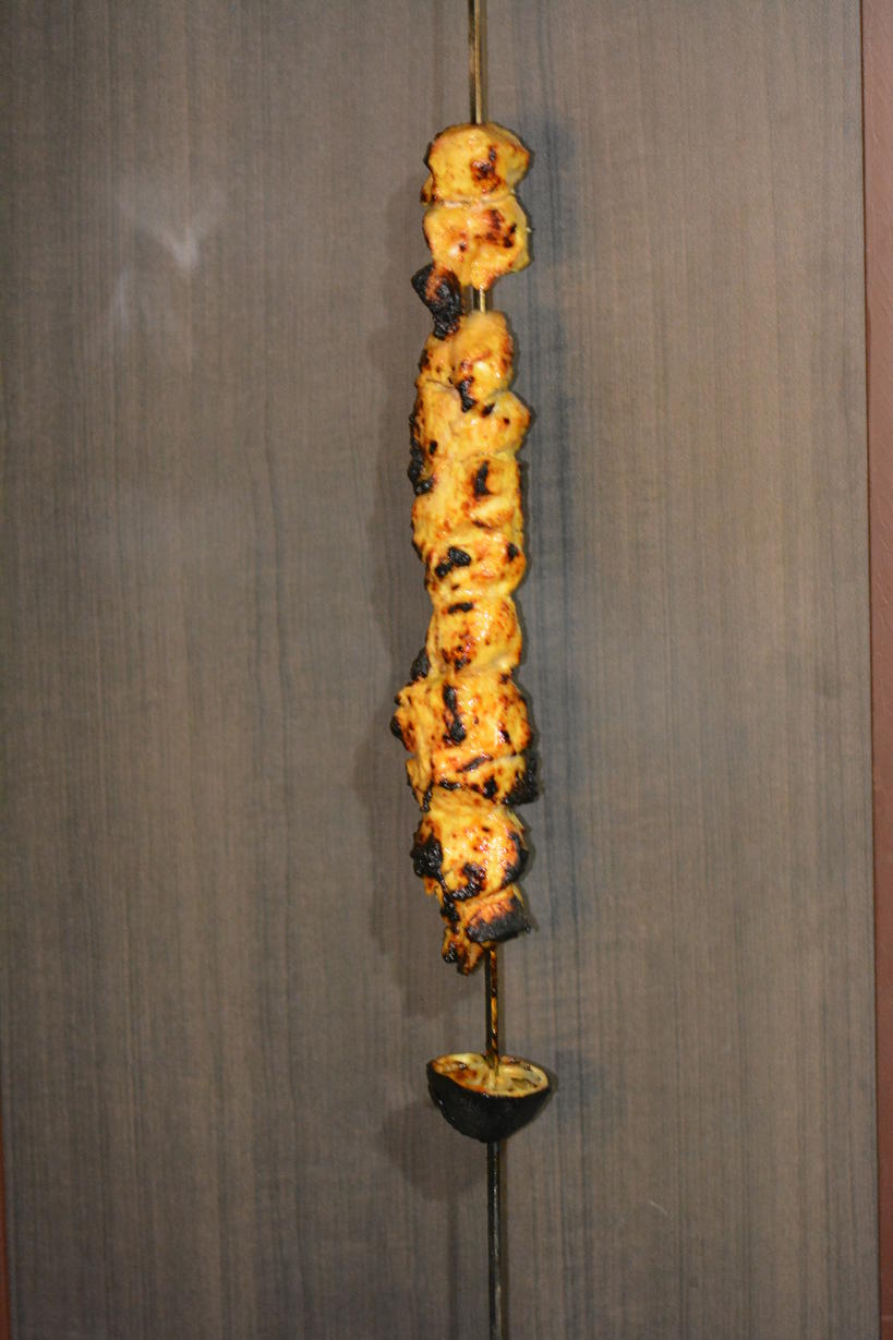

    FWIW, here's our first batch of Chicken Tikka Masala going 'in':
    Chicken Tikka Masala - IN.jpg And then coming "out" about 9 minutes later: Chicken Tikka Masala - OUT.jpg Then added to the sauce, and served:Chicken Tikka Masala - Served.jpg
    Talk about a FAST way of cooking, and holy-crap is that chicken moist and tasty. Seriously ya'll, anyone that likes bbq'd chicken should check this out. We're gonna be trying chicken in so many different way, for sure. But Also Beef, Lamb, Goat, Deer, Moose, Elk, Buffalo, and maybe some Yak!
