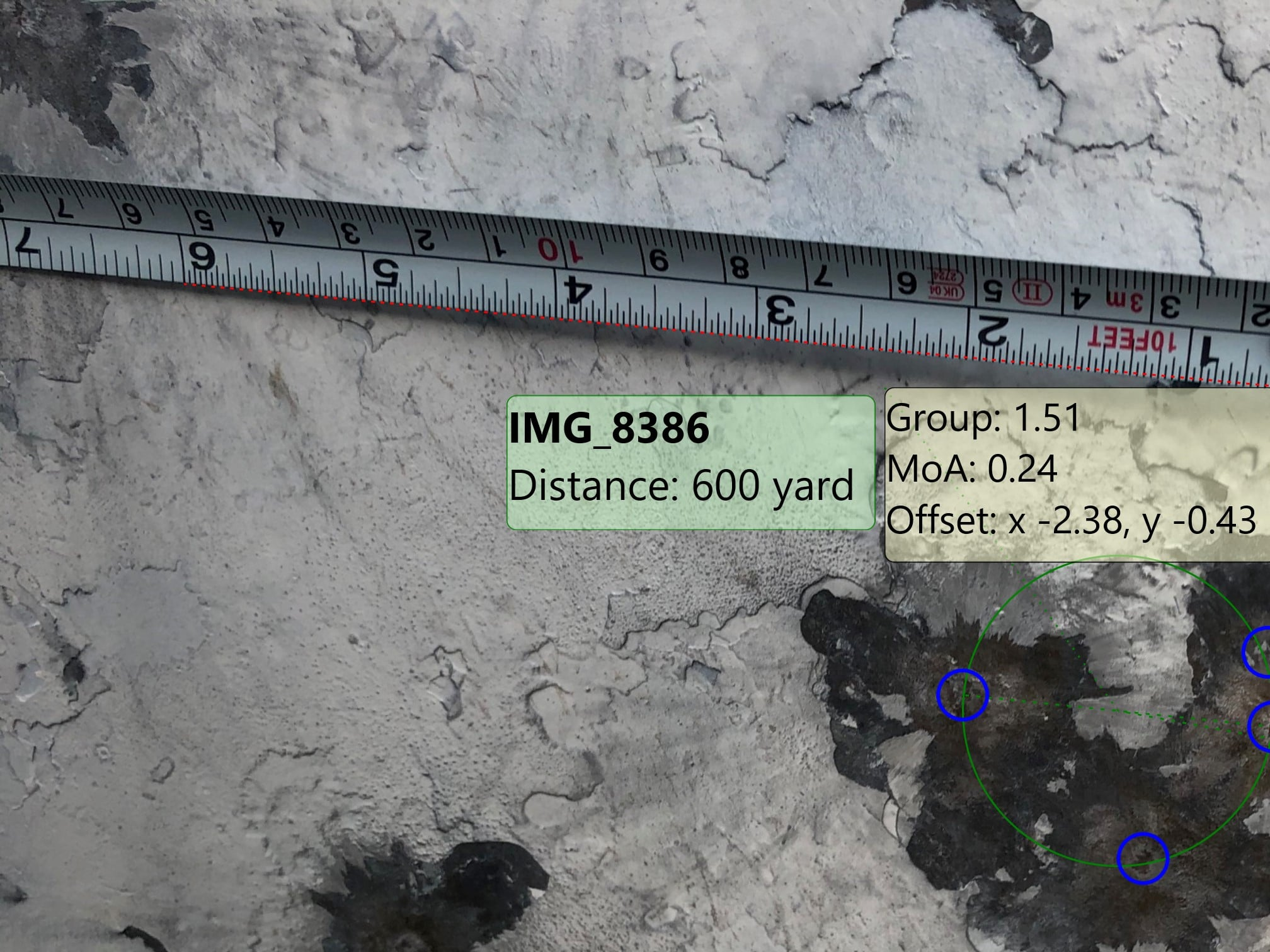

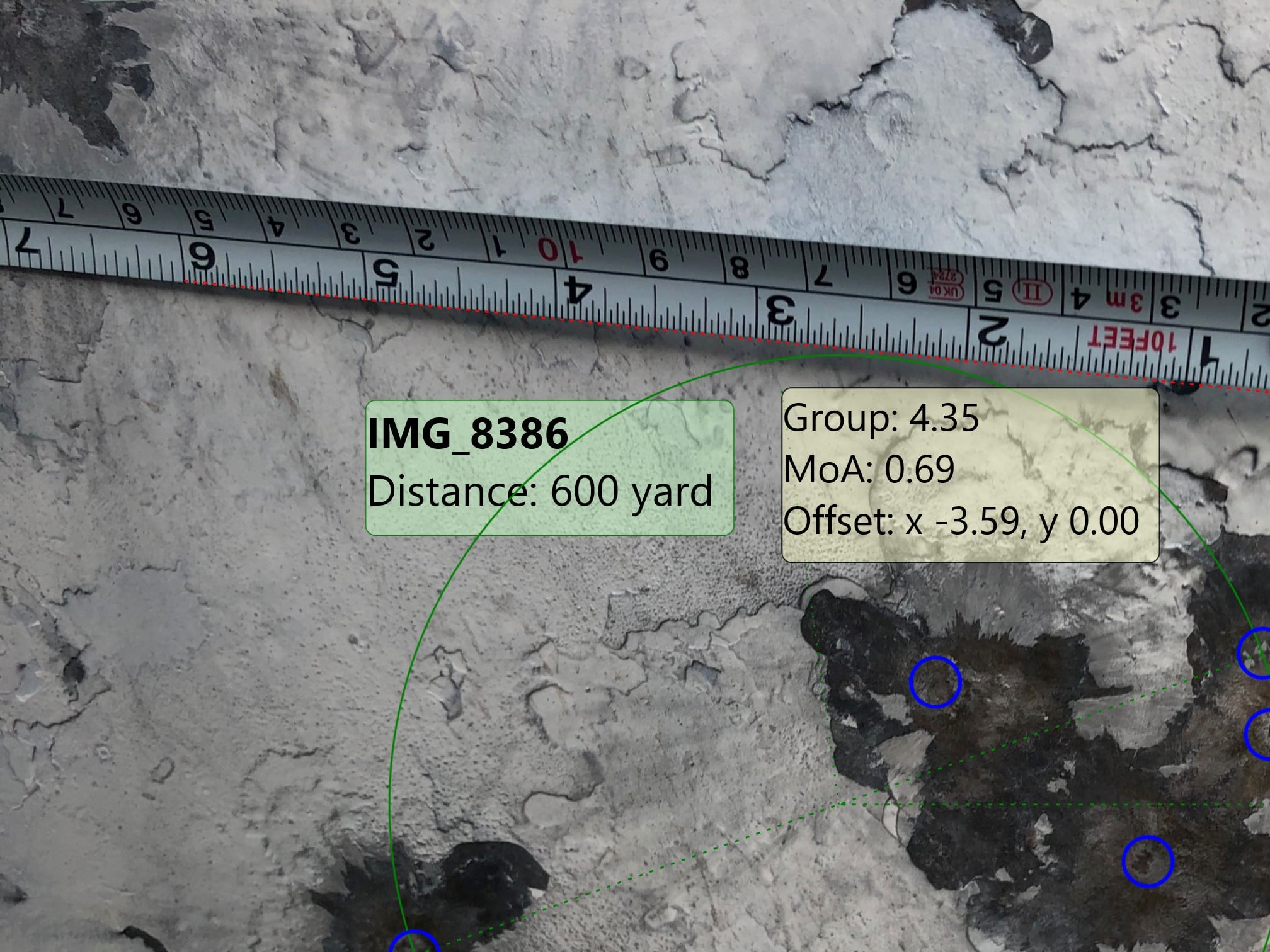

I took these to the range last Friday night. Conditions were nearly perfect. I was able to print a 5-shot group at 600 yards shown below (sub 3/4 MOA). If you throw out the flyer that I called, the group is sub-quarter-MOA. I was unable to print a particularly good group with these at 1000 on the same day, but I can't blame that on the bullet. I feel they have lots of potential. Come-up at 1000 was about 26MOA, and at 600 it was about 12MOA. This is the 145 Match Burner at 2797fps, seated at 2.955 touching the lands.
