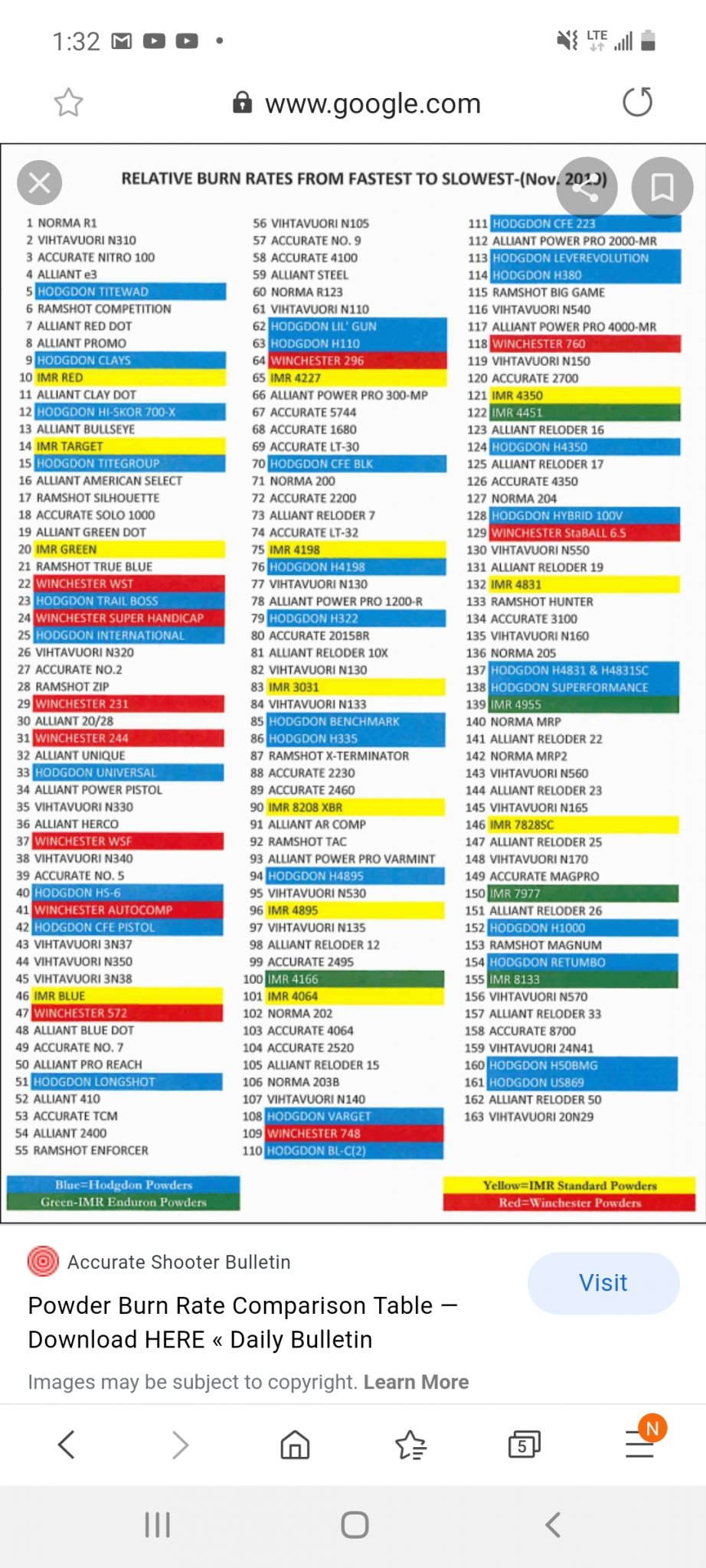

Barnes 50gr. TSX 5.56 powder choice
Triton225
Dec 11, 2019
126
31
What's a few of the better powder cho8ces for the 50gr tsx bullet in a sbr?
Anyone know this, I've heard the comercial component bullet is not the same as the one Black hills was actually using.
I think you'll be okay with anything between CFE BLK, and H4895. You can get slower powders to still work, but their efficiency is not within your window for bullet and powder.
