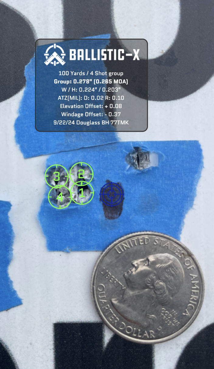

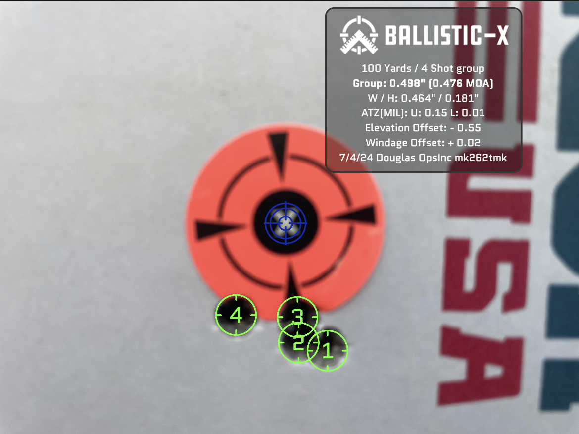

Shoots well put of a Douglas barrel for me. Mostly .6” or less. Black Hills factory. Stand1 makes a load that is hotter and more accurate but they look out of business
The TMK is
Also much more effective terminally than 77smk Better than 50-60vmax. Slightly better than Aac 75 black tip
