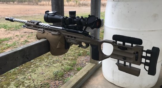

does getting the spiraled or diamond barrel fluting remove a lot of weight from the barrel? Obviously i know it will lose some but i want to keep as much weight as possible, and still have it look cool with the fluting.Ill be honest i dont know much about contour and was planning going with a bull contour thats .936” how does that compare thickness wise to the mtu or comp contour?
How many flutes is that? That is a very sharp looking rifle.The fluting will remove some weight but the barrel is still heavy. Here is my 6mm ARC barrel that is a Proof Comp Contour with spiral fluting. It does look pretty cool.
Thanks. It's 7 flutes.How many flutes is that? That is a very sharp looking rifle.
