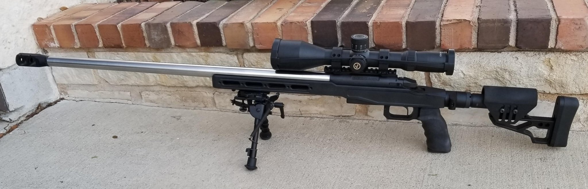

This time I did very thorough research on the builder, Alamo Precision Rifles of Hurst, Texas. The company is owned and run by two fellow combat veterans. Their work is just absolutely incredible. I personally examined 5 of their builds. Those rifles were phenomenal. I shot one and it was 1-hole gun. But to tell you how honest the owners, Robert & Jason are and how high of integrity they have what they did for me says it all. I stupidly did no research at all on Tactical Rifles in Florida when I ordered the 1st of 2 rifles from them. The 1st rifle came out ok, at least out to 200 yards although I was overcharged more than a little. But the 2nd rifle, a 6.5CM, ordered 3 years later was an absolute horrible nightmare. Everything about the rifle was done wrong or so poorly that the $4300 gun was completely useless. When I contacted Tactical Rifles about all the problems I was treated in an inexcusable, rude, derogatory, insulting manner. I've never allowed anyone to speak to me in that manner. That's when I went back & did the research I should've done initially and found case after case of customers paying ridiculously overcharged prices, getting a gun that was useless and getting no satisfaction let alone making the problem right by Rooney the owner of Tactical Rifles. I got the same treatment the others before me did. I was afraid that I couldn't get anybody willing to work on the rifle as it was such a screwed up piece of junk. But not only were Robert and Jason at Alamo willing to take on the project but were so incensed and angry that a brother combat & disabled vet was cheated and basically stolen from, they completely refused to charge me any labor for repairing everything that was wrong. And it was everything. The barrel fit was so bad they had to cut off .060 from the barrel and set it back. Thry had to cut a new chamber and lead in. They also to recrown the barrel as it was not true. The bedding had to be machined out and rebedded. The bottom metal was replaced because it was cheap junk and improperly fitted. Even the barrel channel in the stock was crooked with barrel not running straight and true. They replaced the fire control unit with a high quality Gretan (I was charged for the high end unit by Tactical Rifles but they actually used a stock Remington). Alamo has over 7 hours of labor in the rebuild of this rifle yet refused to charge me for the labor. Well I was so humbled by what they did for me and the care they used in doing the work that I paid them to repaint the stock as it had gotten chipped and to bead blast the barreled action to remove the cheap epoxy paint that never cured and got all over my hands whenever I touched the rifle. I had them properly apply cerakote on the metal and oven-cure it. So between all this work that I saw with my own eyes and almost a DOZEN positive recommendations from gun dealers and customers, I am confident that I have found my builder. Attached is a photo after they completely rebuilt the gun and refinished the stock and action.
That's really awesome to hear they are treating you above and beyond and I'm glad someone is taking care of you
I hear they do really great work and Dave Preston is shooting for them now which says a lot
Make sure to post pics when you get it

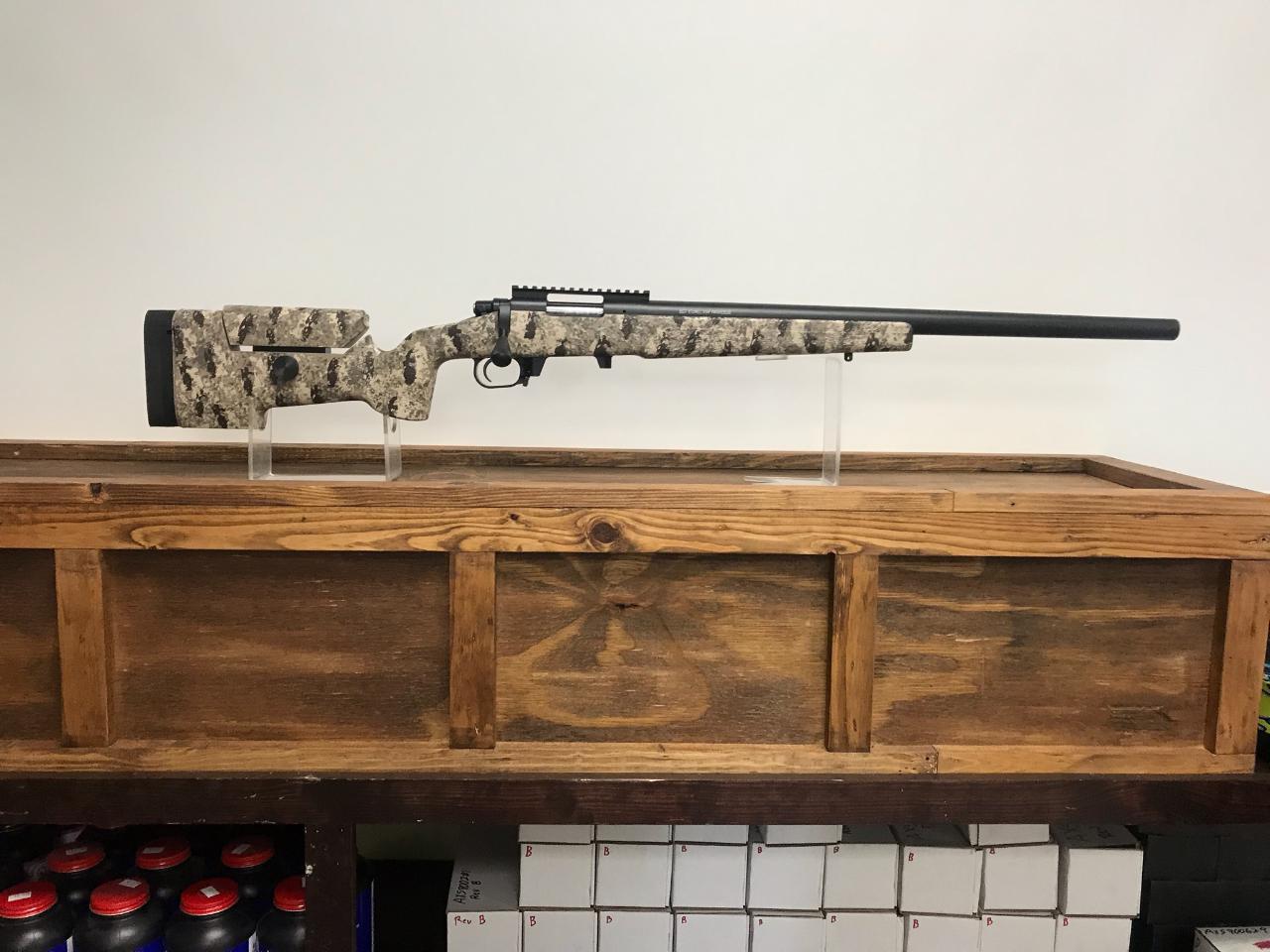

As mentioned in my previous posts, I was the victim of a crooked, lying thief when I had my 6.5 Creedmoor built. I won't go through the long story and all the gory details again. But I will say that Robert Wagoner of Alamo Precision Rifles in Hurst, TX took a complete P.O.S. rifle that couldn't even be shot and turned it into a beautiful work of art and a true precision rifle. He also stripped the sorry epoxy (more likely Krylon) from the metal and applied a true, beautifully done cerakote finish on it. Also re-finished the tan McMillan stock with a really great looking mulit-tone camo finish. I am attaching a photo of the "new" rifle. I took it out last week to do the sight-in / barrel break-in. After finishing the barrel break-in, I then shot to try get a nice target. What was interesting was a 100 yards using 140 grain OTM rounds, it shot two 3-shot one hole groups. I was ecstatic. But then I switch over to Federal Gold Medal Berger 130 grain OTM rounds. The Krieger 6.5CM barrel doesn't seem to like the lighter 130 grain rounds as it was not 1-hole groups at all like it was with 140 grain bullets. In fact, I had difficulty trying to get super tight groups with the 130s. Yet with the 140s, 1-hole groups at 100 were almost automatic. But we've all seen it before where a rifle just loves one particular brand / type of ammunition and just not at all like a another kind of ammunition. Here us the photo of my "new" 6.5CM that I totally consider an Alamo Precision Rifles and NOT a Tactical Rifles.net rifle anymore. We even polished off the TR logo since Alamo Precision re-did everything including cutting, setting back, rechambering and recrowning the barrel. Too bad it doesn't like 130 grain. But lots and lots of good 140 grain bullets and factory loads available.
