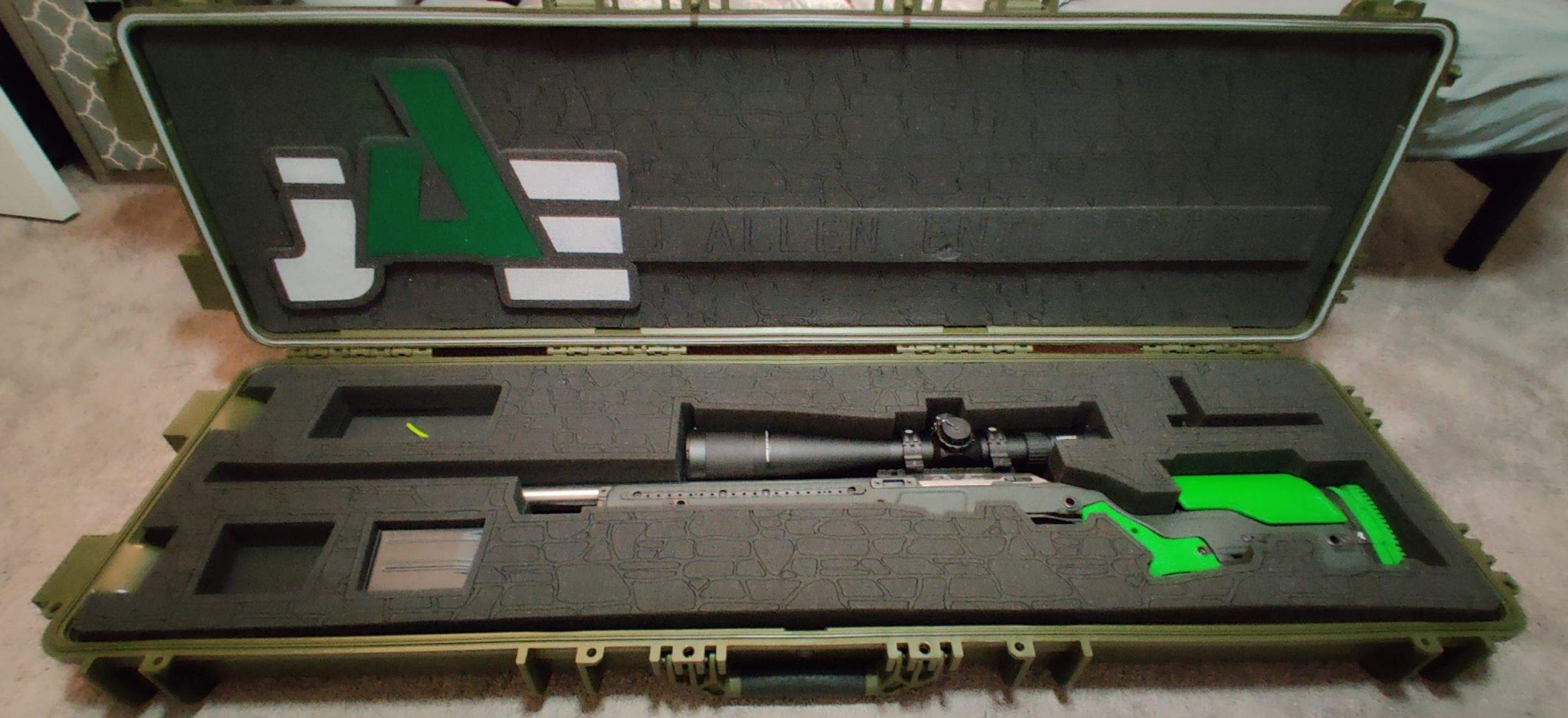

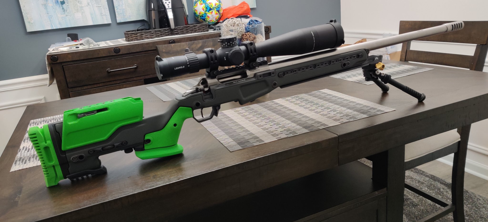

    So, good bit of water has gone under the bridge since my opening post and I thought to just update the thread as so many of you were kind enough to share your experience and give me a steer.
    Made a bit of progress with the Rem 700 5R. Mainly, put a Jewel trigger in it, had a KMW Loggerhead installed for an adjustable cheek piece (sorry, but it is REALLY a comb...talk to any stock smith 😁), but since the action was out of the stock, we took the opportunity to skim bed it. It was easy to see that the action was only touching the bedding block in this HS stock in two very small areas right at the action screws.
    The bedding seemed to really tighten the gun up...in my limited opinion.
    As for the Gradous gun that was the cause for me starting this thread in the first place, I'm sure many of us know the tragedy that struck the Gradous family. I don't want to go on about this much as I don't want to seem to claim a close relationship with Robert. That wouldn't be true. But we did talk on a number of occasions and he was such an incredibly honest, open, and humble guy that its easy to feel you have known him for years. He shared a lot of his current situation with me and I told him about my past similar situations. All in all, I found his passing to be incredibly sad still to this day.
    In looking for a J Allen 700 chassis I ended up finding a completed gun within driving distance. 21 rounds through (barrel break in only) in pristine condition.
    It is:
    JAE-700, Gen 2, w 2" ARCA
    Seekins Havak
    TT Diamond trigger
    Proof Research SS MTU finished at 25" spun by Paradigm Gunworks in Tulsa
    Piersons Precision "Muscle" self-timing brake
    ARC rings (and I LOVE these suckers and am hard pressed to find a reason to ever buy a different brand for rings)
    Leupold MK V 5-25 x 56 with CCH reticle (not illuminated but hey, can't have everything)
    Atlas BT-10 with Area 419 ARCA adapter (with pins removed)
    Custom laser cut hard case
    If I was building the gun from scratch, I'm not sure I would necessarily go with MTU or Seekins for the action, but its still a top shelf custom gun, the gun shoots great (way better than I do) and I got a very good price on it.
    Also, the guy I bought it from loves "loud" (that's his way of describing it). The lime green furniture is his preference. Me...well, its grown on me but if he comes up with black furniture, we will trade.
    Pics
    I want to thank everybody who responded to my cry for help in the opening post and took the time to reply. In particular very grateful for the help from: @Supersubes , @Steel head , @Vargmat , @DownhillFromHere , @moosemeat , @kthomas , @LeftyJason and anybody I missed LOL
    Cheers
    Awesome rifle but a bit loud for my taste.
    Not horrible though.
    JAE’s are really comfy to get behind.
    haha..yeah, its loud. This fella also loves the bright yellow that they offered....I believe he has it on a black JAE. Different folks is why they make different colors....well, since Henry Ford said that they could have it in any color they want, as long as its black! haha
