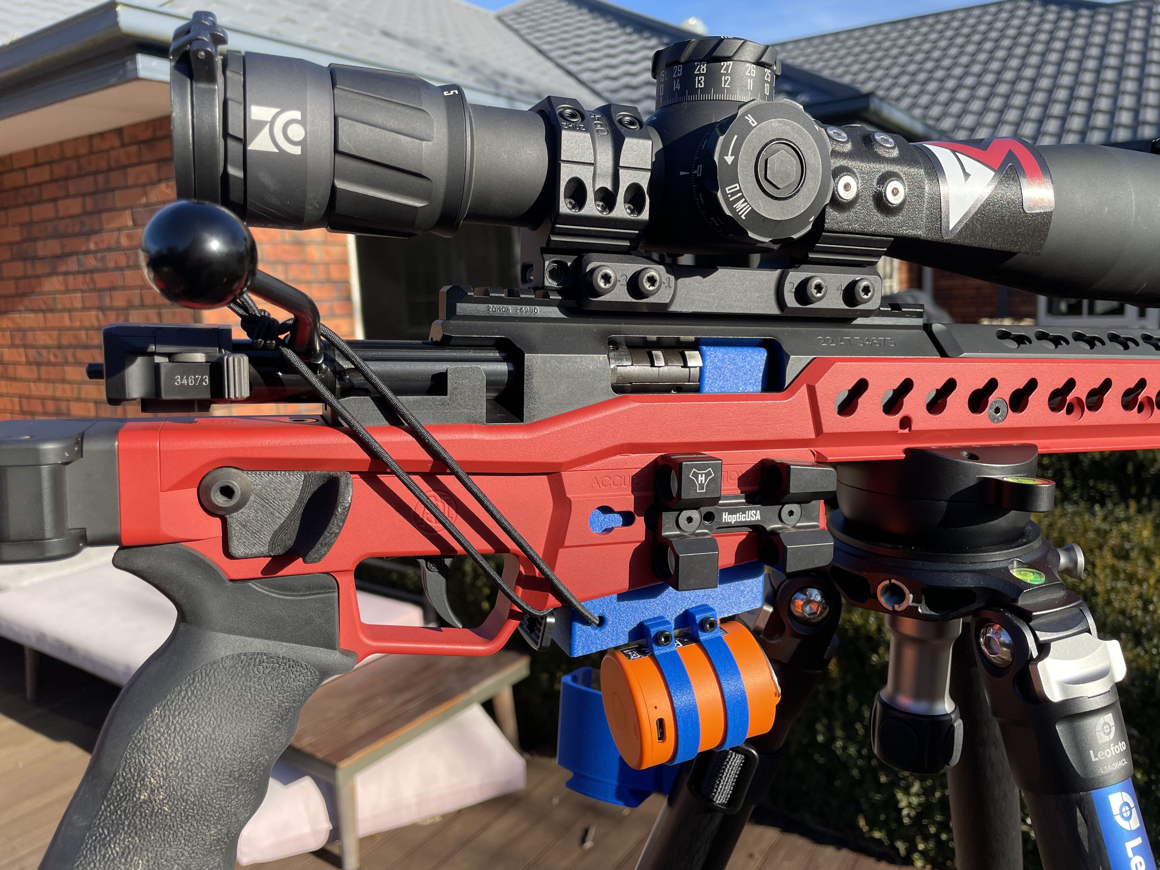

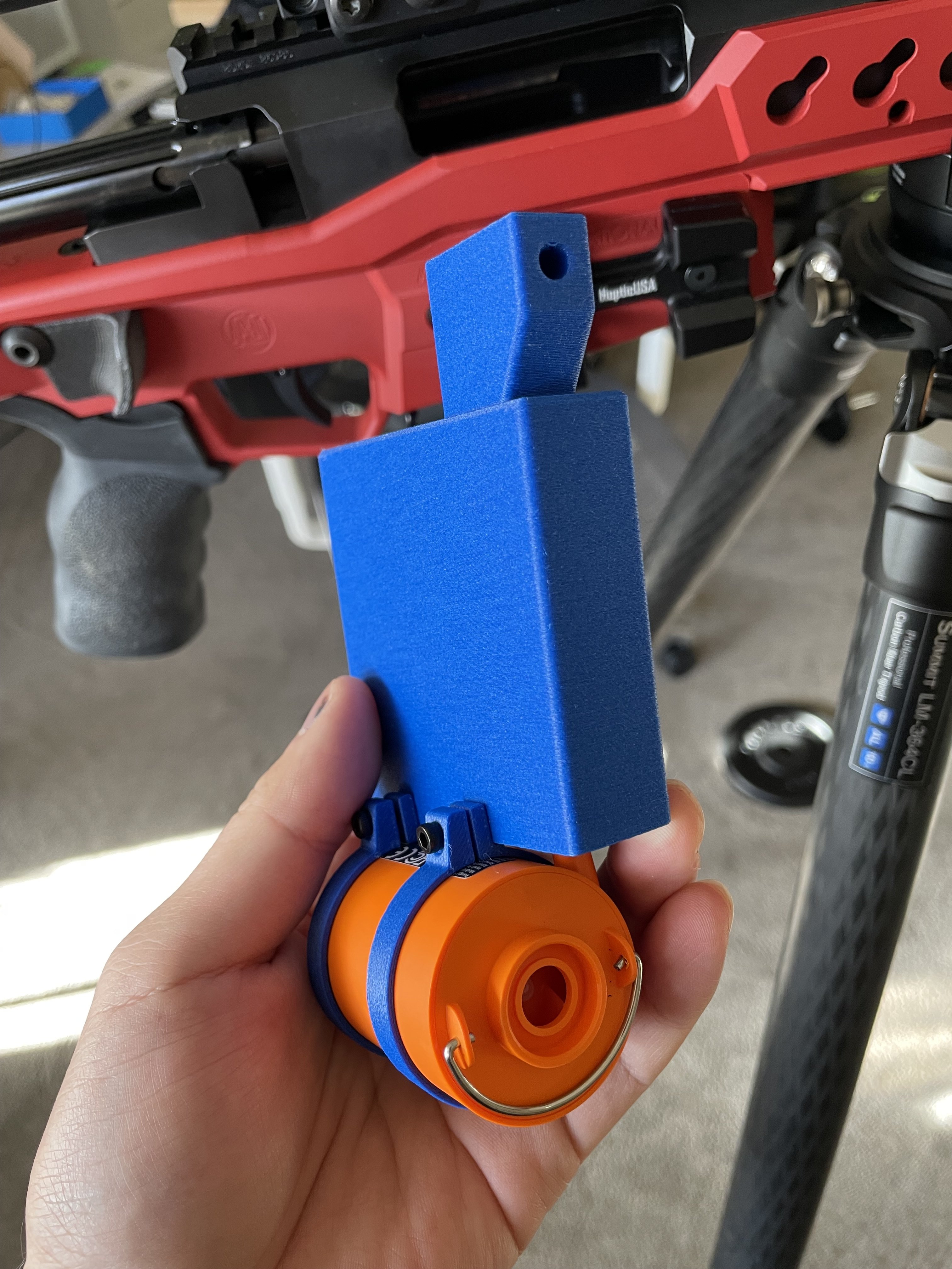

I made one.
Printed this:
Bought this:
Amazon product ASIN B07L9M8T8Fand
Amazon product ASIN B094G1GL8T
Works OK for the $15 I have in each of them.

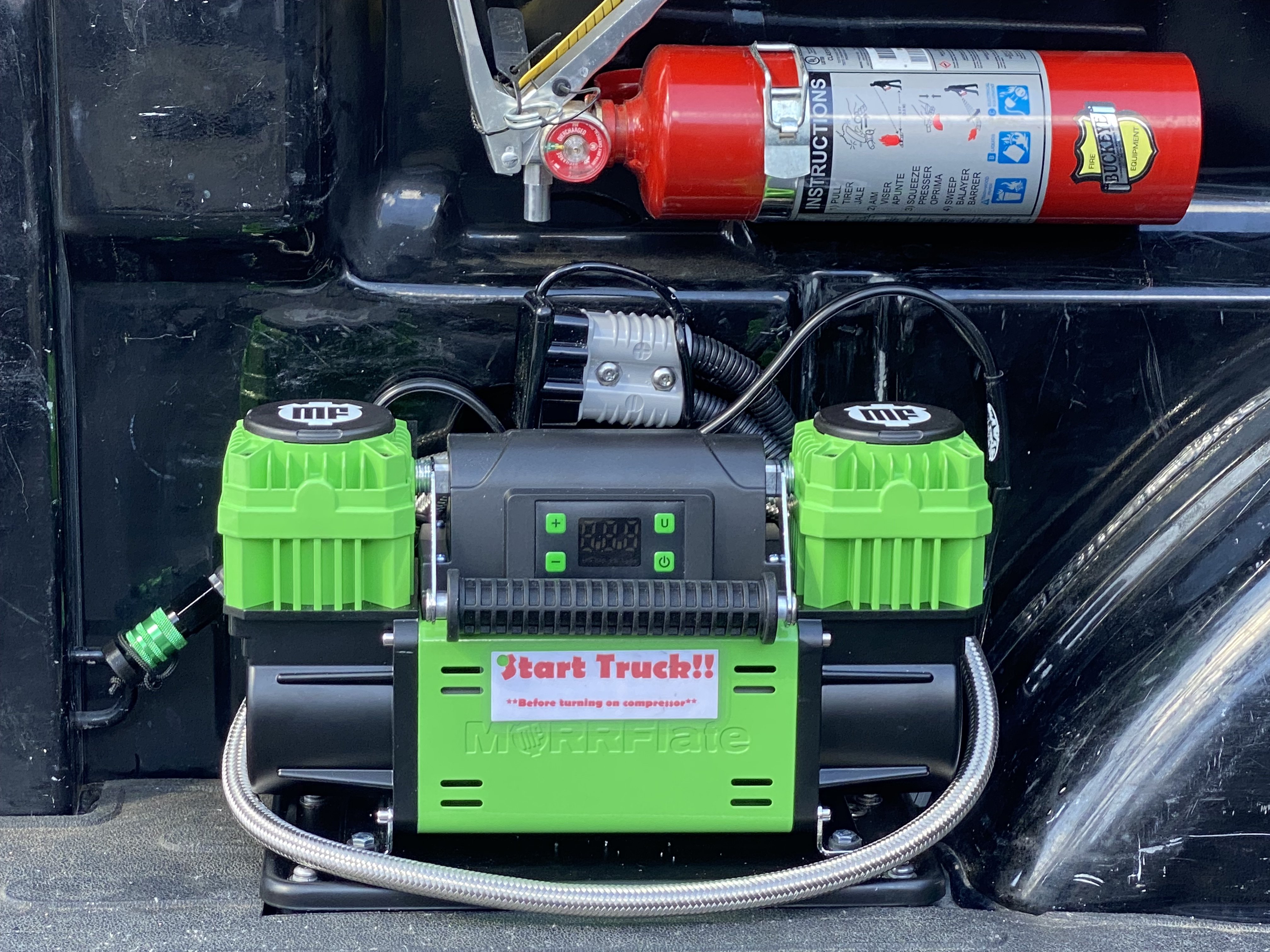

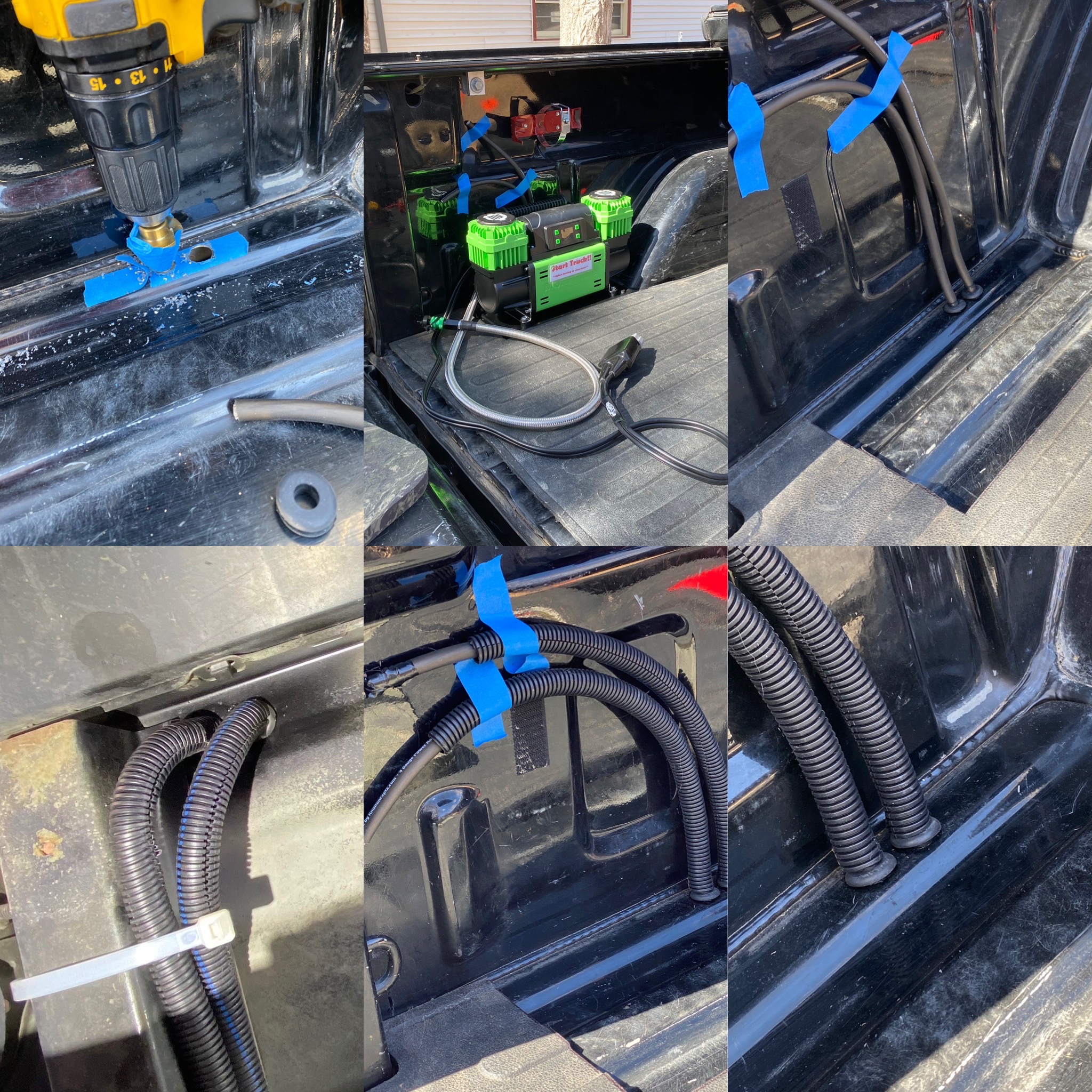

Yeah I was going to riv-nut one in the bed corner, or go all under

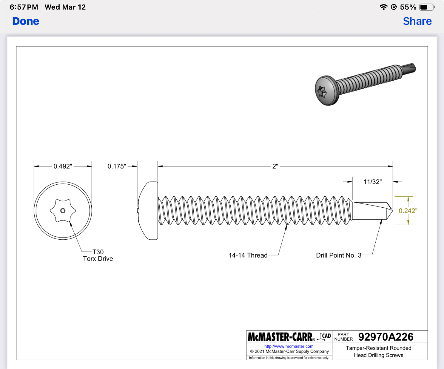

Riv nuts would be awesome! I cheated and used high grade heavy stainless security sheet metal screws. My time was mostly spent running 4 gauge high strand tinned cable to the bed in plastic loom with 24k gold plated lugs and a 250 amp breaker. I terminated at an anderson plug.
I have auto deflators and a four tire inflation hose system. With this setup after hunting I run the hoses, set the pressure jump in the truck to stay warm or cool while it pumps all four tires from 15 to 45 psi in around 6 mins. And shuts off automatically.
Adding a tank is my next move.

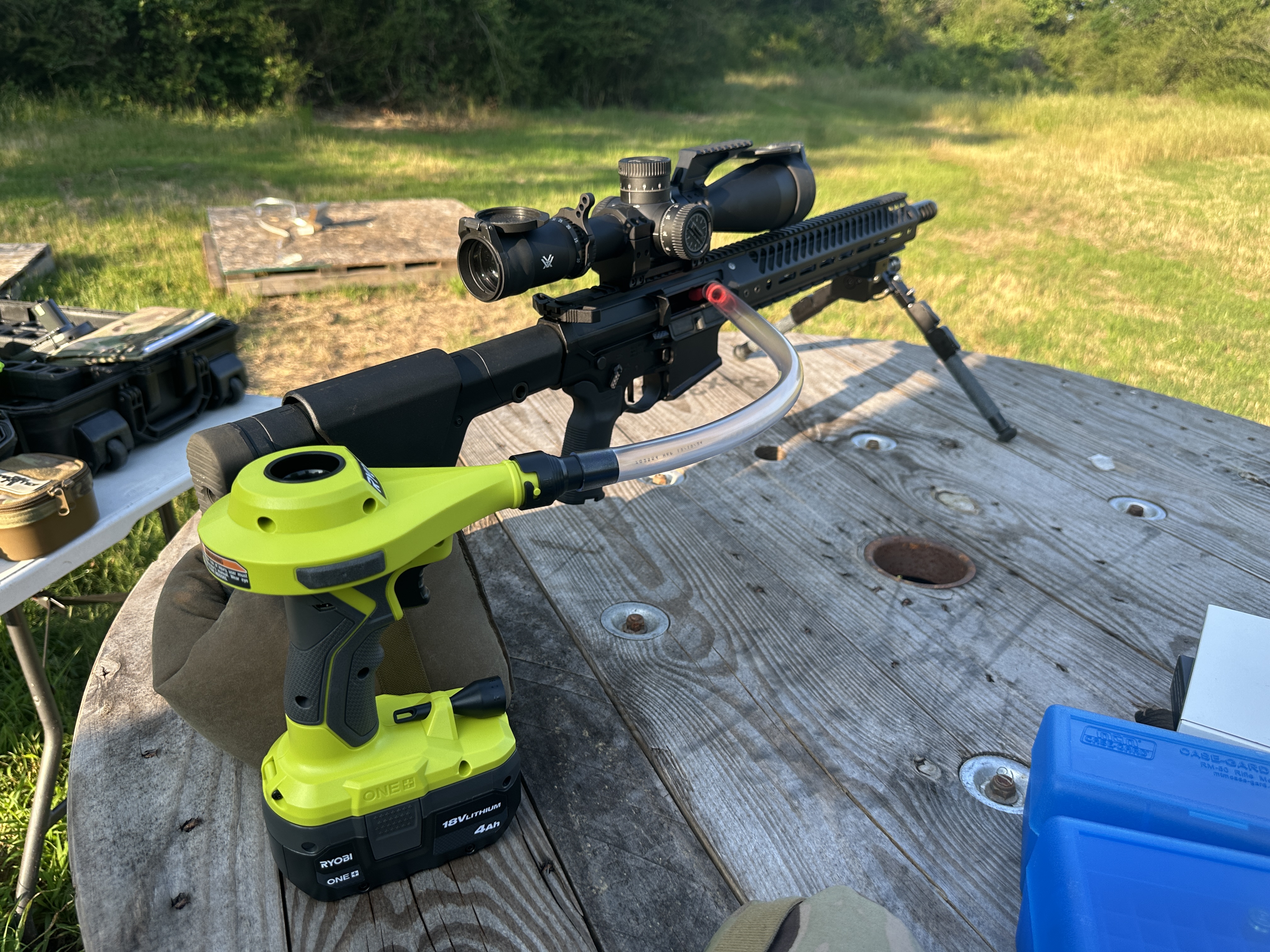

This topic brought up not too long ago. Use similar setup. Mine use the horrible freight version. Think all major brands have a version of this inflator. If you have cordless drill check your brand line up that way don't have to get different batteries. The one I have moves quite a bit of air, doesn't take long to cool off. Rechargeable batteries is a big plus.
