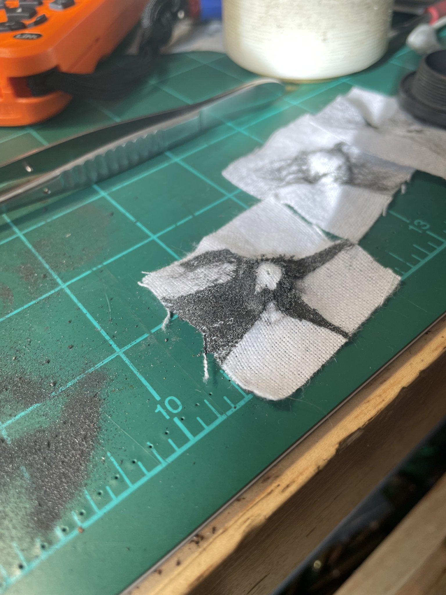

Looking for some insight. If someone were to “theoretically” fire 13 rounds of .338 lapua through an MRAD barrel that had unknowingly become fouled with a significant amount (think a teaspoon or more, deposited/recirculated throughout the string of fire) of what I’m assuming is titanium powder, how much damage would be done?
Thanks in advance.
Borescope’s in the mail….
  • Wow
Reactions: Cody S
How was the powder introduced? if it was from a suppressor issue I would expect it to be expelled or retained in the can. The back pressure should have pushed it out the front.
Suppressor issue, brand new, no damage to the can, alignment was confirmed.
I would have thought the same.
Titanium rifle powder?
DMLS powder from a new silencer
At the moment I’m not trying to put anyone on blast. I’m not a physicist so I can’t answer the how it got there, but it did. Here’s how my range day went Wednesday:
Picked up two new cans from my dealer Tuesday. They are the same design (direct thread DMLS titanium), from the same manufacturer. One is a 30 cal and the other is .338.
Wednesday I took them out. Both hosts were clean. Alignment was checked with alignment rods. .338 can was mounted on my mrad, I fired 13 rounds. My groups were opening up so I took a break to try the .30 cal can. I fired 5 rounds through my Spear LT in 300blk and it malfunctioned (on video) cleared the weapon, found the action, chamber, barrel and ammo to be covered in a metallic sand like material (have some in a bag now)
Went back over to the mrad and found it in the same condition. Packed my shit, went home, cleaned everything. At home I dumped more of this material out of both cans. I’ve got pics of everything along the way.
Customer service has been contacted and I haven’t got a reply yet.
I was pretty worked up when I posted initially. Those are the circumstances, my question is the same, anyone been there and how much damage did it do?
I’ll be able to shoot again this weekend hopefully and I can report back.
The rifle was a shooter, hope it still is.
Reactions: Cody S
that is and incredible amount and I personally find it impossible that it DIDNT coitus up the barrels to some degree. 13 rounds doesnt seem like a lot but with that much powder thats a lot of abrasive being ground into the steel.
I'd maybe try shooting it once all cleaned out to see if it shoots better but I'd be working hard to make the suppressor manufacturer replace both barrels and the AR bolt.
Reactions: Cody S
How did it back flow into your barrel? I am new to this sort of fouling, shouldn't the debris blow out the muzzle end by design?

Even one round fired over that material in the bore is going to do damage.
Each deposit of powder back into the bore would settle at the 6 o'clock position in the bore before each succeeding shot was fired. With several rounds fired before you figured it out, I would expect that you will see more damage on the bottom hemisphere surfaces of the bore rather than evenly distributed.
Regardless, you have every right to be quite upset.
Reactions: LRRPF52 and flysolo
Is that sintered powder from a “dissolved” baffle? Or just a ton of powder that was stuck on the interior of the canon that shook loose after the first (or third, whatever) shot?
That’s pretty crazy and embarrassing for the manufacturer.
It's specifically leftover titanium powder that gets trapped in the baffle recesses or didn't get purged after the DMLS process. The issue has been so common lately and combined with the sheer amount of leftover titanium powder (compared to products produced 1 or 2 years ago) is leading people to believe that CGS has stopped the post print purging process.
CGS basically tells customers to shoot it out of the can with supersonic ammo and that you'll know it's completely out when the can stop throwing titanium sparks out the front end. Unacceptable in my opinion.
For folks that are curious, just Google "CGS titanium powder," "CGS titanium dust," "CGS debris". Most of the experiences will be on Reddit, where the vocal users used to be hardcore CGS fans.
There’s no visible damage. Looks to me like material was freed up after firing. I handled both of them quite a bit leading up to shooting them and nothing fell out or rattled around.
Huh. Wonder if they missed a cleaning step after, ah, printing? if that’s the right word. Sounds weird to say lol. Edit: didn’t see @Evintos explanation above.
I have seen 3D printed cans spark when fired new. I think I’ve read somewhere that it was normal and it stops after some number of rounds (can’t remember the number). Obviously nothing like the titanium glitter pouring out of your can.

DMLS powder from a new silencerView attachment 8327289
That's coming out of the can? That's what I thought you were saying in the original post but I wasn't sure and wanted it clarified and might have sounded silly in the way I asked it....LOL!

I did every reasonable thing I could come up with to flush the cans out. Yesterday I put the Hyperion on my .260 and fired a round without the end cap on. There was a little metal powder on the crown of the muzzle, enough that I didn’t fire another round. Ran a few patches through it, first one had just a few flecks in it.

It turns out, I have no idea what I'm looking at with a borescope. Cool toy and all but yeah. The timing was also unfortunate as I was shooting up the last of my factory .338 ammo when this happened, and I have no intentions of buying anymore.
I took a guess and loaded up 30 rounds in new Lapua brass with 285eldm's and a grain under max load of Retumbo. That averaged just under an inch. I would assume I can bring that down where it belongs with load development, but I haven't had a chance to do that yet. That's why I haven't updated this post.
I did talk to customer service right after SHOT, I had a direct # from emails when I first bought the cans. That call was pretty neutral. They said that this was an issue they were aware of, that it was limited to a period of production and that they now take measures to prevent these from going out (cutting a number of cans in half out of each batch to check for debris). I asked for nothing and they offered nothing. They said to reach back out if I did have issues with the rifles.
The Hekate cleaned out fairly easily. The Hyperion on the other hand was packed with what must have been ounces of hardened material and it took a significant effort to remove it all.
