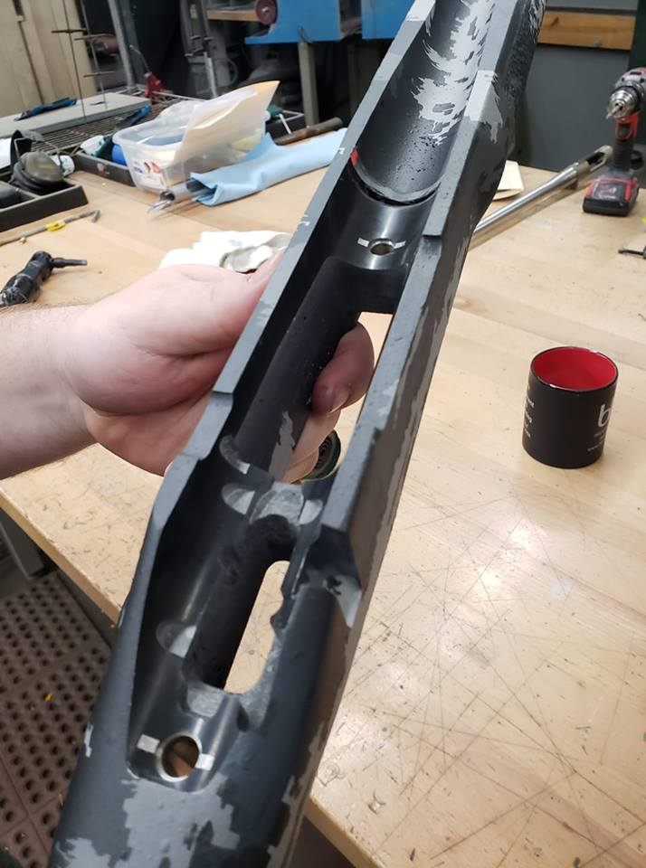

Below is a small example. Once coated a Nightforce and decided to do the knobs as well. Then just fixtured it up in the 4th and engraved the turrets again.
