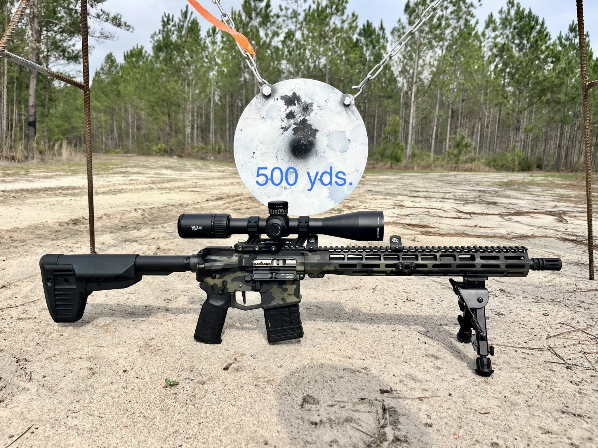

Anyhow this is my 16” build I made with a CLE 16” Tactical profile Douglas 1/7 barrel. Love it

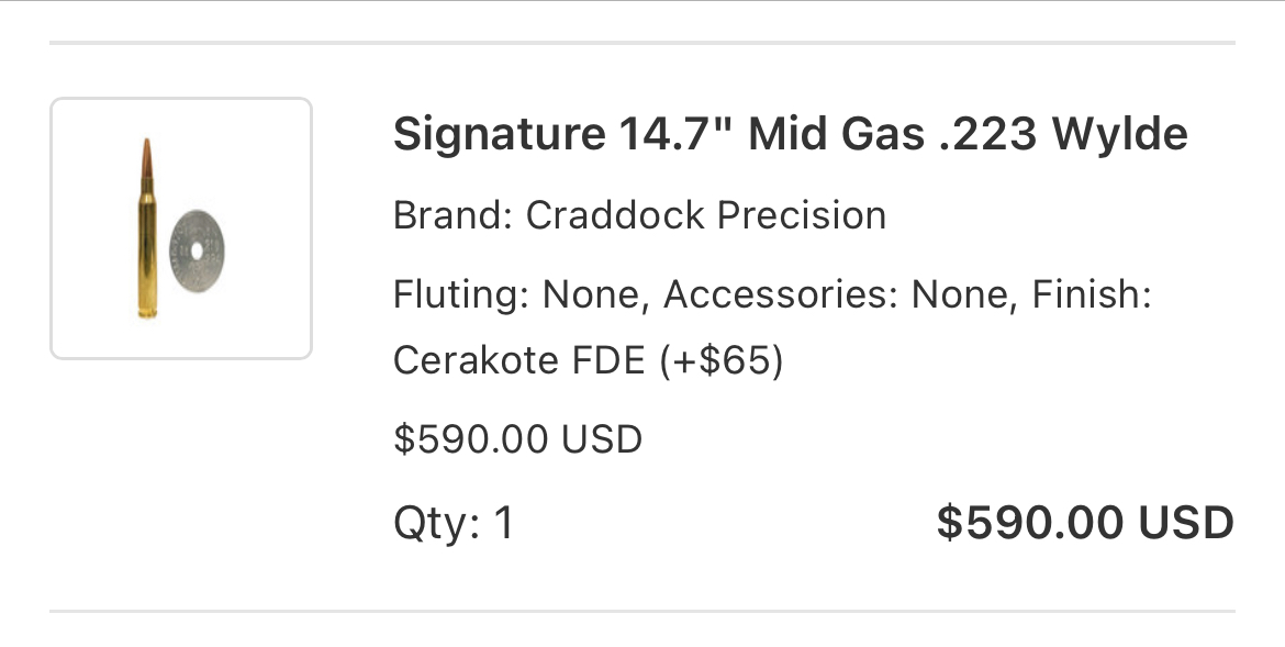

lead me to Craddock Precision😁 there’s a lot of great manufactures mentioned here, but after speaking with Paul at Craddock, I pulled the trigger on this guy:

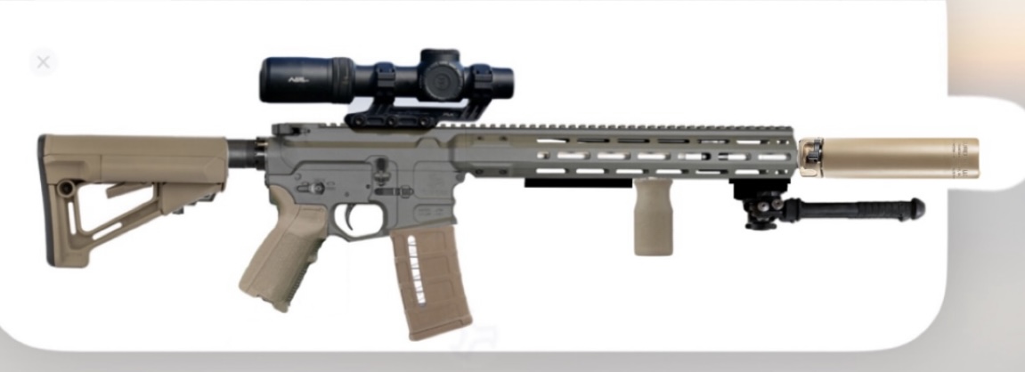

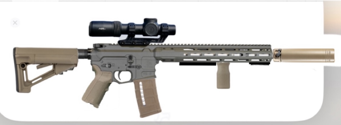

Craddock is gonna cut the barrel down to 13.9”. Cobalt Kinetics is building it out and it will ultimately look something like this:
