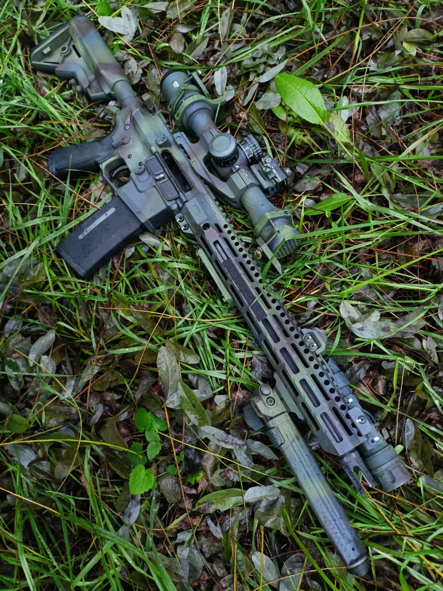

I'm using a 12,5" .223 of an italian manufacturer with "his" Lothar Walther 1:8 and a 1-6 lpvo (PST 2 vortex) to play with steel plates at ~400m and sometimes even beyond.
This stuff is really fun and I enjoy learning all the things about ballistics, so I wanna go for a more performing setup without having it fully dedicated to this anyway.
I'm thinking to swap optic (going for a 2-10 pst2 vortex) and barrel:

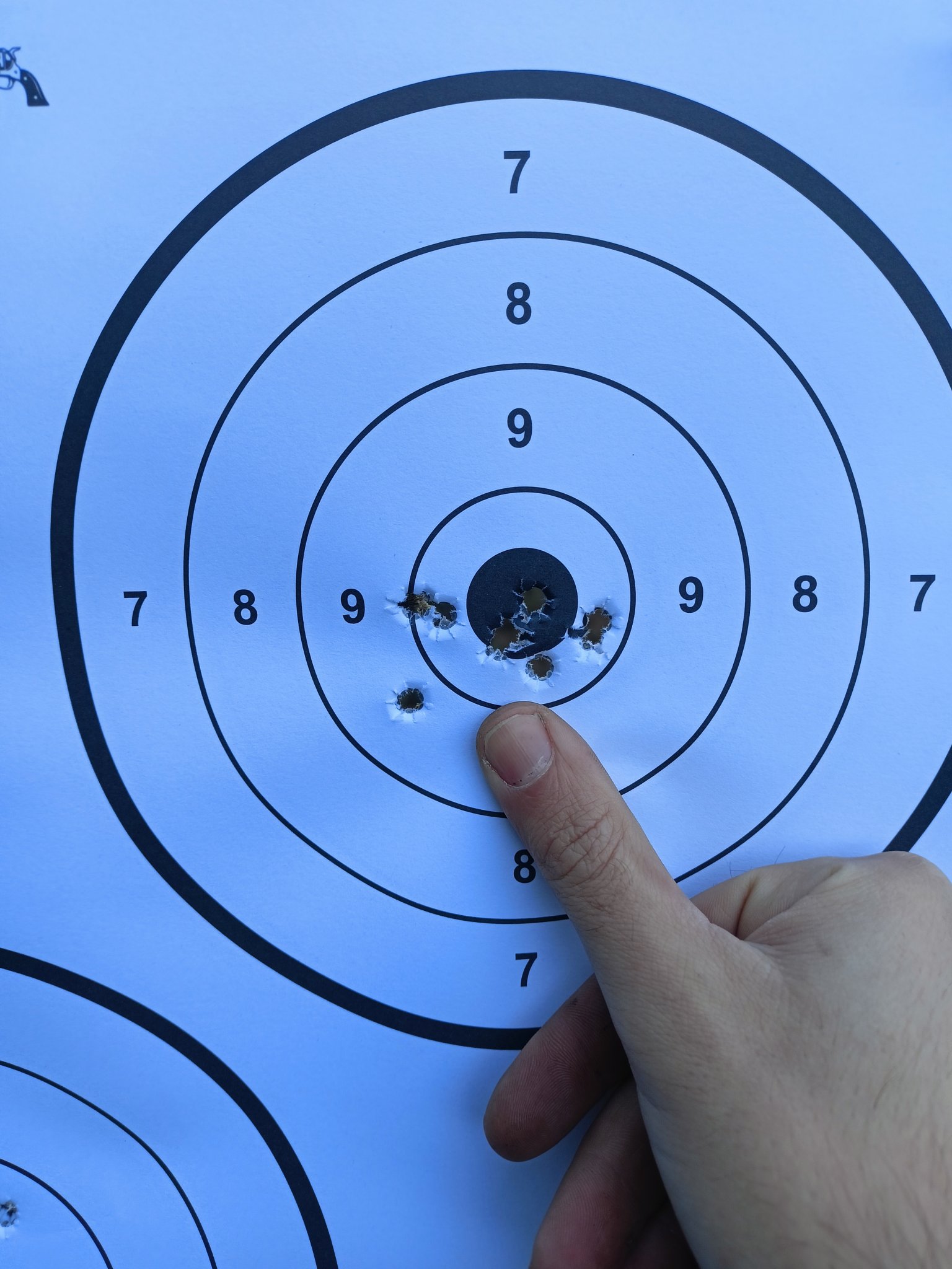

Hi guys, I'd like to thank you again for all your inputs.
As I stated after all the suggestions, I decided to go with a 1:8 14'5" Sabatti multiradial rifling (MRR) barrel blank finished by an italian artisan (DR15 Custom).
One of my requirements was that it HAD to shoot 1.5moa with Fiocchi 62 fmj because of cost and availability of this ammo here in Italy.

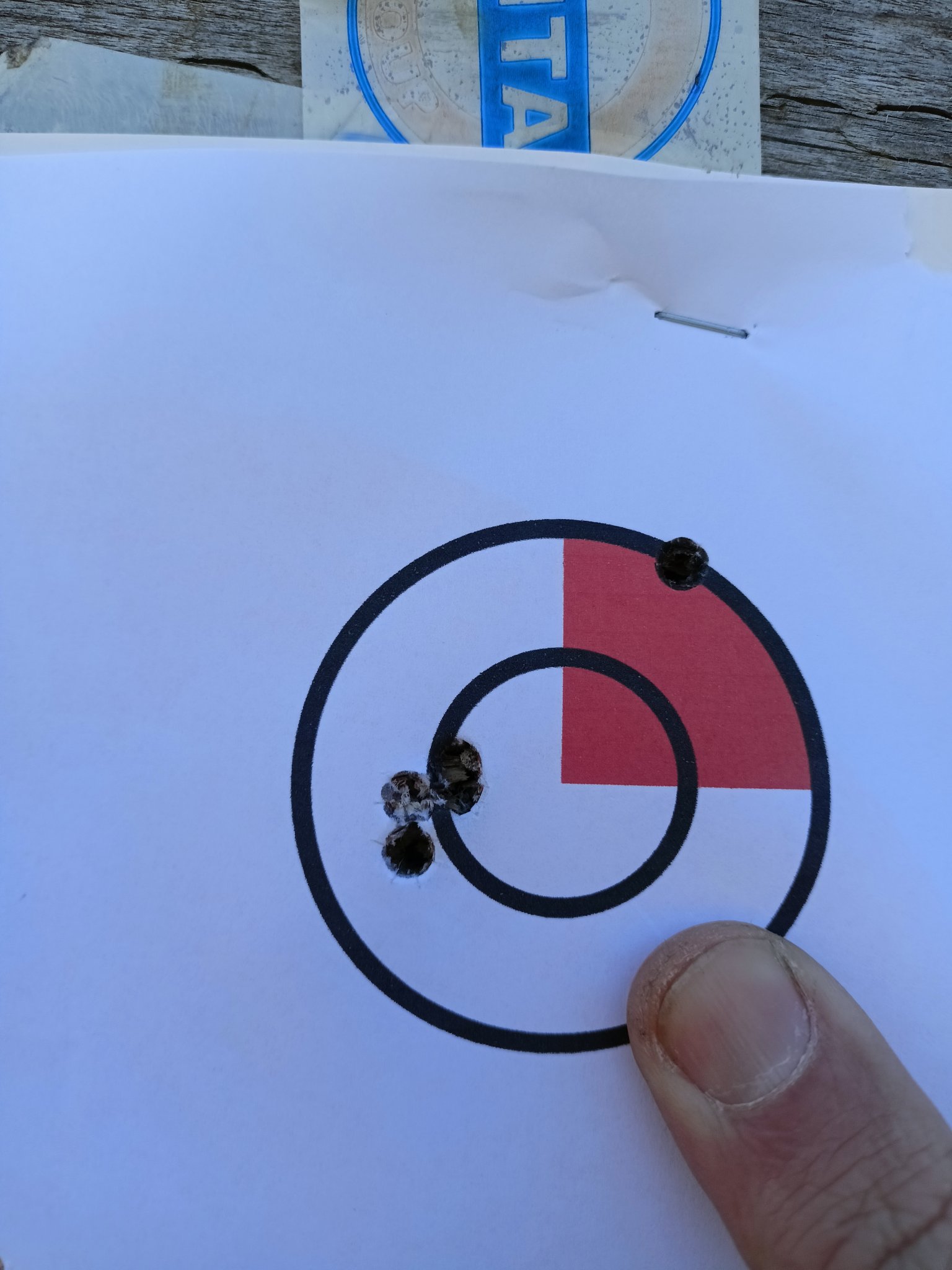

I am at the 500 round mark, so I suppose we agree it's breaked in, and I'd like to share the results:
(Always prone at 100m, with 10x, bipod and rear bag... and me a mediocre shooter)
last training, first group after a zero check (which wasn't this pretty).
10 shot group (consistent with my average performance)
