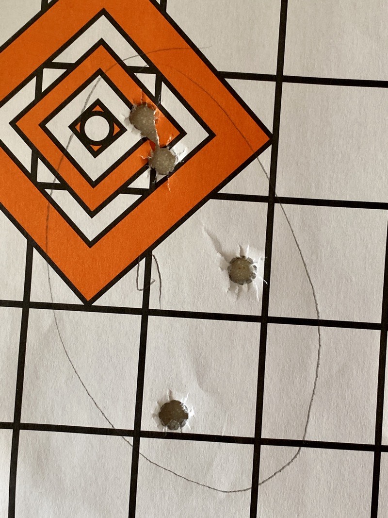

Groups are averaging in the 4-5" range (I didn't grab my targets). Most of today's were blobs, yesterday's were blobs weighted 180 degrees from the silencer baffle clips. However, the group I shot without a can today was oriented in the same manner, but more of a string than blob.

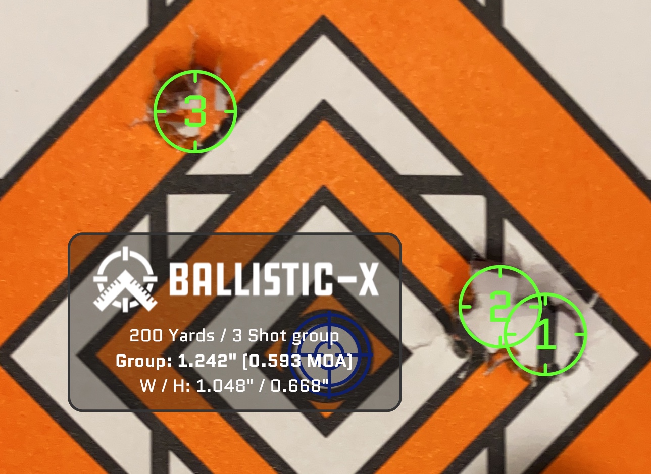

Just came back from the range and I've reached the unequivocal conclusion that I suck. Shot off of the club's rest as well as bags and am certain the gun's sub MOA capable, but my issues with getting and keeping a consistent cheek weld ensures I'm not. The group below is a perfect example. First two rounds go right where I want them. I come off the gun to adjust the bags, coming back in what I'm sure is the exact same spot, but the hit next to the 4 (string designation, not shot) says otherwise. The last round, I'm all scrunched up, praying I'm in the right spot, then place it on what may as well be another target.
I've posted a thread in the marksmanship sub forum, asking for assistance. In the meantime, the Bergara will get thrown in the safe, while I go back to basics on my newly rebarreled 18" AR.
Thanks to everyone for their input. Sorry the culprit wound up being lame trigger puller.
You should listen to Frank's most recent podcast about the extent to which getting on the gun influences POI.
It could be that you're a terrible shot. I won't rule it out if you are sure that's the cause.
That said, the degree to which you'd need to mishandle the gun and the trigger to produce two inches of error at 100 yards is pretty significant. I've seen it... hell, I've seen that much POI variance at 25 meters from shooters that are especially challenged.
I feel compelled to add - the first time I ever got a sub-MOA bolt gun, I could regularly produce 5 shot groups of less than an inch using only what the Army taught me shoot the M-16/M-4 FOW. That's a kind way of saying I was (and still am) shit as a shooter/trigger puller. As I got better, I started shooting 1/2 MOA groups. My personal journey took me from being about a 1 MOA shooter to being a bit better and sometimes bumping the limitations of the rifle. You can go over to the KRG SOTIC thread if you want to read/see my rather boring/mundane journey.
Get your rifle into the hands of someone that knows how to shoot - if it really is you, it will be readily apparent.
If this is your first, or you otherwise lack experience- it's prudent to consider shooter error as you've done.

While I still have an aircraft hanger sized room for improvement, I'm pretty damned pleased with how much tighter my groups are. Four or five round groups would have been a better representation, but I have a finite amount of ammo and no job to fund another batch for $3million. My last string was a four rounder and the worst I shot today (eyes were going wonkey); it was .9 MOA at 200 yds.
All groups were shot from prone, using a bipod, and my sketchy (according to some) Form 1 suppressor.
Reactions: DJL2 and RFutch
Improvement is always gratifying. Now I don't have to send you photos of the crappy group I shot this weekend next to a less crappy group to highlight the influence of technique. The crappy group was totally on purpose... totally. ;-)
