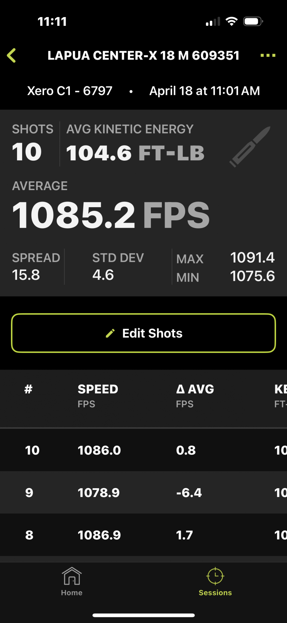

If you notice any difference in noise it would most likely be from breaking the sound barrier from the shorter barrel. While I don't have a 16.5" I shoot both a 20"and an 18" with a Sparrow and a Mask. While the Mask is quieter to the ear than the Sparrow there doesn't seem to be any difference in what my ear hears between the two rifles. Velocity of the 18" is usually faster, but only by a few FPS. Here are two examples of some Lapua Center-X shot out of both rifles with the same suppressor (Mask) and same lot number Lapua. I'm going to guess that most powder is burned by about 11-12 inches in the barrel so I would think a shorter barrel would increase the FPS also. Both rifles are B14Rs, one in the HMR stock and the 20" is the Bergara 20" barreled action from A and J.
First the 18"
Now the 20"
