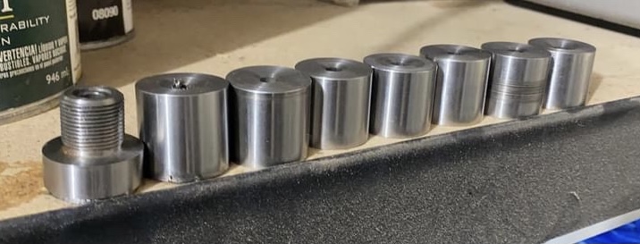

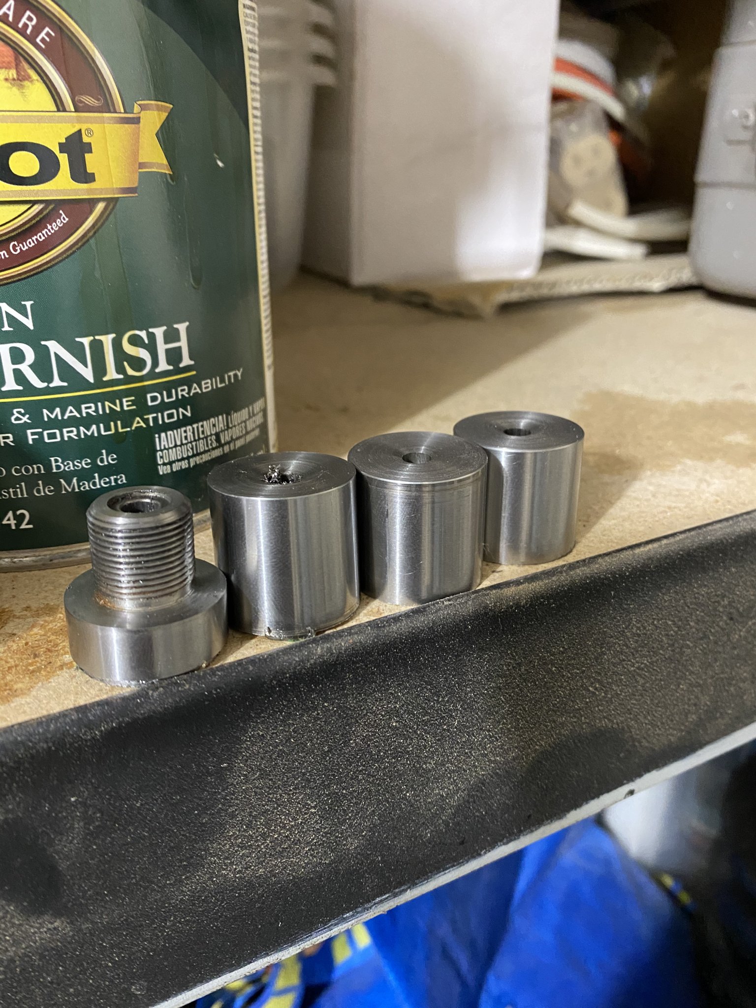

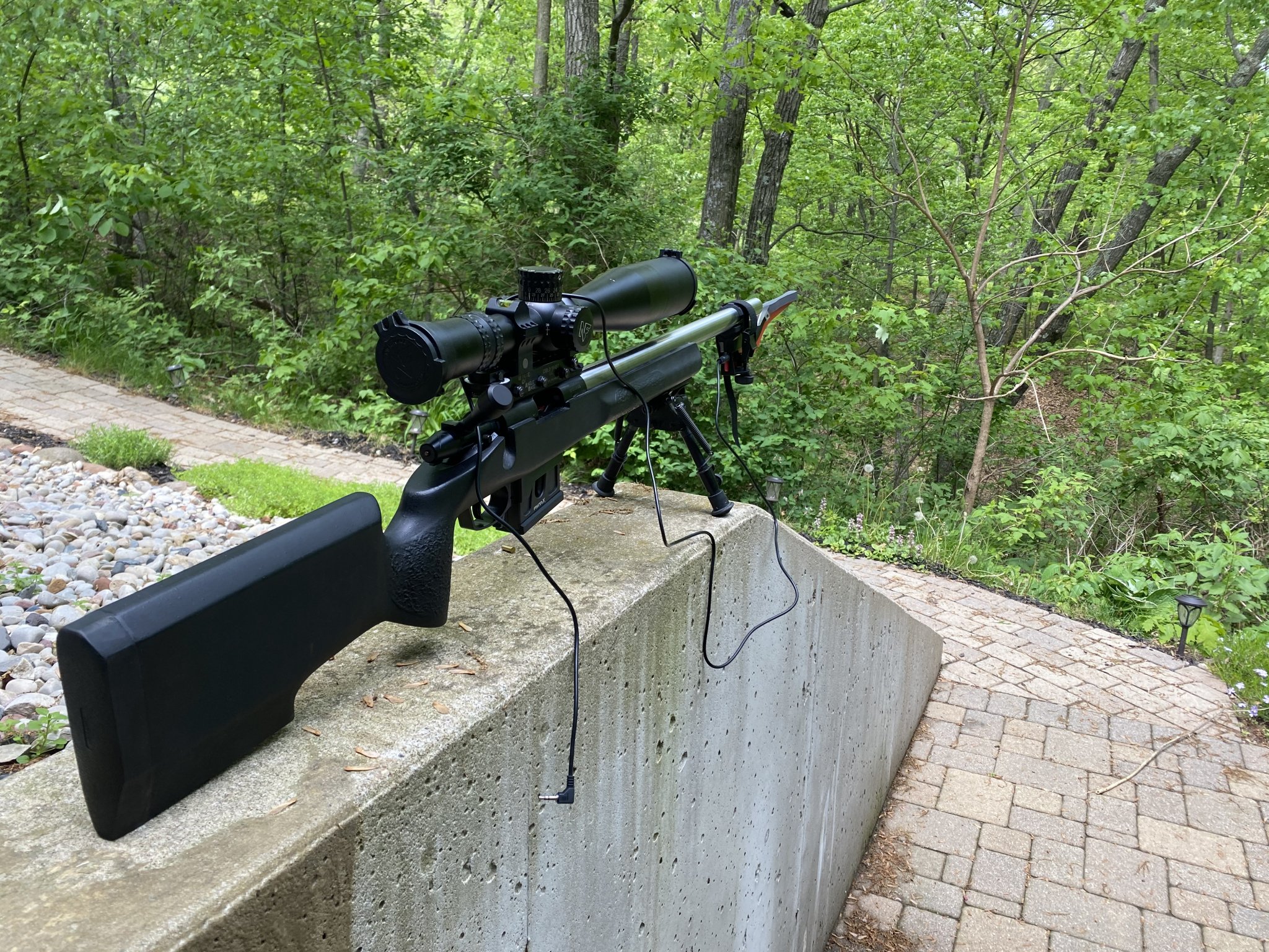

First inch removed. My already damaged magnetospeed stopped working so I had to wait for a friend to bring a replacement.
second inch gone. Have to run to the shop because I don’t have a bandsaw here. I don’t really care for using a parting tool.

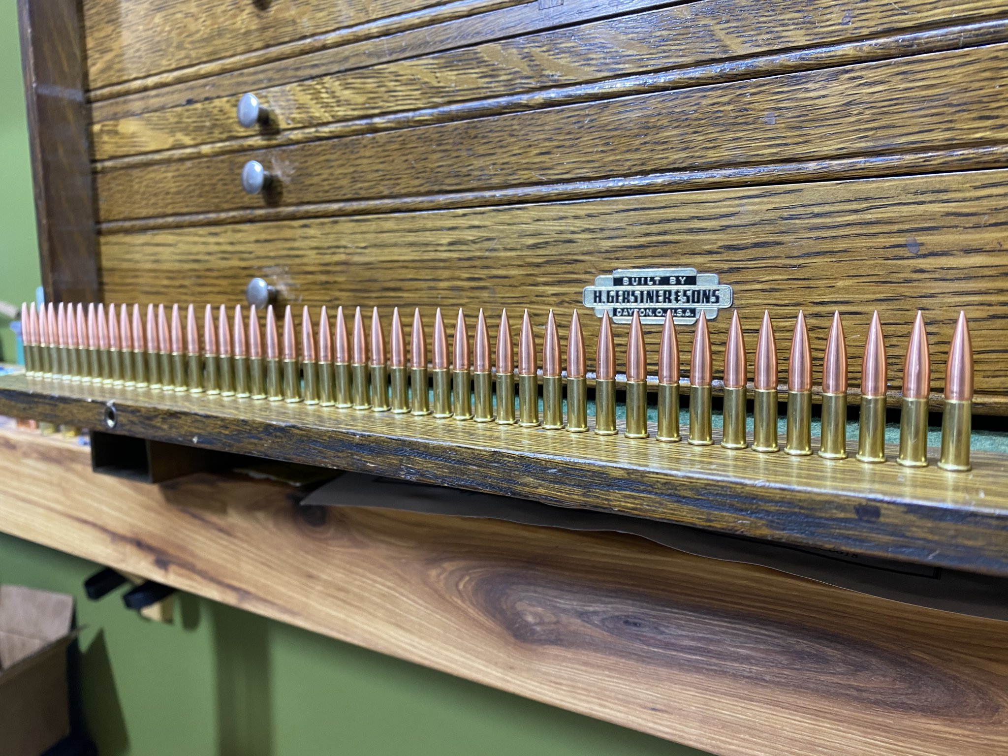

just shot my first 10 solid coppers a cutting edge 133 gr bullet using 41.5 h 4350 I was shocked they were traveling 2852 out of my 26'' Bartlein 1/8 twist barrel compared to the hornady 140gr that with the same load only went 2731 so I should not bet that surprised . I had had problems with the gas ring cutting edge adds to there bullets , but after removing a alignment sleeve on the Frankford arsenal universal dies I was able to use a window to see exactly when to stop pressing and they worked pretty good not sure over the cost of normal lead ammo but in a pinch its a bullet . I guess it all depends on what is worth to you , while I am mostly happy over how they worked again it boils down to price to me .

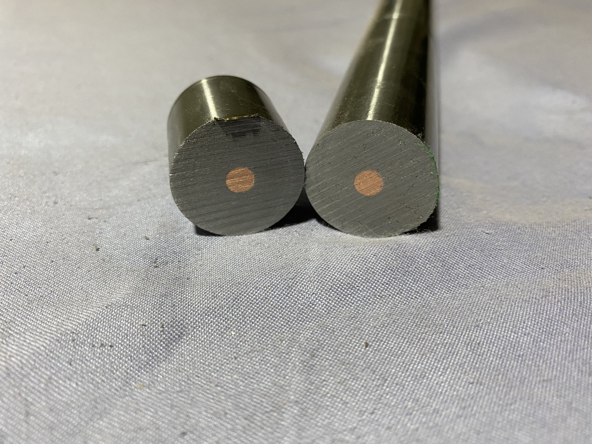

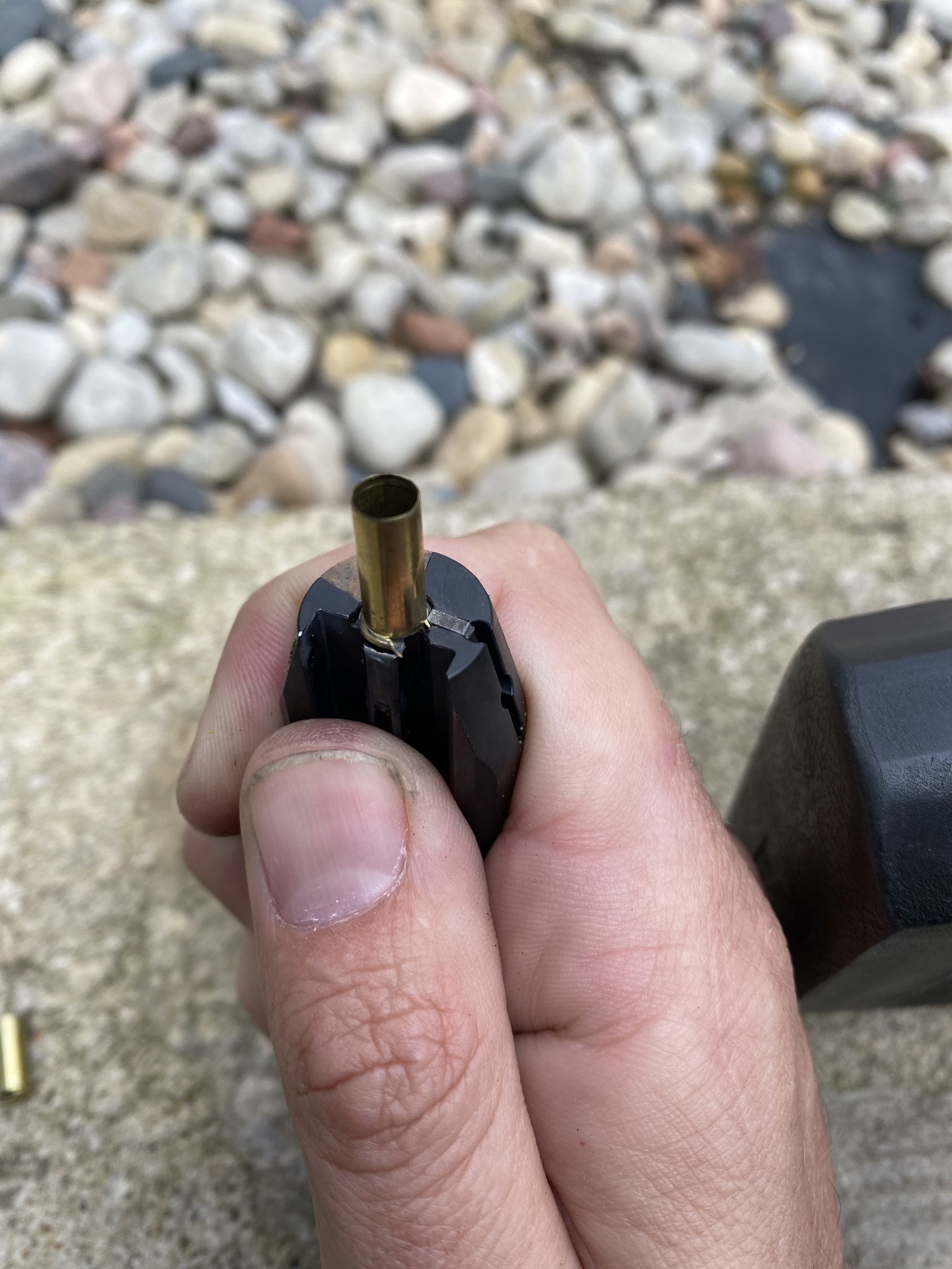

It’s full of cutting oil and filings. It’s pretty clear it’s not a straight cut
Indeed. I'm not taking a position but simply noting that appearances can be deceiving. Some might have expected the end facing up, the previously crowned end, to have appeared without filings or oil.

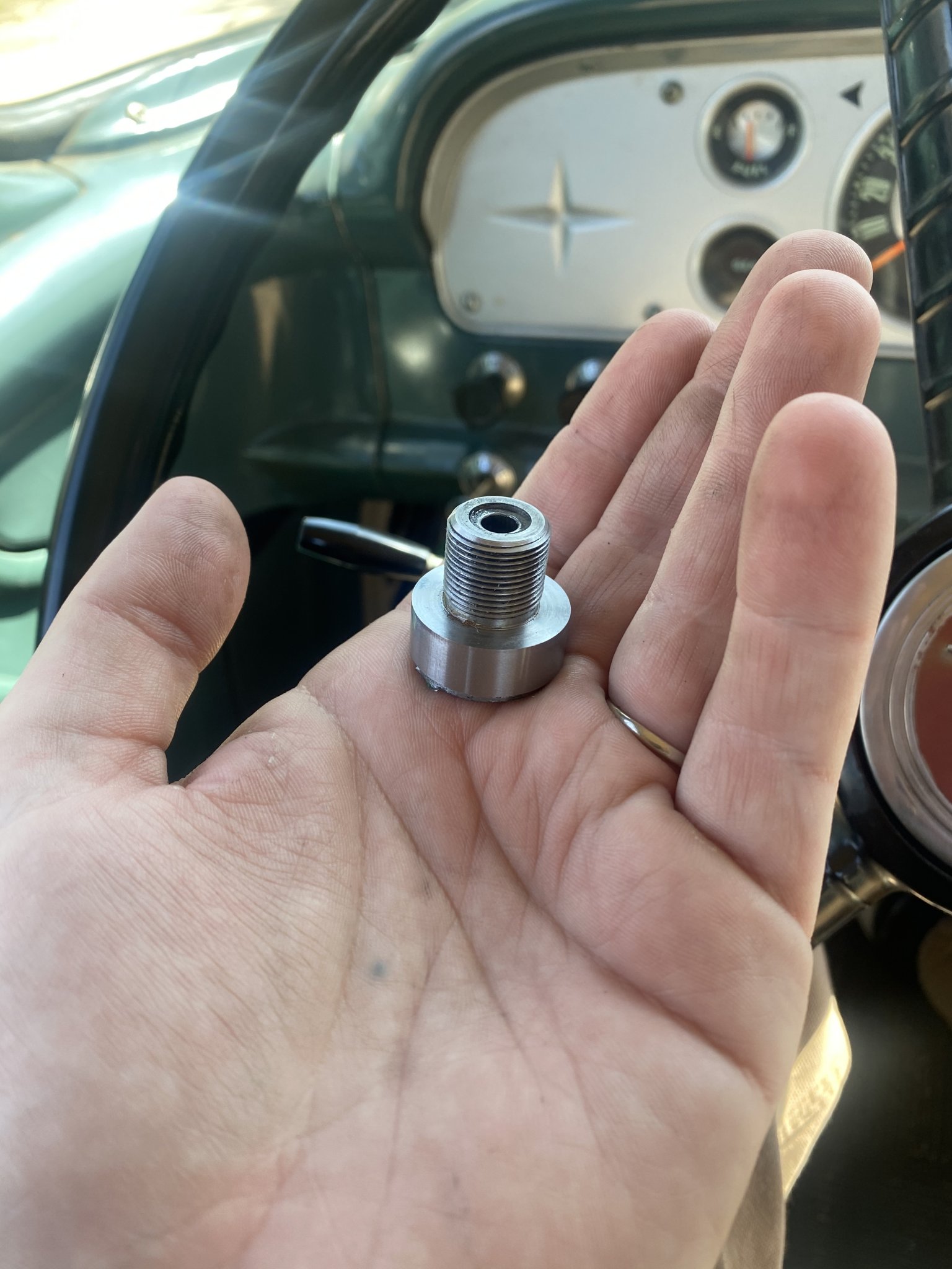

My bullets are already cut to match my barrel. This test is actually being performed on a .219/.222” barrel. Thai was done to decrease engraving pressure to more closely match that of lead in a .217 barrel

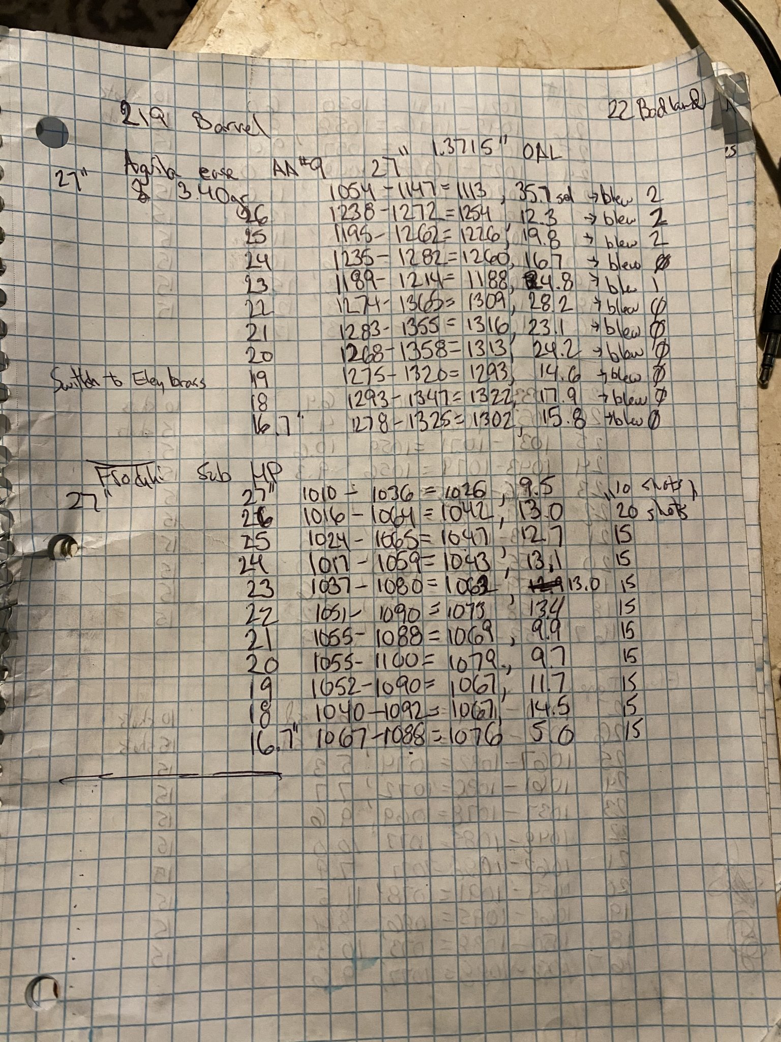

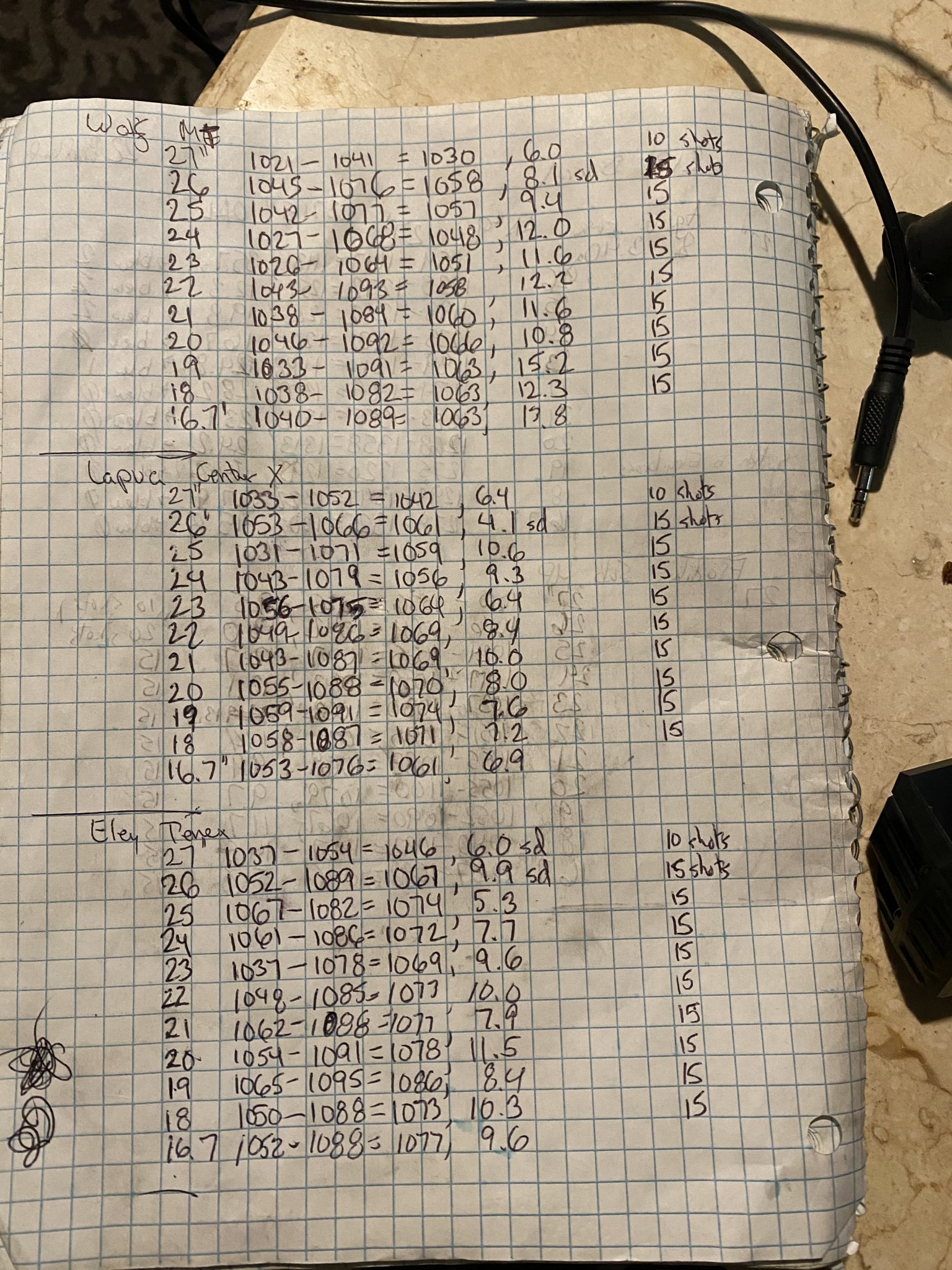

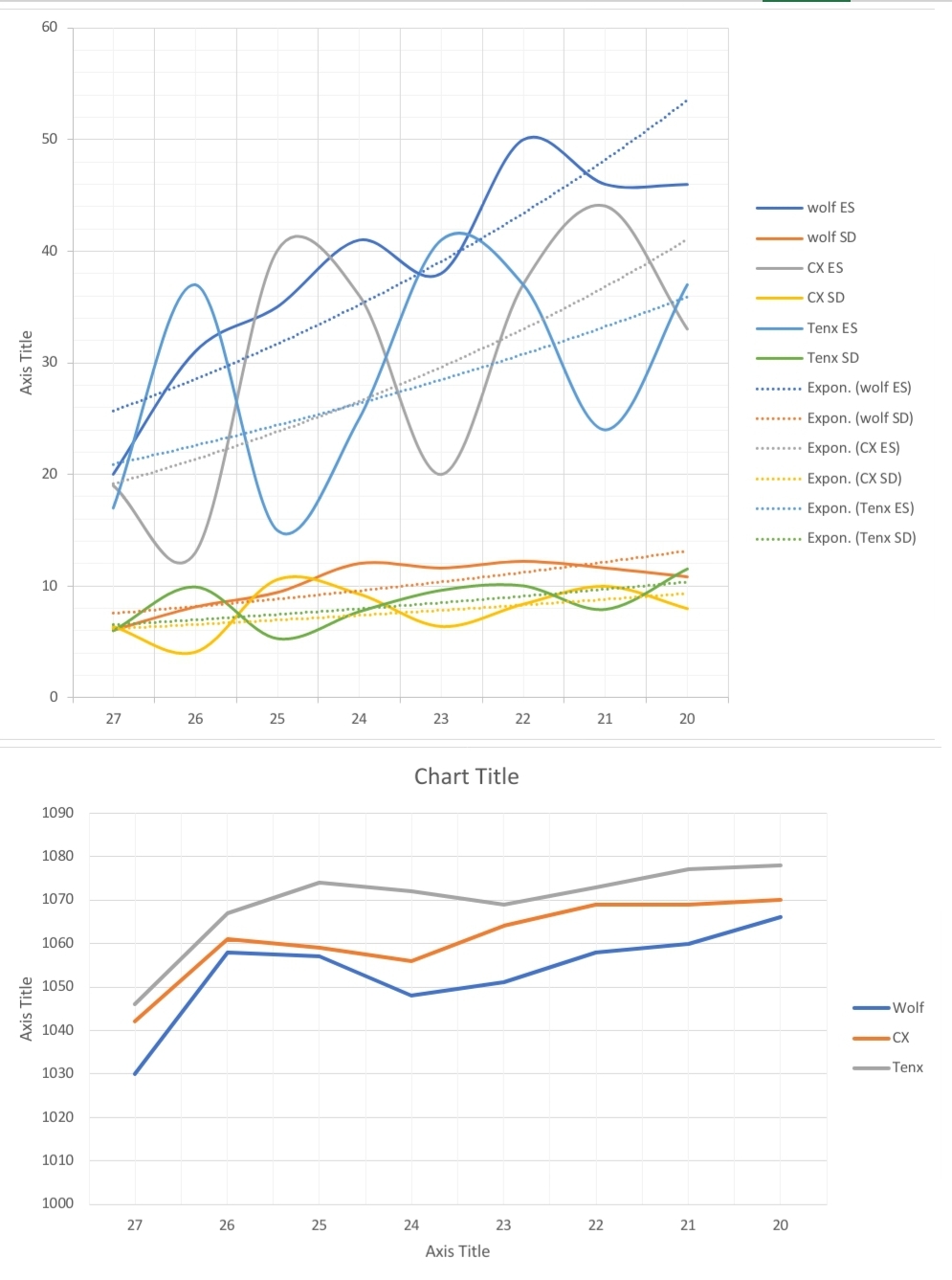

Hers the raw data. The solids ammo wasn’t loaded to any node, simply to just under max pressure. Sadly I didn’t have enough of the Aguila brass to complete the test without switching but is what it is and I could start over lol. The major increase in speed of the solids load as length decreased vs what is seen with the lead ammo is interesting.
If someone want to chart it all, that would be cool. I’ll thread it at this length and continue to run it. I’ll find a spot where speed is stable with my load by working down from here and see where it leads me
