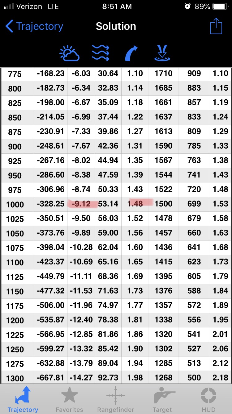

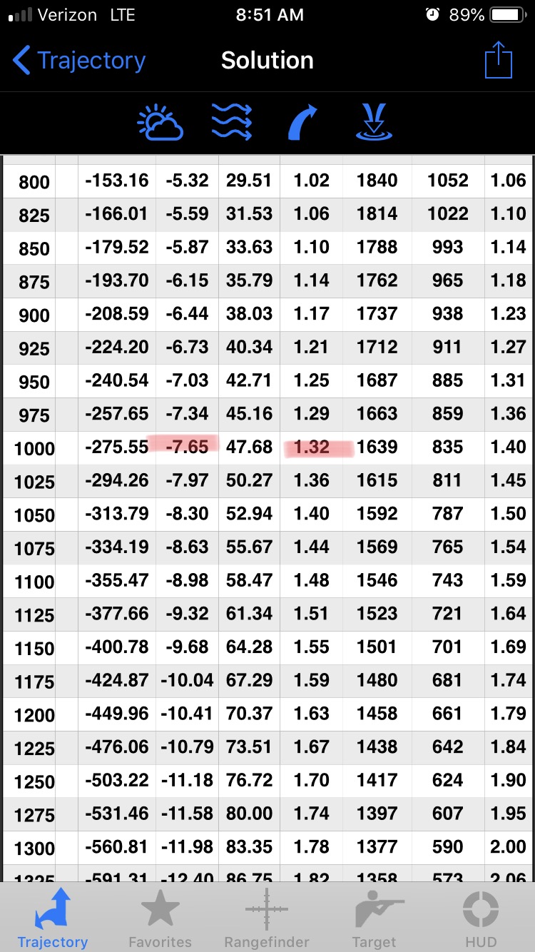

Now, lets take a look at the difference. Keep in mind, this is just plugged into AB from my phone app, not exact, but you will get the point.
Both pics have the 140 ELD, both have a 10 mph, full value 3 o’clock crosswind. The yardage is 1000. The red highlights show the drop and wind in MRAD.
2600fps
2800 fps
Less than 2/10’s of a mill difference. Thats roughly 7 inchs between the two. Sure, the drop data is better, but gravity is constant. Wind is forever changing.
Just something to think about. I say keep it, learn the wind and do some matches.
